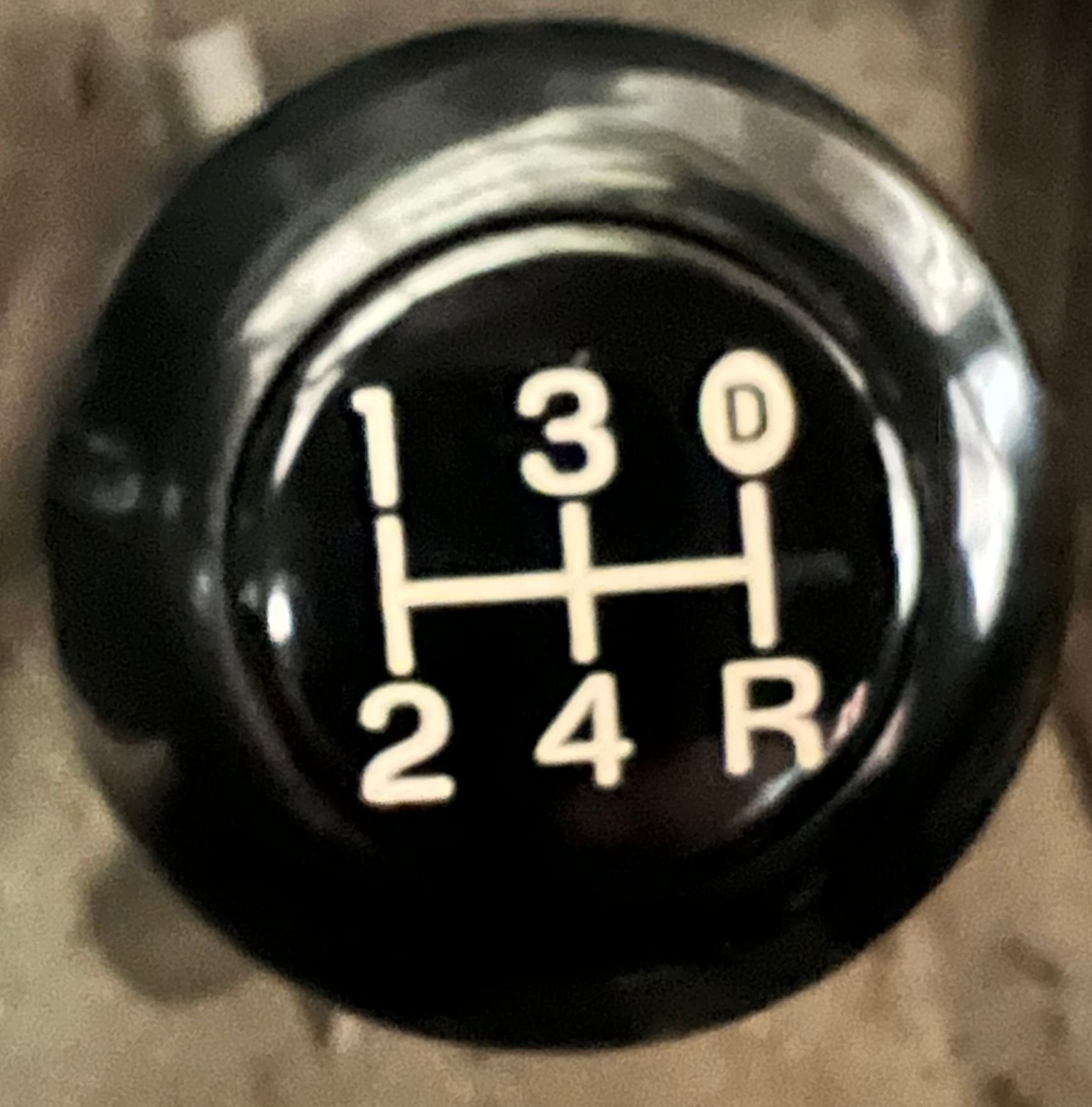

Thank you would this be 5 gears or 4 with overdrive?

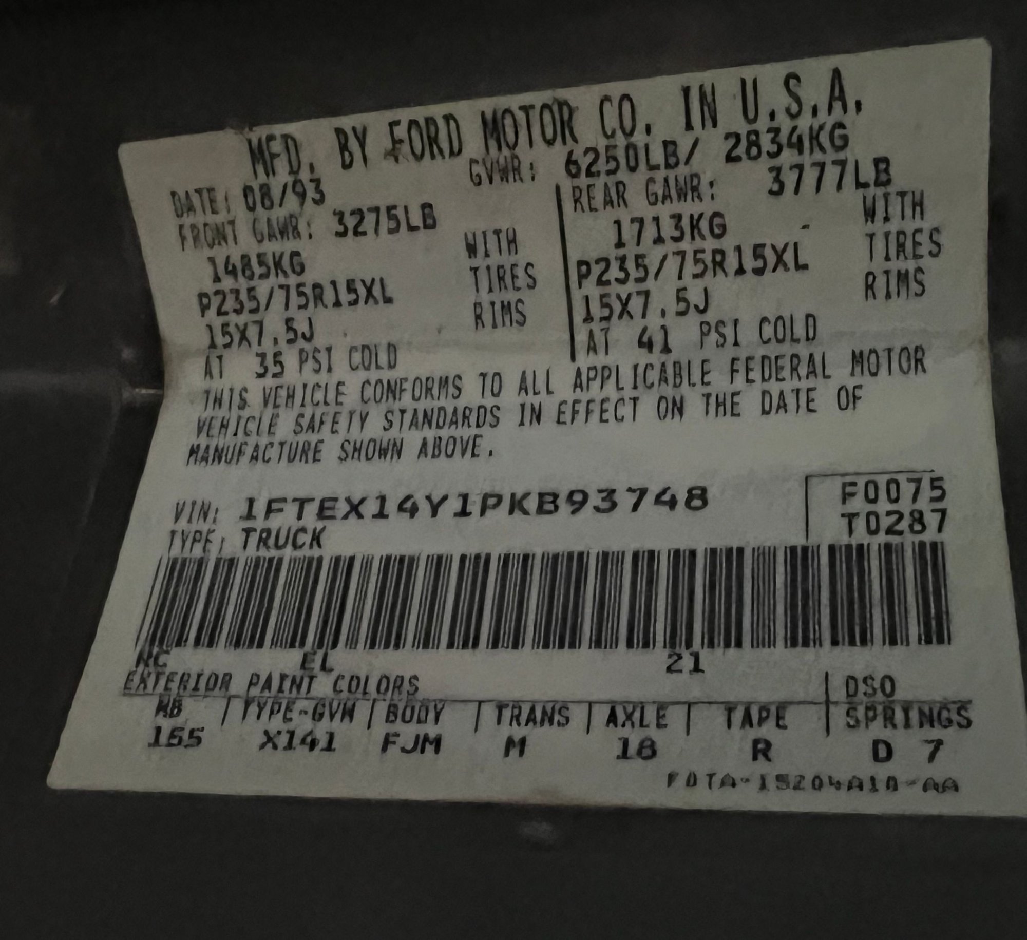

Thanks, this is my sticker, it just says M, for manual I guess.....
Old Feb 1, 2026 | 11:17 AM
90project5.0's Avatar
90project5.0
Joined: Oct 2025
Posts: 1,851
Likes: 402
M is for Mazda M5ODR2 trans.

Fifth is your overdrive gear, which is around 0.80:1
