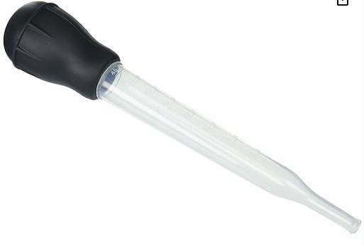

I drained the oil and removed the oil filter cartridge. Should the oil in the housing have drained? It still have oil in the housing. Is there a plug in that as well or do I need to suck that out? Or maybe there is sludge and clogged?
I use a turkey baster to suck out the oil in the cartridge housing.
