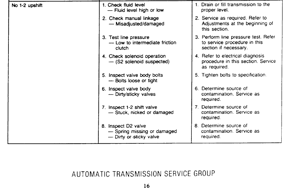

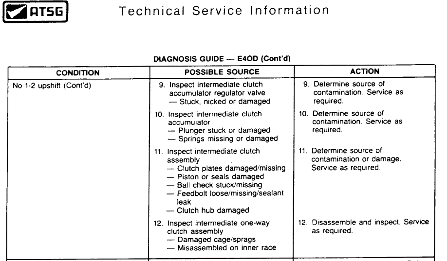

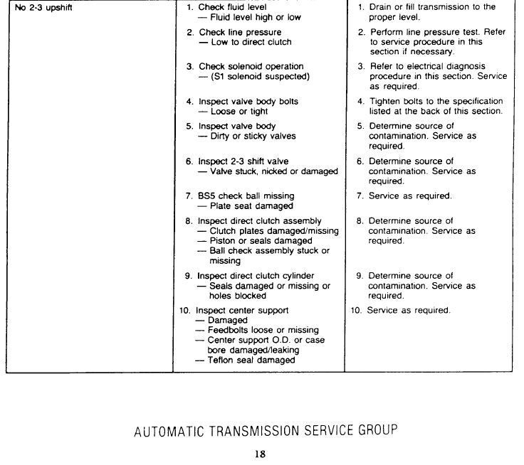

I think you'll come to find, that you probably have an internal trans problem. Have you dropped the pan and just checked for loose valve body bolts?

I don't think it's an internal problem. Not with the false 4x4 switch code and the fact that it works fine in all gears when commanded manually. The E4OD is strictly electronic as far as I know.. has no manual valve body. If there was a problem with the solenoids or valve body it wouldnt shift properly when manually commanded either. Your test are for missing gears or missing shifts. Look up the tests for incorrect or erratic shift. I've been through all that already.
Works perfectly fine in all gears when commanded manually.

Sorry didn’t read the whole thread. Just your last post #34, it is very much a mechanical transmission assisted by electric solenoids.
Did you check the feed bolts? Plus as above the mechanical valve bodies and accumulator valve body.

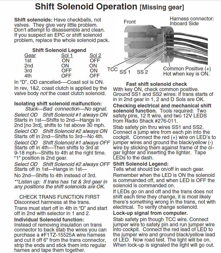

Yes, it has a valve body. And it has an accumulator body.
How are you manually commanding third and fourth gears?

With the OD button.
I don't use this truck much so I've just been driving it manually.
1st with OD off
2nd with OD off
3rd with OD off
Then Press OD button on the highway to get into 4th
I guess now that I've tried it a few more times, it's almost 'hunting' when it's in Drive and I take off from a stop like it doesn't know what gear to be in then it just gives up and goes into 3rd... Could there be a busted spring in the valve body or maybe a stuck valve?
I'm pretty confident now that it's not electrical as I tested everything again..
