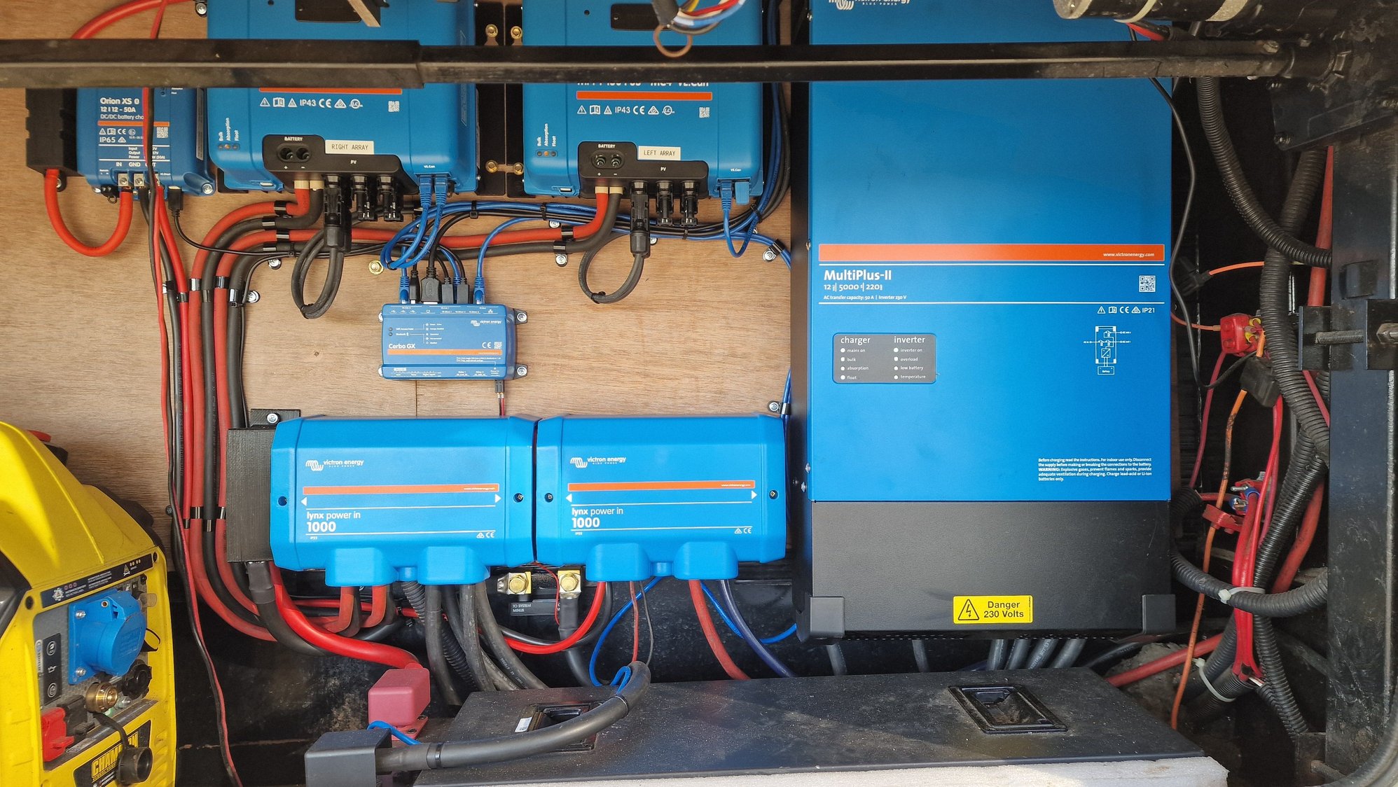

Looks like you could power the city of London with that set up.

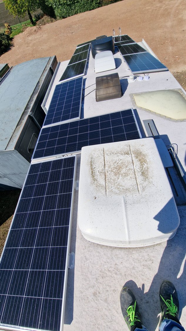

How to you keep the mounts on the roof from leaking water into the trailer?
Most likely by using Dicor sealant. I believe that is the preferred method and what has worked for us for many years. Some use Eternabond tape and Dicor.
Is the correct answer, a bead under the bracket, stainless steel screws through then another bit of self levelling Dicor over the top. The guy who did it for me has been fitting panels on RV's for years & will only do it this way.
