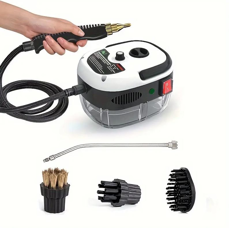

Seems like problem crops up at just the wrong time! I have a little steam cleaner like this if you want to borrow it to help with degreasing. I have used it with plain water, and I have also used it adding some simple green or purple power to the water to give it more grease cutting ability.
Running lean will make the ignition system work harder, so maybe there is a missing vacuum cap somewhere that set the whole thing into motion.
