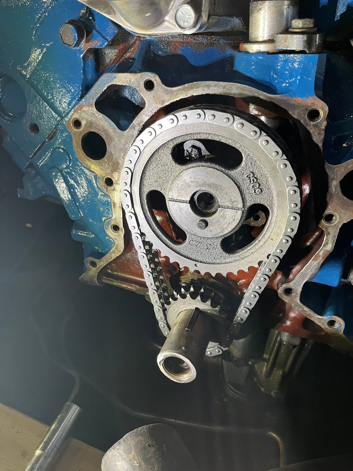

So I got a double roller timing set, and installed it - but the fuel pump eccentric doesn't poke all the way through! Checked the part number, turns out it is for 84-up SBF (during the EFI era when no mechanic fuel pump is needed). So I had to remove that and get another one, now I finally have a Cloyes double roller with fuel pump eccentric on the front.

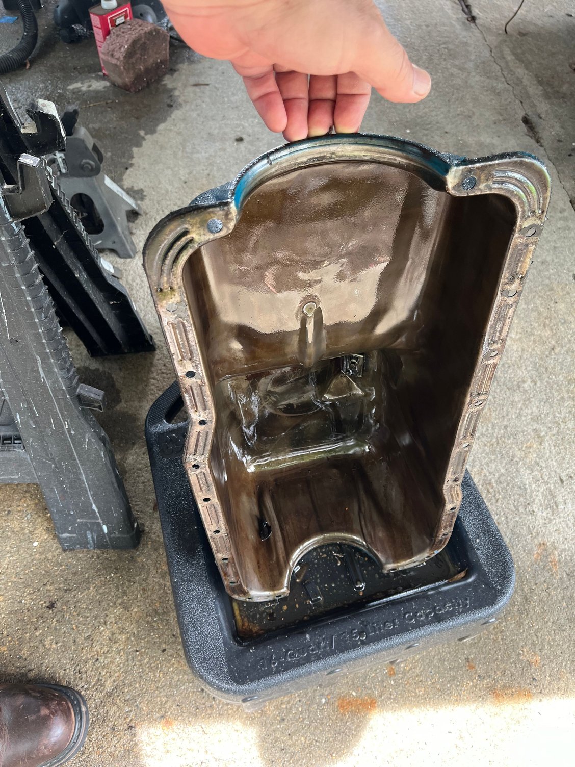

So my Mustang work keeps ballooning into a bigger and bigger job. Now I've got the oil pan dropped, and to drop it I had to remove the cross brace underneath, and I had to drop the steering center link. To do that, I disconnected the idler arm, but when I pulled it down half of the rubber bushed stayed on the thing, so I had to order a new one of those. Every time I touch something, it's fiddy bucks!
I noticed 3 ball bears that came out of the oil pan but 2 made it into the drain hole before I could catch them.
I could not think of anything inside the engine that would have ball bearings, but then I remembered what happened and where they came from. about 20 years ago, When my Export Brace was new (this pic is from 2011, it was already 10 years old or more at that time) I had a hell of a time fitting it in. The opening was too narrow, they say over the years the shock towers start to lean inwards. The instructions said to jack the car up and let it sit for a few hours to "relax" but even after sitting all weekend, it still was about 1/2 inch off. So I got a scissor jack out of one of my cars, set it in there sideways (just like in this pic, the intake was off at the time) and jury-rigged a way to use the scissor jack to spread the shock towers apart. It worked and I got the export brace installed, but when I went to remove the scissor jack several ball bearers came out of it and went into the lifter valley. I hoped at the time that I managed to catch & remove them all, but obviously I didn't!

I was going crazy on where they could have come from
I was thinking if the fuel pump ever came apart big time maybe the ***** came from it, check valves like Holley carbs use for think power valve.
They also have a weight sometimes on the accel pump side.
Good thing they did not make it though the oil pick up screen as it could have gotten ugly jamming the oil pump.
You found the #1 reason to cover any opening on a motor. Be it a carb stuff rags in the intake or like your motor a towel over the whole top.

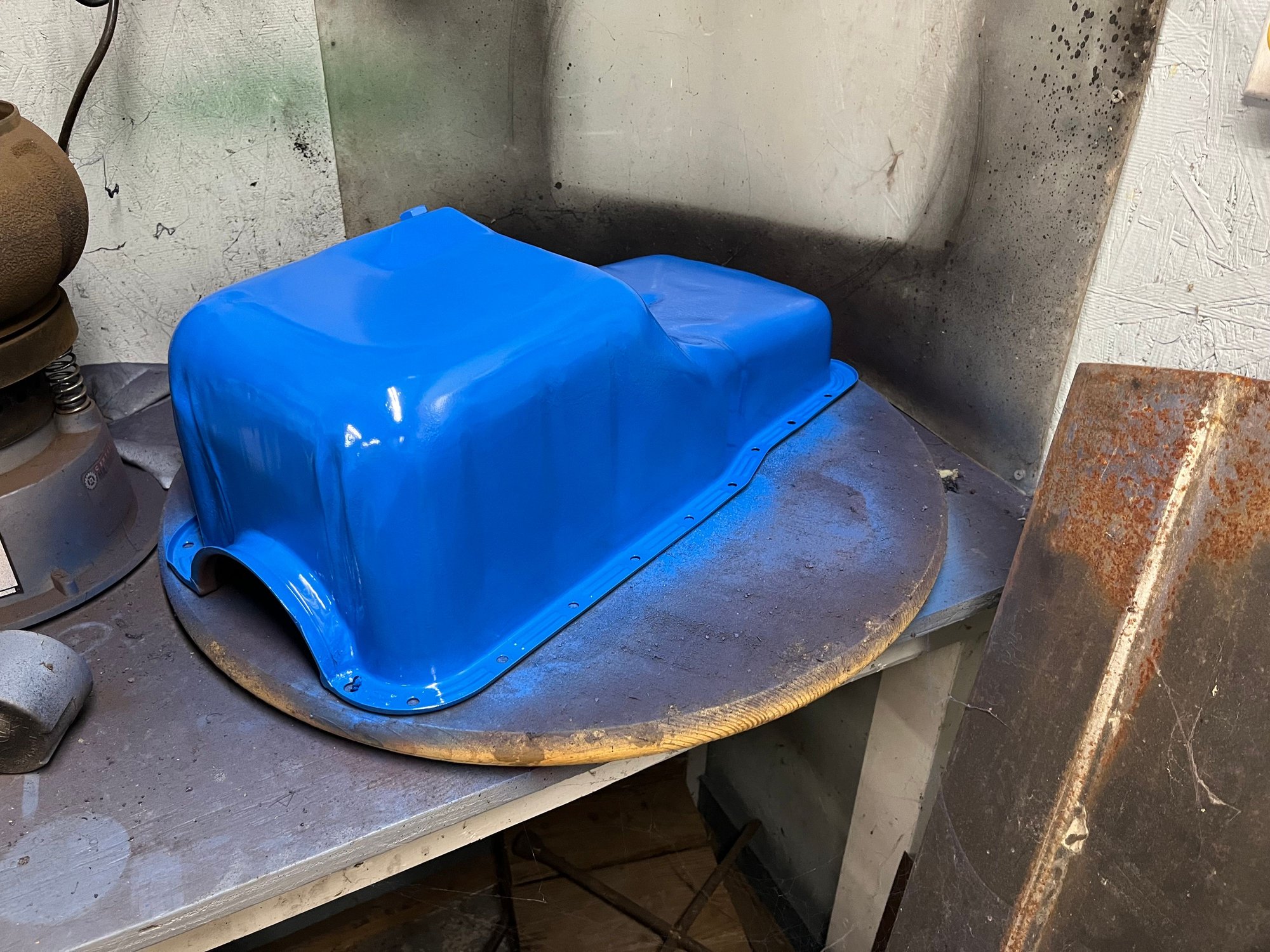

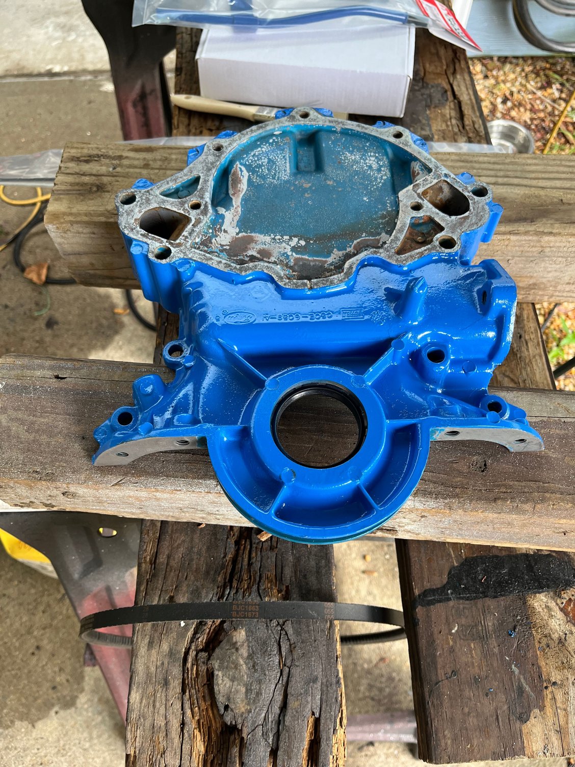

Since I have nothing else to do, I'll post up pics of some old parts I prettied up. On the fan and pan, I hit both with oven cleaner and let it eat away most of the paint, then pressure washed them, sanded, and primed & painted. On the timing cover being aluminum I was not comfortable using oven cleaner, so I used a little steam cleaner that I recently purchased, then ran it through the dishwasher, hand sanded after that, masked it all off and painted it.

She is looking pretty

I did not get much done today on the Mustang, as Tom needed me to load up the trailer and bring him out to Builders Discount Center in Goldsboro for some lumber. By the time we got home it was 4pm and I just had a little while to tinker before getting ready to cook some steaks for dinner.
I got a fancy aluminum alternator bracket setup, but when test-installing it to determine placement and see which spacers I would need, I realized this particular bracket is set up to have the alternator up high, which would be the case for some 80's era SBF engines that have a smog pump down low. The fitment chart said "1964-1994" but I don't think there was much to that, as even if I did want it up high the turnbuckle adjusting thingy would interfere with the water pump pulley, unless I was to change the mounting point for that as well (and all the comments from purchasers said things like "nice piece, but I had to modify it to fit" and "too bad this comes with no instructions" lol). In the end I gave up on that and ordered another one, which I verified this time will be a fit for the alternator to sit under the bracket. But it won't be here til Monday.
Now that it's midnight and I'm wide awake I am thinking I might tackle the oil pan install.
