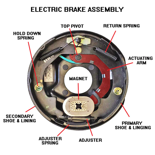

How do you adjust electric brakes, I thought they just "are" and you just control how much power is put to them when the brake light comes on?

All the trailer brakes I have worked on have adjusters just like a auto drum brake set up has.
So you adjust the same way till they just start to drag.
The magnet on the long arm is what moves the shoes out like a wheel cly. dose to slow down.
The arm can only move so far till they dont work like they should.
I know trailer brakes rust where the magnet grabs so it takes some time before they grab good but I dont really feel it on this trailer.

The only real difference is trailer has a magnet & arm that replace the wheel cly and no self adjusting cable like on modern drum brakes.
That is why once in a while you need to adjust them on trailers.

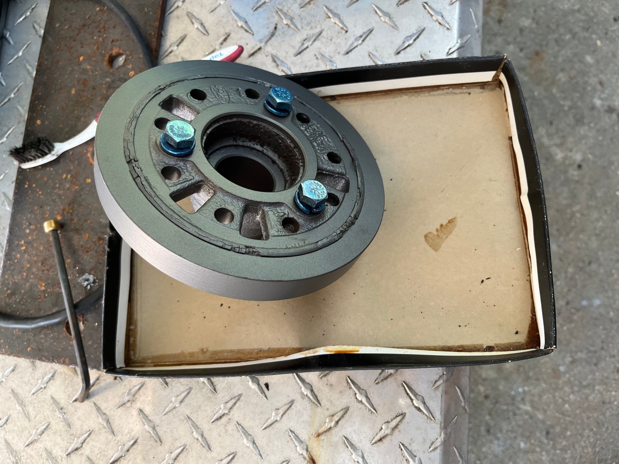

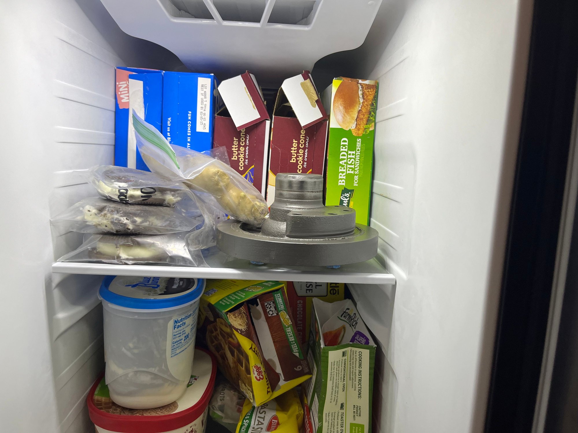

I am part way through doing the harmonic balancer seal replacement on my 66 Mustang. Suffice it to say, it is not the walk in the park I had hoped for. Ford made the early timing covers to where the seal goes in from the inside. What a pain!
I did do the sleeve though, this was a "spare" 289 balancer I had up in the shop attic.
30 years ago, I sandblasted it, painted it, rolled it up in a towel, and stuffed it in a shoebox.
This one has a wear ring which I'm sure my current one also does.
Balancer in the freezer for about 2 hours.
Sleeve in the oven at 400 for about 5 minutes.
Tapped right into place.

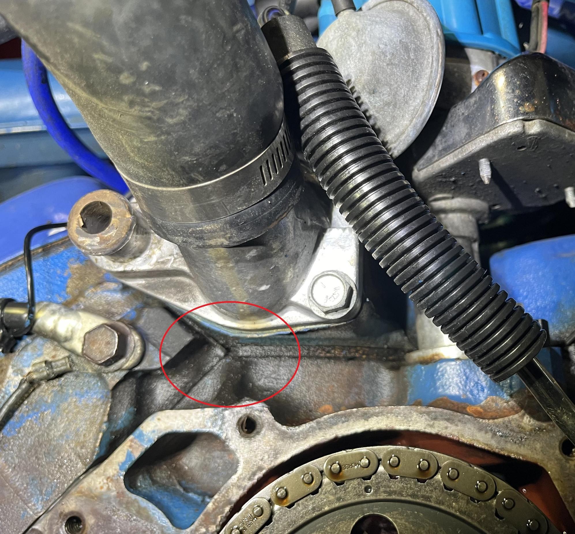

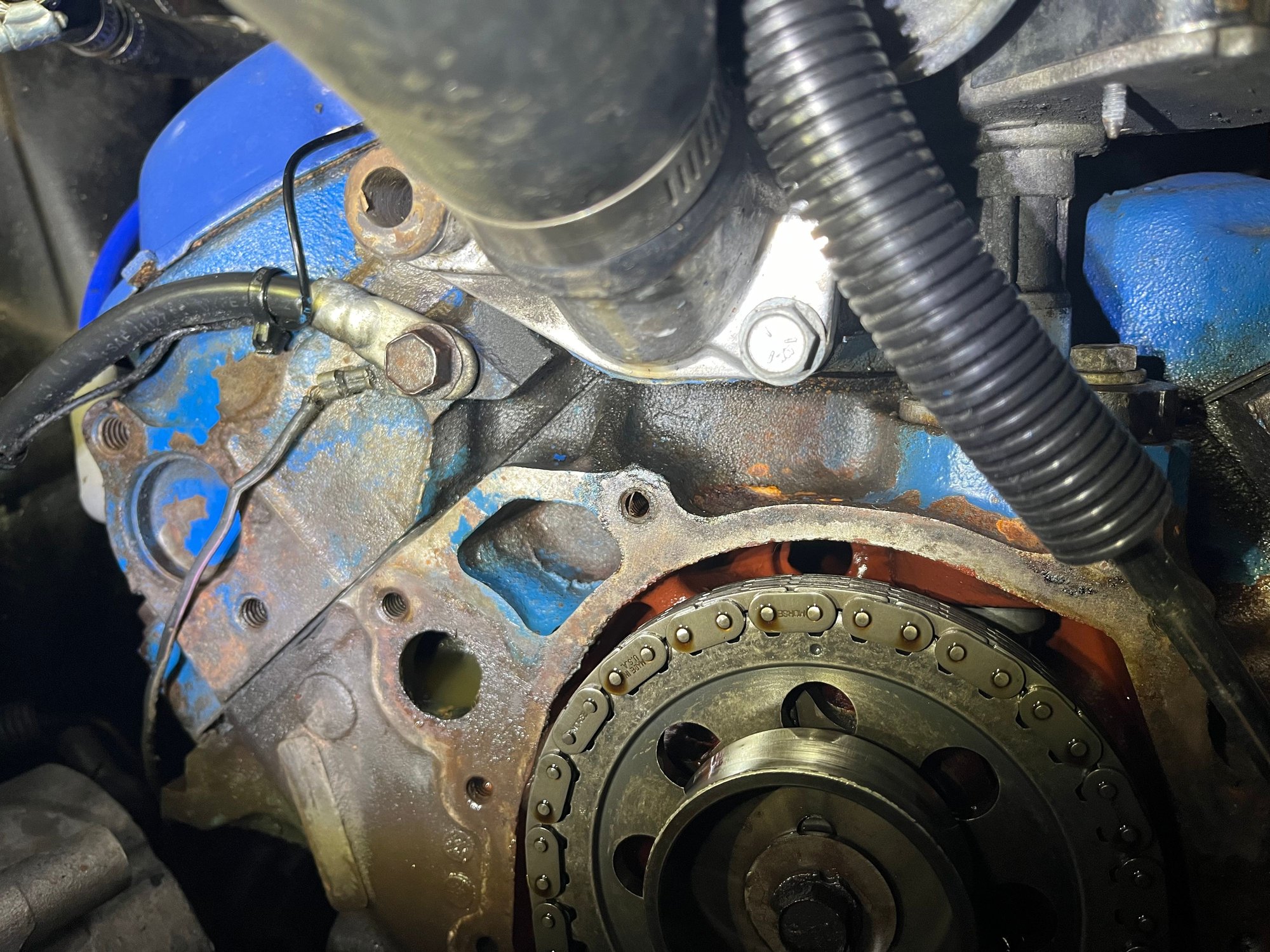

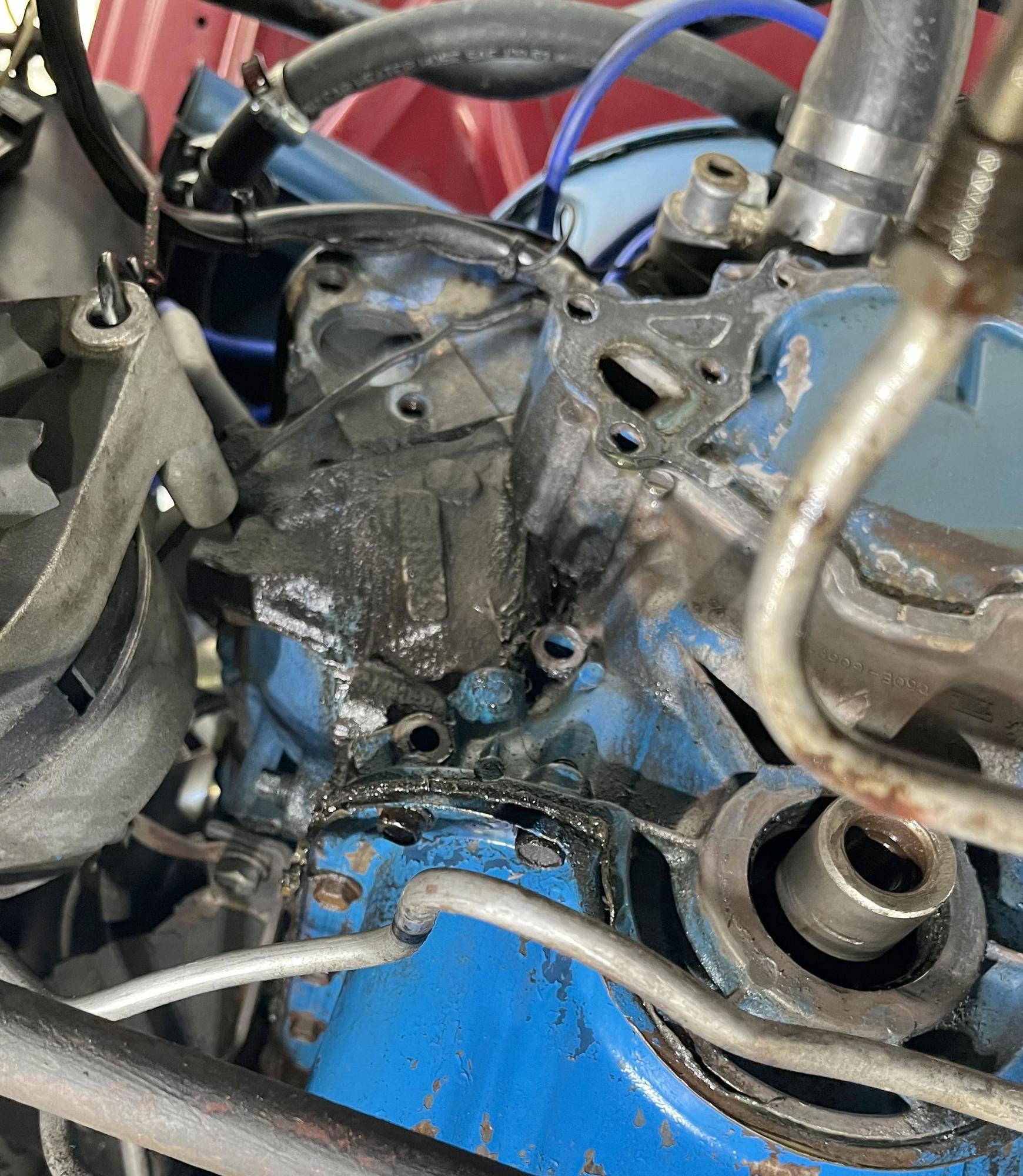

The harmonic job is not going well, everything has to come off in order to get to it. So the water pump, alternator, radiator, etc, just to get the timing cover off. Which I did get the timing cover off, but look at this mess. This nasty area was behind the alterator. Now that I am taking it apart I am wondering, is my harmonic balancer seal even the problem? Maybe it's the intake, leaking out and filling up that annoying "bathtub" in the SBF timing over, leaking down the front and then getting blown around by the air from the fan?
I have ordered a gasket set and other parts which are all due Saturday thru Monday so it will still be a while before it goes back together. Which is fine, gives me time to work slow in the heat and to clean and repaint everything while it's apart. And to ponder whether I should just take the intake off and re-gasket it.

I dont know how bad the leak was but it only looks damp in the pictures and wet?
And it look pretty dry at the crank unless you cleaned it up.
If you do pull the intake dont use the end seal, I see cork there now.
Use the head side gaskets with sealer if it calls for it on them but I would run a thick bead of RTV (black hate the red or blue just dose not look right) on the ends let skim some then drop the intake back on smushing the RTV down. I have had the end seals get pushed out when installing the intake.
I do see where the corner of the oil pan looks wet. Is that from cleaning or from a leak?
The pan gasket also looks like cork.
I hate oil leaks. My 300 had one and after many cleanings found it was coming out the top of the timing cover.
It would only leak when the RPM was above 2000 RPM making it hard to find.
Been a few years now and no leaks, replaced it on new years eve. Great way to start the new year no oil leaks
You got 1 week before the Gimp show in Lucama at the race track as I think that may be a little far for the Silver Stang.
2 weeks to get it together for the clubs food hall cruse on the 11th but the Sliver Stang can make that as it has done it before.

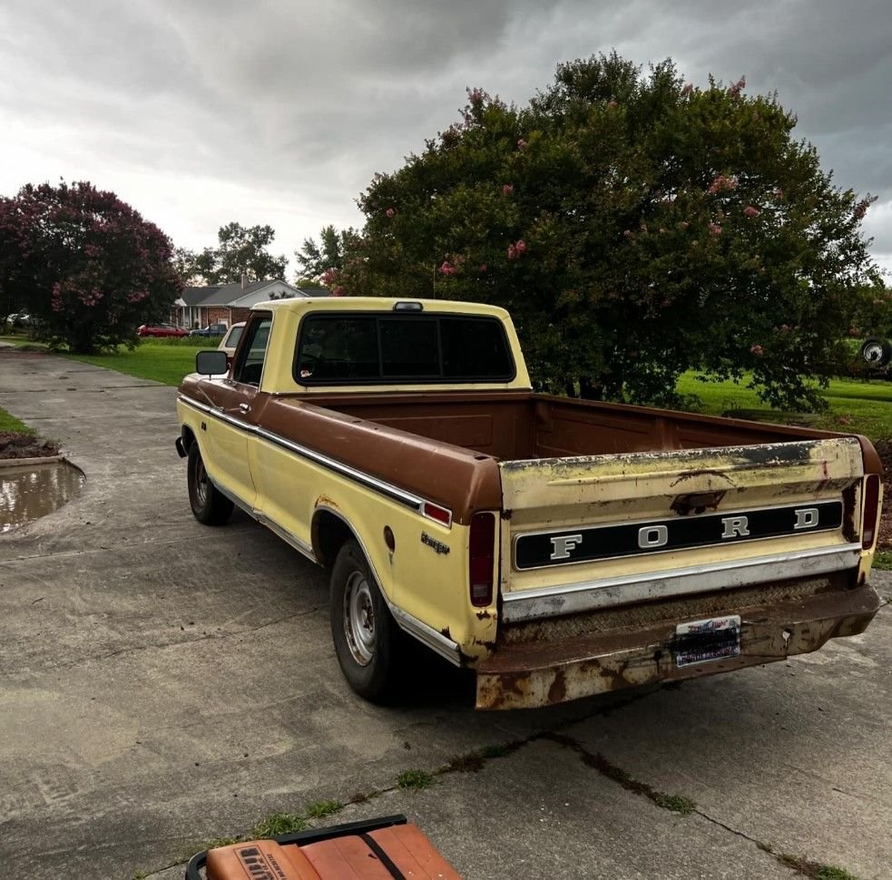

Here are the specs of the truck:
1973 F100
360 FE
Auto (not sure which trans, I havent researched it yet)
2wd.
Long bed.
Current list of plans:
Short-term: (1-3 months)
Tires and wheels
Headers and exhaust
lower the rear (for now)
wash, claybar, buff and polish
steering wheel swap
Identify the leak from the trans (and repair)
Update lighting
Long-term goals:
Intake, 4-barrel carb
Classic AC Install
Lower entire truck (eventually airride)
Replace tailgate with period correct tailgate
repair bed floor
find an old aluminum bed topper
This is the start and eventual plan. Here are some pictures that I shared on the 73-79 forum.

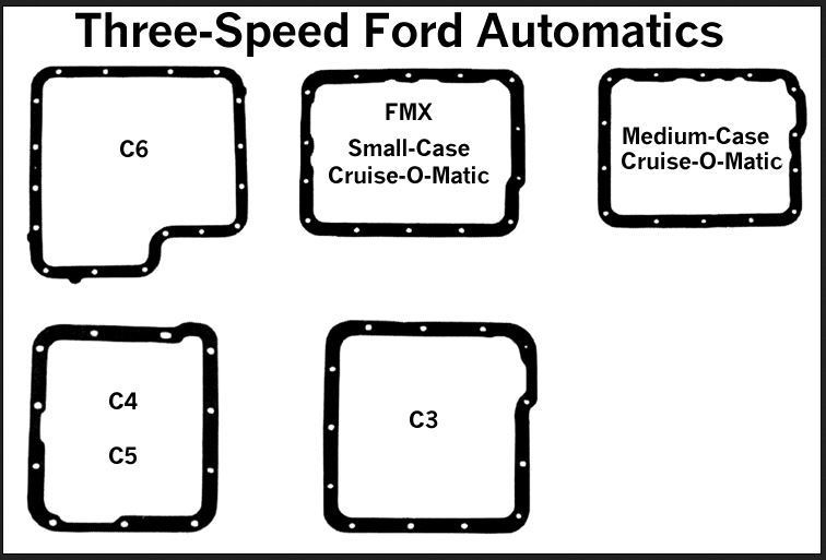

You have ambitious goals for the next 3 months! I would guess the transmission to be a C6, although I guess FMX is also a possibility. If you take a pic of the trans pan from underneath we can help identify it.
