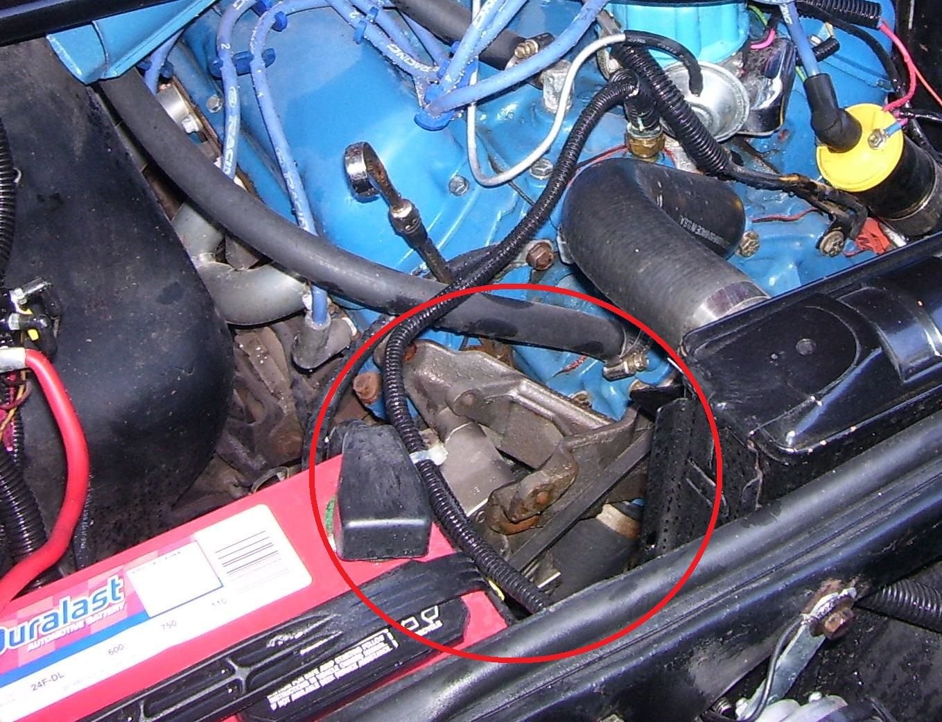

The car was originally a California Emissions car and it had what they called the "thermactor" which is pretty similar to the air injection they used in later years, but my thermactor stuff is long gone however it shares a bracket with the alternator, so I always had this funky alternator bracket with something obviously missing from the top.
Old engine picture so you can see what bracket I am talking about

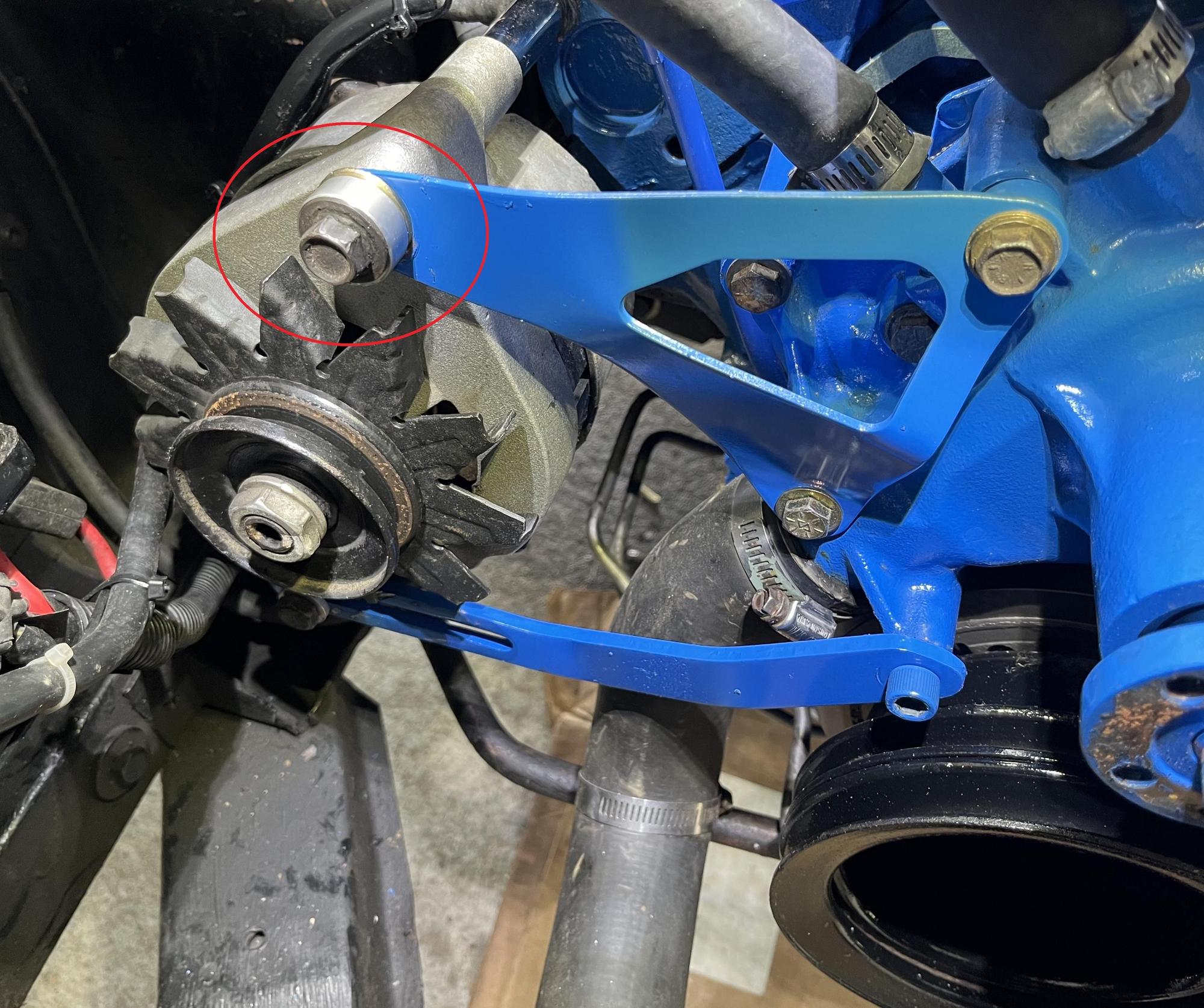

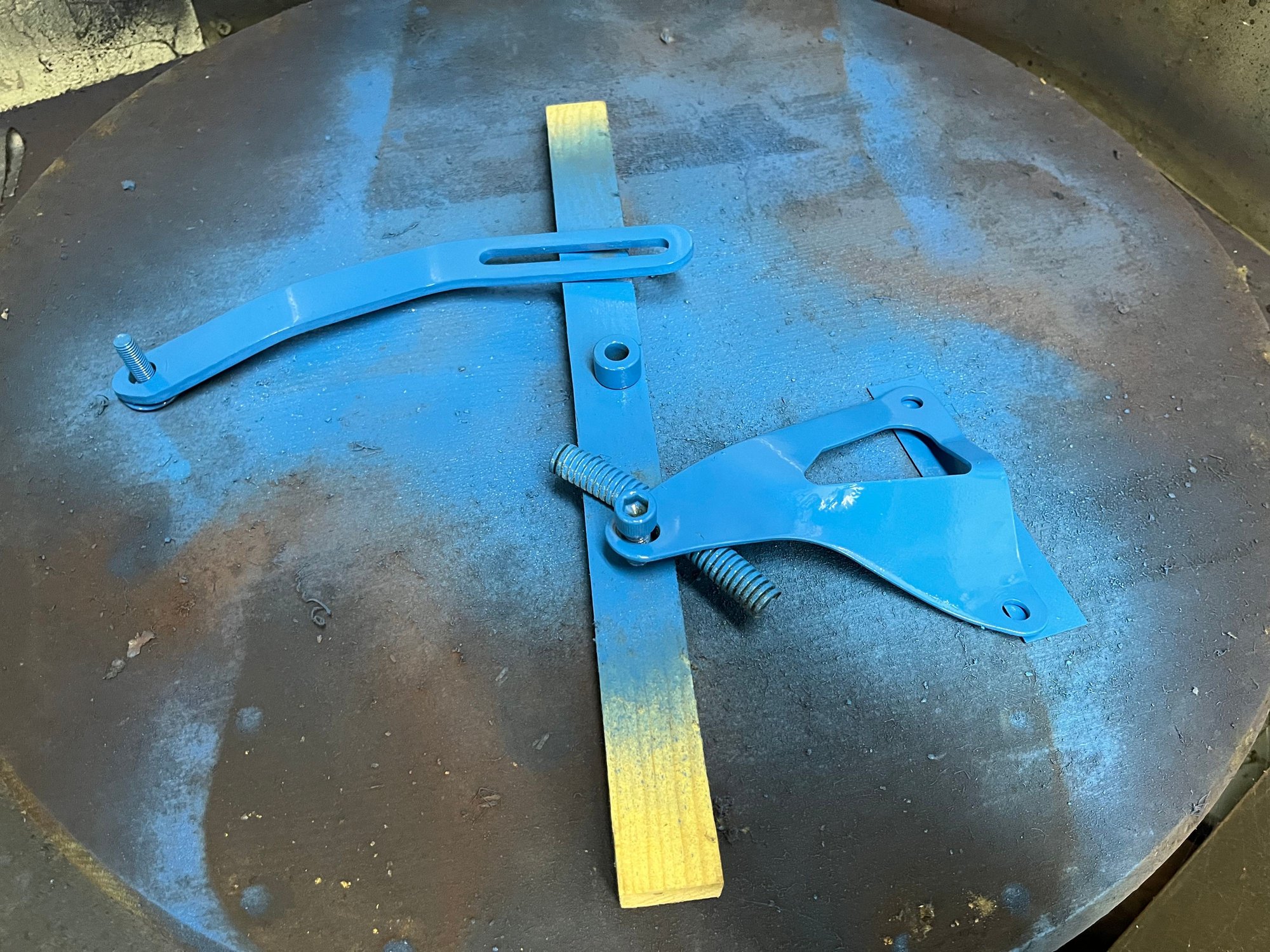

I decided to do away with that for once & for all and get something better, so I ended up buying a billet aluminum setup. I wanted one like this:
But the one I bought didn't have any "as installed" pics, just pics of the individual pieces, and when it came in and I tried to install it, I realized the main bracket is upside down from what I want and would mount the alternator up high. So I bit the bullet and ordered another one, this time paying attention to make sure I was getting a "mid mount" style. But while waiting for it to come in I started to have doubts. My engine (and the car in general) has a "basically stock" look and a billet aluminum piece would just look out of place. It wouldn't fit with the rest of the engine. Now if I had billet pulleys, and chrome valve covers, and a fancy air cleaner, it would look right at home, but mine isn't like that.
So I decided that I would go with a stock style setup and with all the Ford engines I have or have had over the years, I knew I should have no problem digging one up. I went through my box of brackets and all I could find was a chrome one. I have no idea where all the plain ones went to. But the chrome was in bad shape, so I cleaned with a brillo pad, then warm soapy water, then I sanded the rust and pits out, sprayed with adhesion promoter, primer, and then blue paint.
When I went to install it, I realized I don't have the right length bolt to hang it from. Measuring the distance from where the alterator sits to the head where it mounts on the old thermactor bracket, I could see I needed a 1.5" spacer. Measuring everything else out, that meant a 5.5" bolt. I only had a 5 inch and a 6 inch, and that was the only sizes available at the hardware store or the autoparts store. Apparently every other Ford in the known world uses a 6 inch long bolt. I ended up using the 6 with a 1/2 inch spacer in front.
And now posting those pics, I am wishing I had painted the lower adjusting arm bracket black instead of blue!
When I removed the radiator previously and cleaned it, I sprayed it with Purple Power which ended up leaving these white stains. A google search confirmed I was not supposed to do that!
So I tried polishing it out, and the marks were still visible. Next I tried steel wool, and then 1000 grit sandpaper, and polish after that, but the net result now is you can see all those sanding marks.
So, to recap - I wasted $60 on two different alternator brackets that I'm not going to use on this car (I just figured maybe I stick them on the shelf to use on some other 302 down the line) and I still need to get a 5-1/2 bolt so it's not looking jury rigged (I found a place online where I can get a single bolt for 67 cents.... plus $15 shipping, lol).
As of right now I will probably have the car back together later today, but I hope I can figure out a solution to make the radiator pretty again before doing so.

John, on your 5 1/2” bolt. If the threads of the 6” are an inch or so, just run a nut down and cut the 1/2” off. When you remove the nut it cleans up the threads. Cost = $0.00

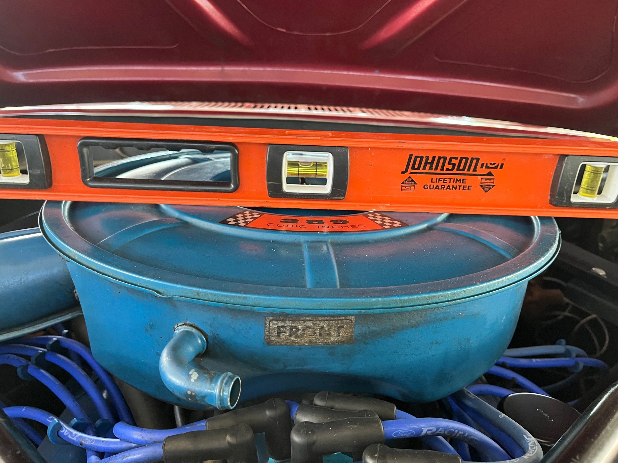

I didn't see your post early enough to take you up on the offer. I put a straight edge across the flat part of the alternator pulley and it lined up about 1/4 in farther out than the water pump pulley, so I removed the spacer so I could trim 1/4 off it. When I did, I realized it was 1-3/4. It was supposed to be 1-1/2. So between measuring and cutting the first time, I must have forgotten how to read a tape measure! Oh well, it is now 1-1/2 as it should have been from the get-go and now it looks like it lines up perfectly.

I went to Andre's to tackle the motor mount job, I thought it would take 1 hour and then I would have time to help Tom move the Fairlane and the big heavy equipment, and maybe call you if we needed help and/or the skates, but Tom and Wayne ended up going to get the 440 motor so not much else got done, and the motor mount job took about 4 hours instead of 1.
Drivers side, I knew it was bad! Came out in 2 pieces.
New one for the drivers side, old drag racers trick - drill a hole through it and put a bolt & luck nut on it, prevent it from ever separating.
Motor has always leaned to the passenger side, the car was in a wreck in the 80's before I bought it and I think things are tweaked a little from that. Last year I loosened the motor mount bolts on passenger side and slid in 1/4 inch spacers to help level it out, and it improved but was not enough. So today with the new motor mount, I put 1/2 inch spacers between mount and engine, and this is the most level it has ever been!
