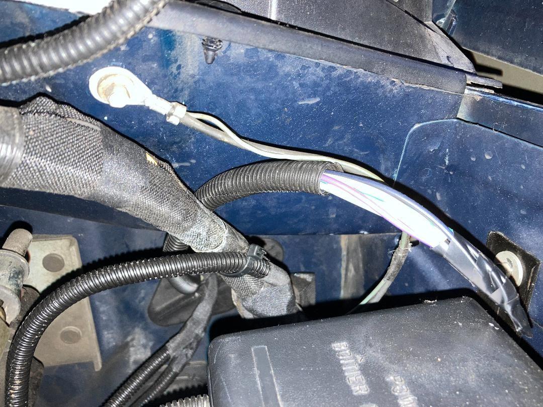

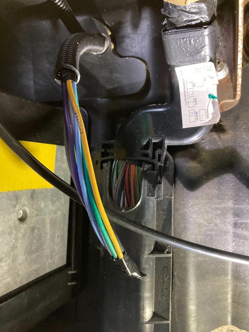

Where and how did everyone route their gauge wires through the firewall?

If you have an automatic truck, you can use the popout/pass through for the manual trucks in the firewall. I have a manual truck, so I created my own path through the firewall.

I used the 4 customer access wires first, then created a bundle of 16AWG wires to use as needed using the knockout Sous mentioned.

Try re-configuring the new bundle of 16 AWG pass-throughs on the engine side of the firewall with a drip loop, so that water wicking down the harness and split convoluted loom cover can drop off the harness at a point lower than the entry hole through the fire wall.
