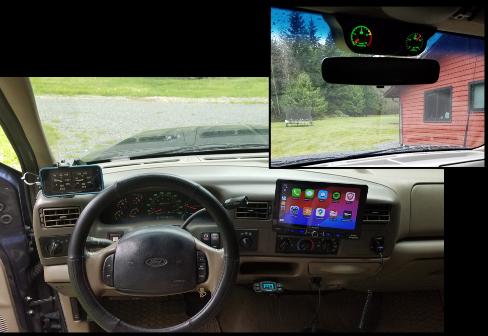

Over the mirror is not a bad spot for gauges - have EGT and Fuel pressure up there. Soon to add a boost gauge between them. These are ISSPRO EV2 Performax. I monitor transmission and engine oil temps on FORScan Lite with my phone when towing, and sometimes expand the window to view ICP, IPR%, MGP and FUELPW to see if they are behaving themselves.

While the provided heavy duty velcro on this Autometer pod holds well to itself, and adheres to the windshield well, as seen below, the adhesive to the plastic has not been secure for me so far. Much of the time, the rearview mirror has been holding the pod in place.
I will be taking it down to install a boost gauge, and see what can be done here. That magnet idea sounds good, but think I might just try to improve the adhesion of what is there. Maybe CA glue will hold the velcro to the plastic better. There's a lot of heat this attachment method has to survive - though not today - plenty of rain.

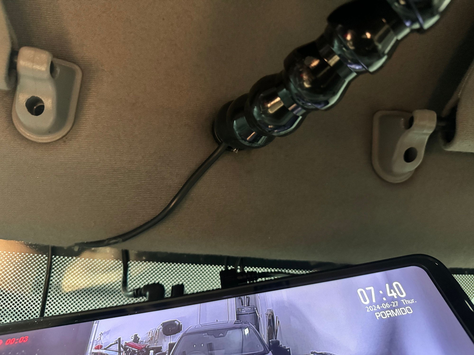

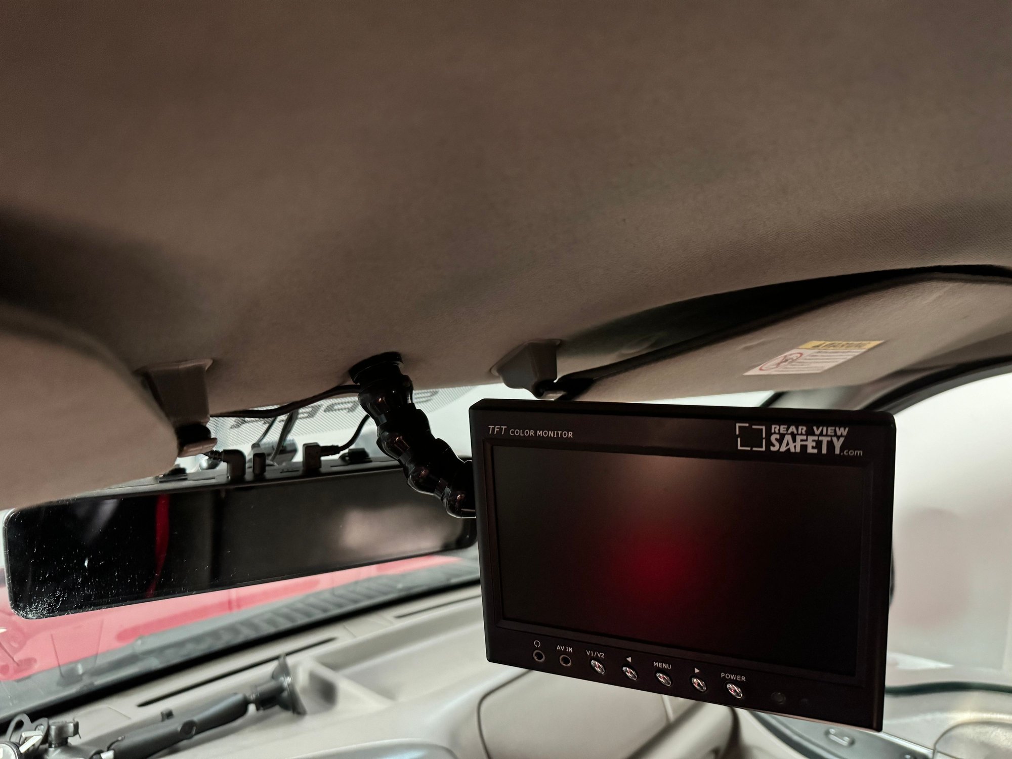

There is sheetmetal in the ceiling of the cab in that area of the cab that you can drive a screw into without piercing the roof. I will take a picture of the mount for my rear view camera's display later.
EDIT: The base of that black plastic arm in the pictures below is screwed into sheemetal.
