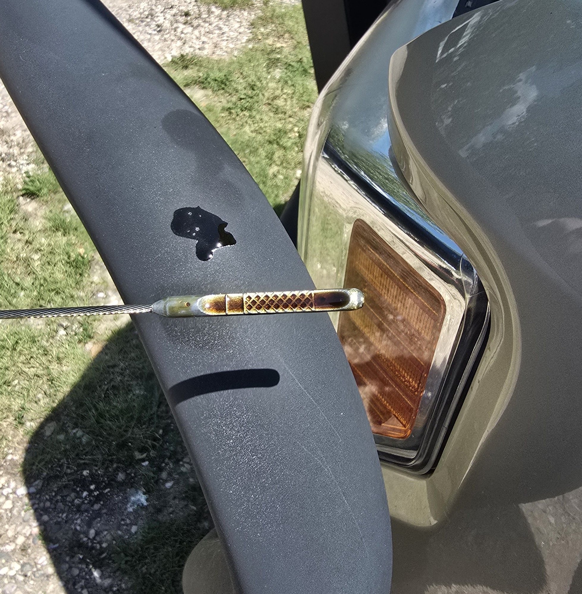

Just changed my oil at ~11k, below is a pic before the change. No heavy towing this round just a few hundred miles hauling my flat bed trailer so around 7-8k lbs for a few hundred miles, the rest was commuting doing 430 miles at a time, driving 80mph on the highway and 72 on the secondary roads and don't shut the truck off during the drive.
I reset my OLM at the last change at ~107K and the truck was telling me to change at 10K in, actually changed at 118,500. I've only let the OLM go a couple of times since the truck was new, used to change oil every 5k when using T6 and motorcraft filters. Every time the OLM warning has come up it has been right at 10K since the last reset. At this point I think the OLM just counts off mileage to 10k and then tells 'ya to change, unlike GM's that has a pretty good algorithm.
My feeling is, since I'm not doing oil analysis, the oil could have gone much, much further (I think this goes in the no-**** column). However, I set my mind to change the bypass filter every 20K and with getting +10K out of an oil change, I'd rather just run the cleaner oil than to push it for it's own sake. I'm not doing this to save a dime. And, if I have to push it to closer to 15K for some reason they'll be no worries. I feel better about something I feel good about.

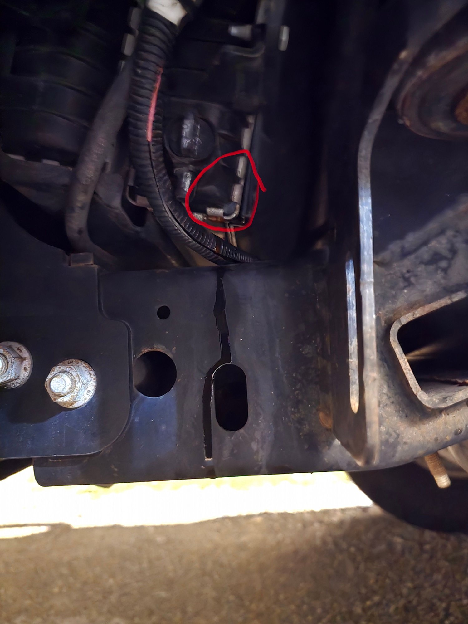

I found a coolant leak. Seems to have been leaking a while, just a small amount. Notice the drip a while back but thought it was the windshield washer fluid. Pretty sure I'm going with a mishimoto replacement. Some time this winter I'll do all the coolant work, got a lot of parts waiting to be insalled. Till then I'll try putting some more bend in the tabs, putting more pressue on the sealing surface.
