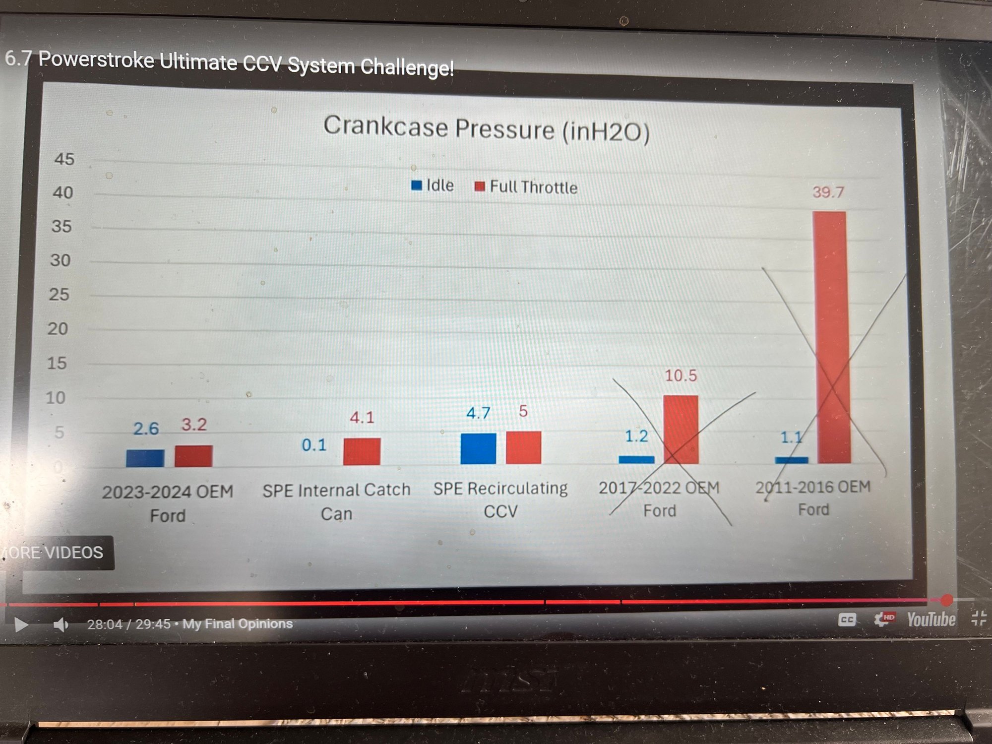

My contributions to what I consider to be longevity Mods:
  1. Add a skid plate to protect that plastic transmission pan, and other vulnerable exposed hoses and parts. Last weekend I installed an ASFIR skid plate, and am very pleased. I have a thread describing it here
  2. CCV reroute kit (eliminating the box, and recycled crud). I went with the SPE kit, with extended hose and internal catch can option. Still debating whether to install a catch can.

^^^^^^^^ Hmmm did not know they changed the CCV for the '23 model year. Wonder what the new design is. It would seem Ford agreed it to be the cause of the upper oil pan leak issue.
As far as mine I have the SPE internal and vented to atmo. I like the smell, reminiscent of driving a 7.3PS.

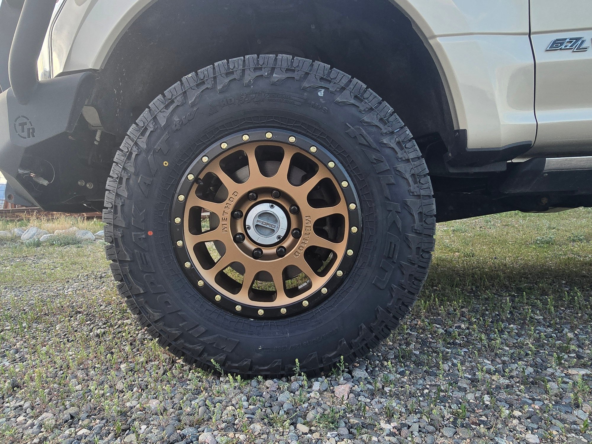

Finally got the AT4's on the truck this weekend. As posted previously I balance to zero with weights, positions ususally took less than an ounce with one at 2.75oz, and then put in 2.5 scoops of ceramic beads. Looks like I lucked out and these were four perfect tires, even the OEM set of tires had more vibrations than these do, I paid attention to the amount of steering wheel shake when new. This set is smooth as a baby's butt up to over 80mph, rides like a dang passenger car, almost unblievable. Granted I went from a 20" rim to 18" rim so more sidewall cushion but dang not all this is rim size, they are just a well-balanced tire. I work 430 miles from the house, drove it last night, so a lot of miles on secondary roads and highway. No road noise was picked up, a lot quieter than my Toyo's and zero vibration when I change lanes at highway speed or any other time for that matter.
I'm getting used to the rim color, not my favorite but with the HD series choices are limited, actually is making me want to get rid of more chrome. I went from LT295/65R20 Toyo A/T3 (listed 35.1") to a LT285/75R18 Falken Wildpeak A/T4W (listed 35"), the falken's seem taller but the toyo's had ~15k on them. I could tell a marked difference just driving out of my driveway at 30-40ish, major difference in tread and sidewall. Running 60psi front and 70psi rear.​​​​​​
I'm extremely happy with the latest round of work concerning ride quality and handeling.
- replaced all steering linkage (tie rod ends and draglink)
- replaced shocks with reservoir type
- replaced steering dampener with adjustable reservior type
- Installed softer sumo springs on front as bump stops
- Installed air bags on rear, keep 10psi in them (was impressed how much this helped in the rear even when unloaded)
- installed taller sway bar links, was running stock links but had 2" lift
- new tires, different size
I can say it rides better now than when new. Has 115K on it at the moment.

Dang, I thought someone snuck up on my truck and shot some pics of the wheels! We have exactly the same wheels and tires, lol. Good choice, I'm loving mine as well.

Thank you for following up with this information. I made an appointment to have some 37x12.5R18 Toyo AT3's installed, but canceled. The last two sets of toyo's I ran only lasted 40K miles and I cant bring myself to pay for another set of those.. I have over 50K on my Wild Peak AT3W and other than the vibration on two of them they have had amazing traction and wear characteristics. I really want the AT4, I am patiently waiting for them to release this size...... I have the same wheel as you as well, just in black, long bed also.
