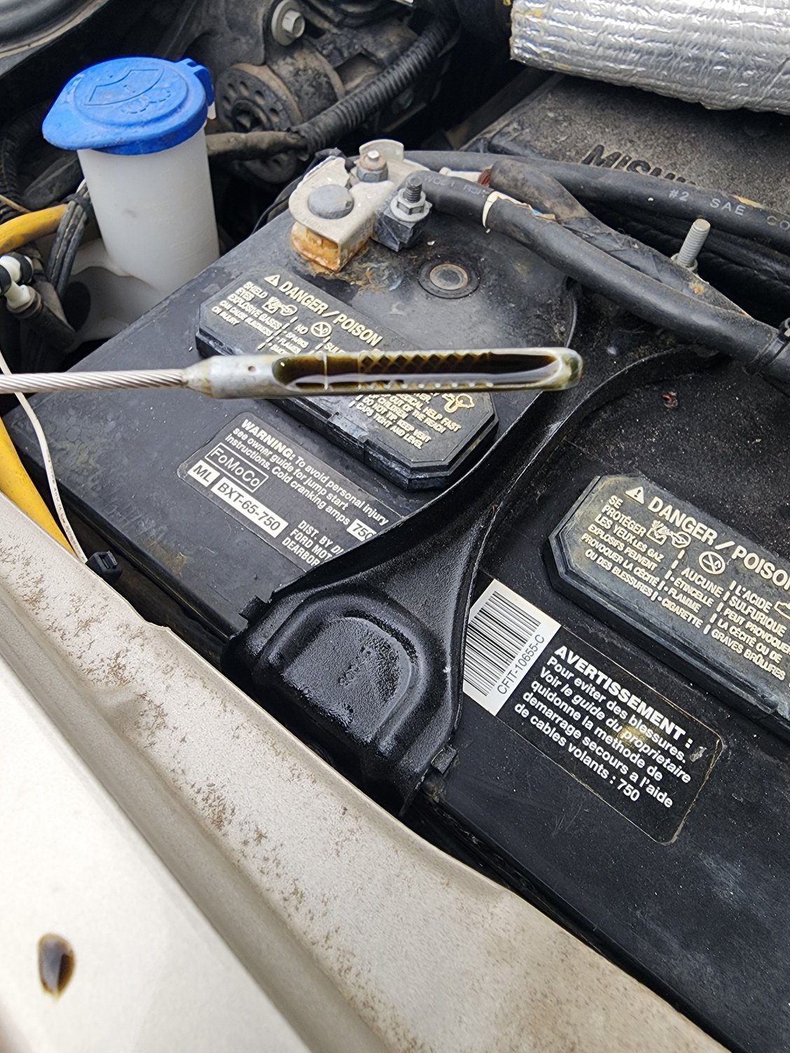

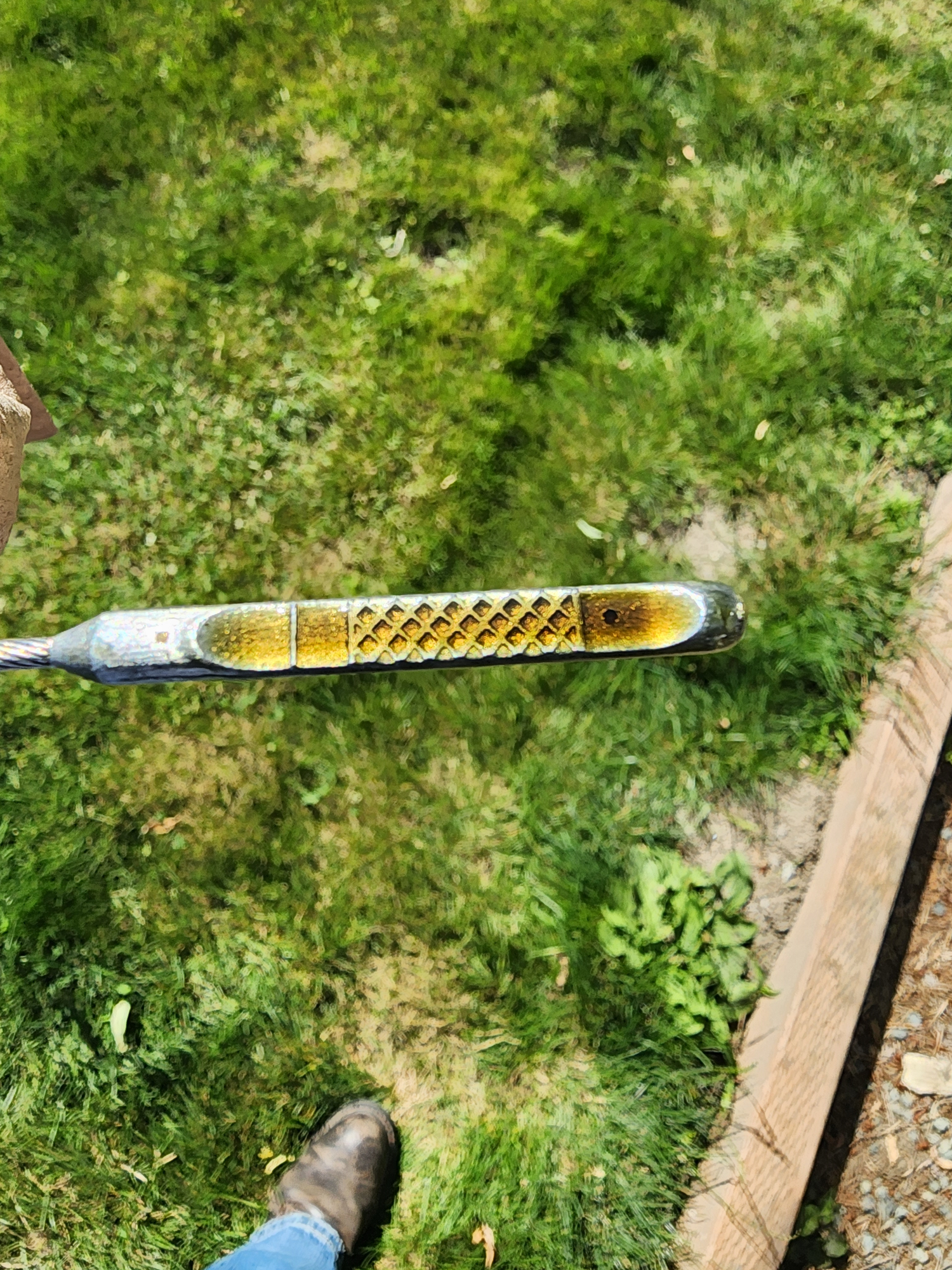

Update: This is after 4,000 miles, running unloaded plus 14-15 hours of idling, Hwy 90 from the Coast to Billings MT so many mountain passes to build some boost. I've learned to not drive tired, not worth it, so on long trips I'll stop and sleep hours in the truck.
Makes me want to apologize to my engine for running black oil for a 100K miles. I had no idea this was even possible. Can't wait to see when I hit 10K on this oil/filter setup.

5,000 mile update. The last ~1,000 miles were loaded with a +20K lb trailer over many mountain passes. My guess is the soot particles <2micron finally built up, the bypass filter "only" goes down to 2 micron and soot comes smaller than that. With the added work load on the engine means more got past the rings.

~5,230 update, 106K on the engine. After 230 miles running unloaded back and forth to town, it appears the bypass filter is cleaning the oil. Running unloaded it would appear less soot is getting by the piston rings and the filter is doing its thing, it's able to keep up with the current condition of the engine.

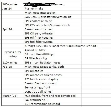

Silicon hoses.
Been about a year since I did the last batch of longevity mods. Happy with the results. For some reason I have bought aftermarket degas tanks and a lot of silicon hoses. This got me wanting to replace all the hoses with silicon ones; the main ones are easy but a few of the ones do not seem to be available, least not pre-formed. Anyone found all of them? Messing with the water jacket is one of my least favorite acitivies; this spring I'm going to drain the coolant and do all the mods at one time. I've got the rest of winter to source and stockpile parts.
So far I have sourced the top and bottom radiator hoses, oil cooler hoses, main degas bottle hoses, heater core inlet hose. If anyone has sources for the hard to find ones please post!

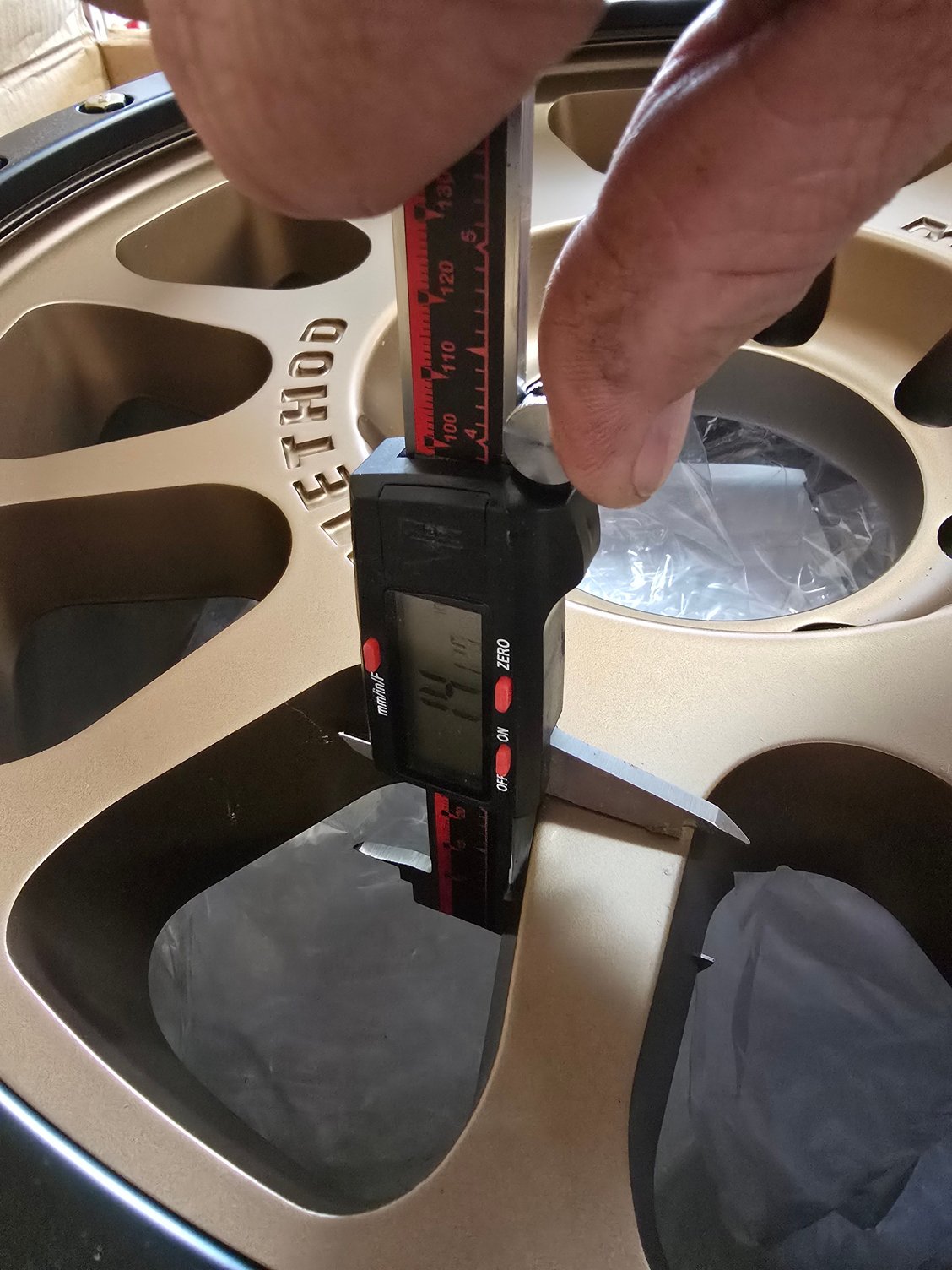

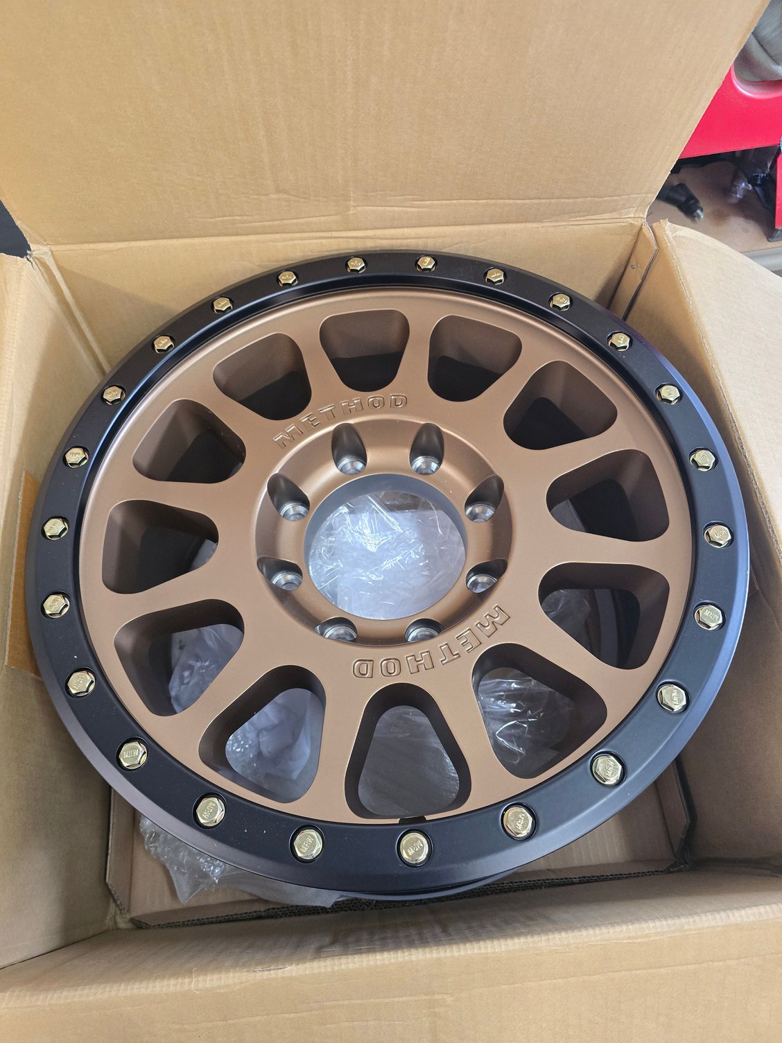

Got my new rims a while ago, 4,500lb rating. If you wonder how Method increased the weight rating it is all in the thickness of the spokes. 1.41" The website says the same alumium and heat treating is used on the HD and non-HD.
How did those AT4's balance out? I am running methods with AT3's, love the tires and have had them on a few vehicles but I have 2 AT3's in 37x12.5r18 on methods that I could not get to balance out. Took them to get road forced and they told me the tires were basically bad, so I have two tires I can only run on the rear or I get a steering wheel jiggle at 70 that drives me nuts. Planning to get a set of AT4's at some point.
