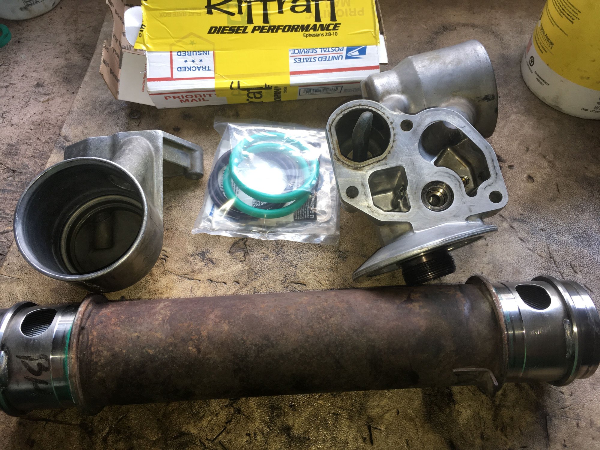

This truck got a Motorcraft oil cooler rebuild kit too.
