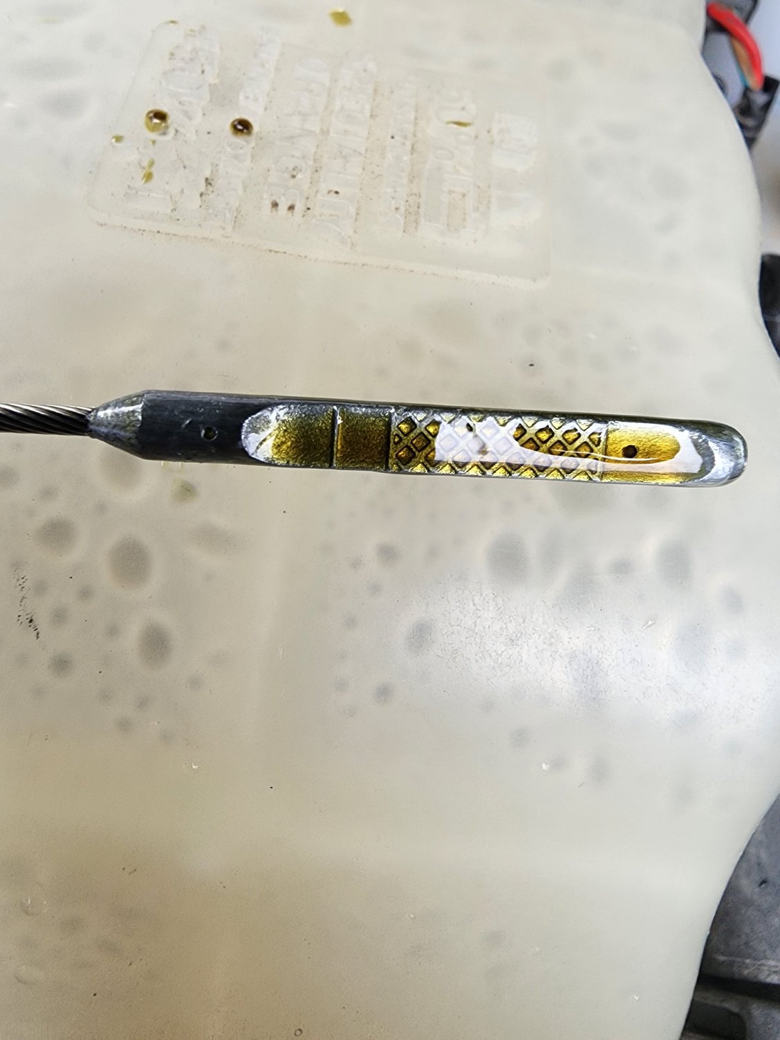

This Memorial day weekend I went 2,000 miles on the oil, pics are below, truck went from 101K to 103K miles on the oil. Does this answer your question why I "upgraded" my oil filter system? I've had numerous diesel in trucks and tractors, never had oil this clean after 100 miles. The choosen filters flow a higher rate than the OEM due to larger surface area (being larger filters). Same thing applies to the fuel system, saving the pump and injectors from any type of contamination is the goal. My goal is 500K with the current motor, when it goes I'll be replacing with the same 6.7. At this point there is no doubt in my mind the 6.7 is a better motor than the 7.3 powerstroke I had for 20 years.

Delete it. Have you seen what the EGR pumps back into the engine? Yikes
Let's say it is flowing air freely in and out.

IMHO that is probably contributing to the clean oil more than anything else. Any EGR is going to be brutal with soot loading, honestly this 6.7 isn't even as bad as my 04.5 5.9 CR Cummins. It relied on valve timing for EGR so it would run pretty hot and, I swear, loaded up the oil with even more soot.
