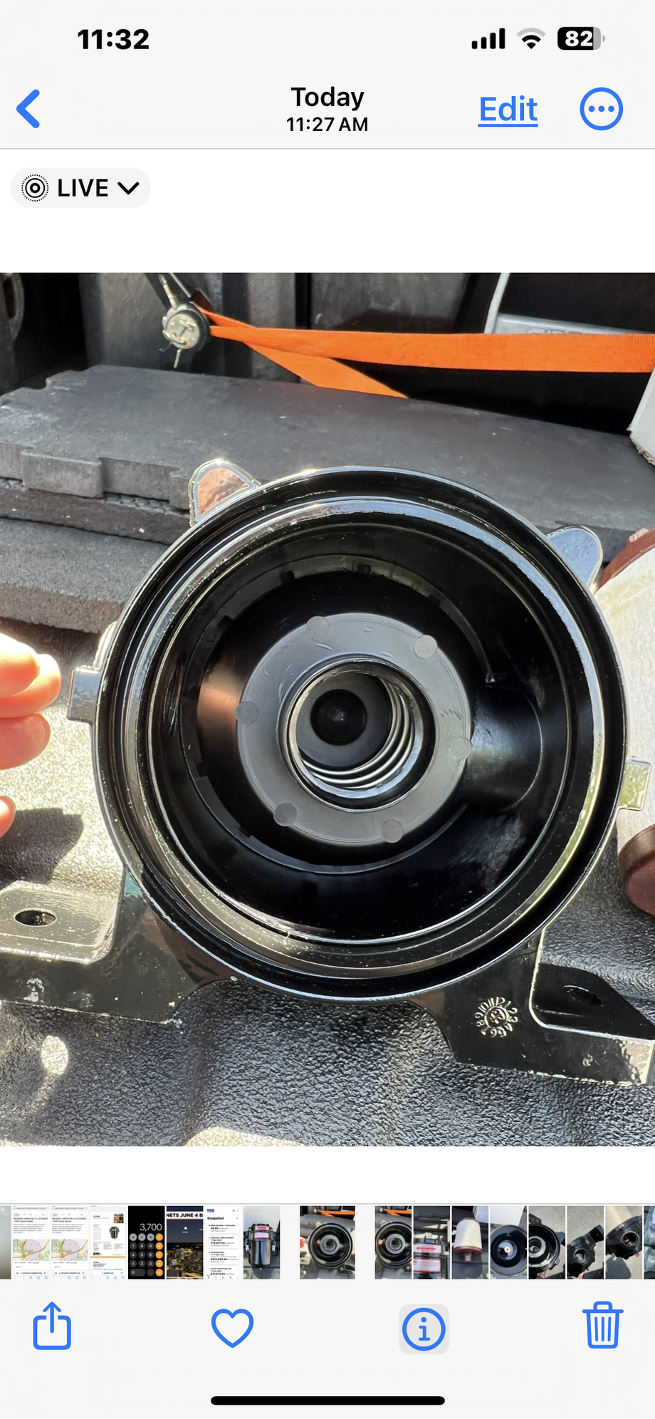

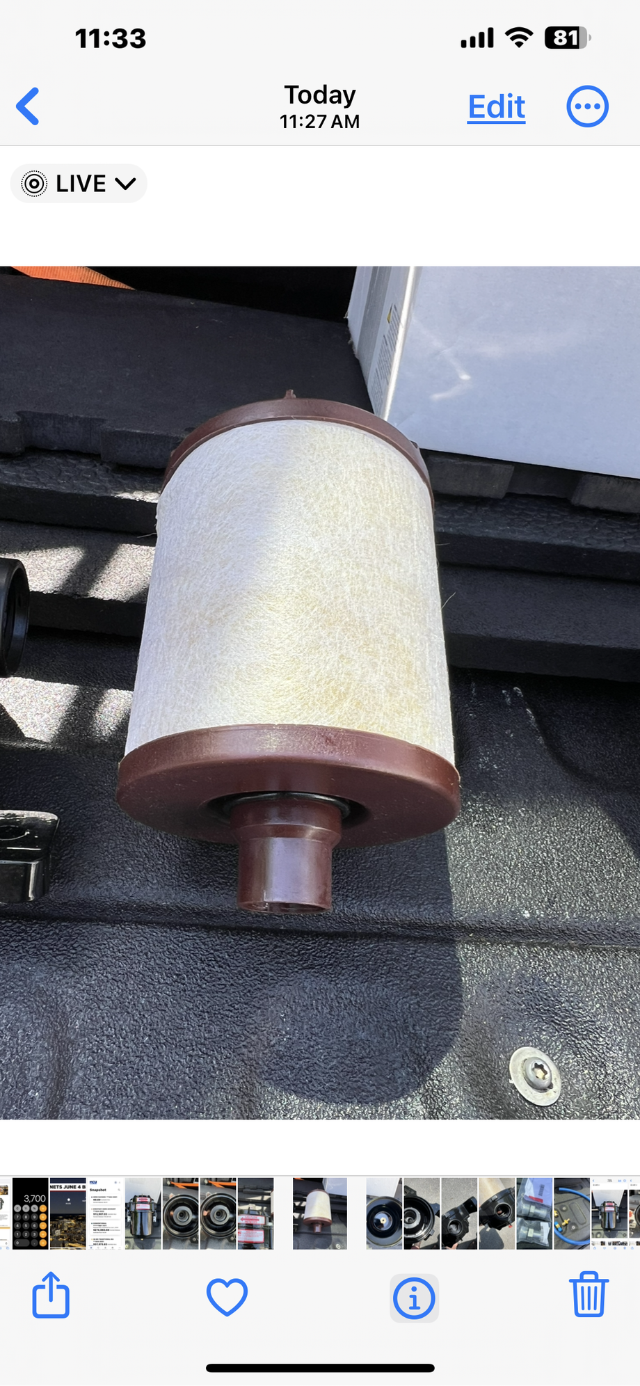

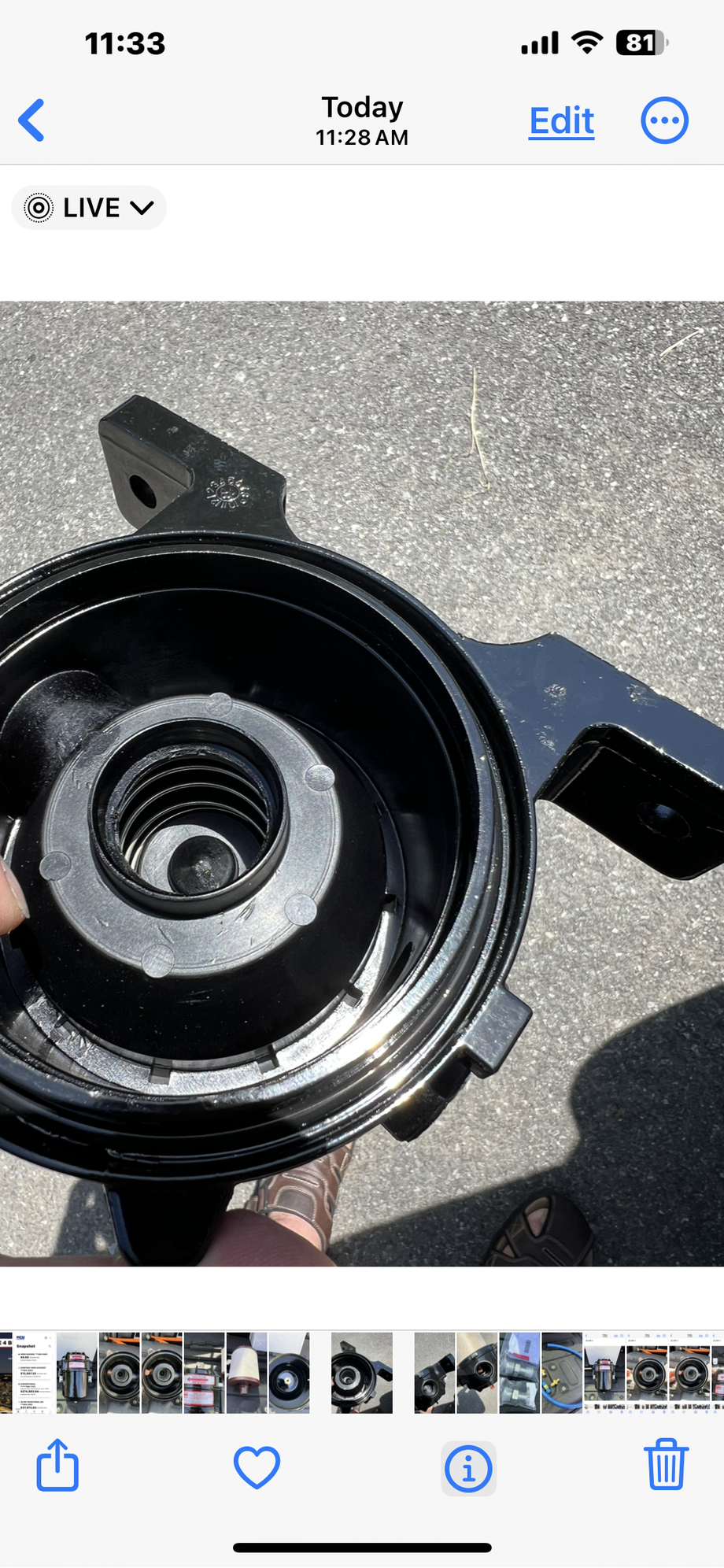

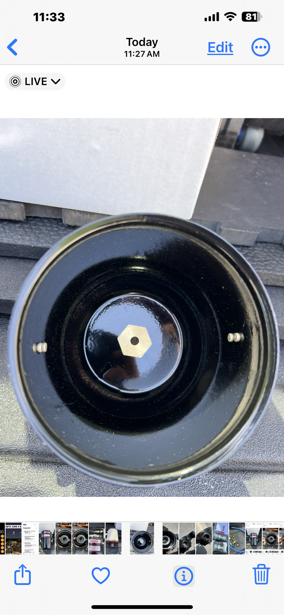

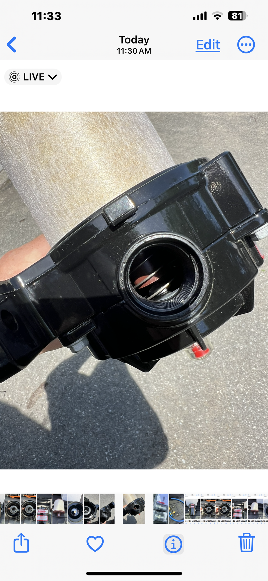

Likes: 2,198
Here are some unboxing pics
inside
filter element
these I bought on amazon
this stuff came with the kit and it’s the drain back system…if your sump does not have a side hole…you can drill your steel pan and use the drain back kit…but…I think I would need to use a ball check valve on something like this. Elevation would be a mounting concern if your going to use the drain back.

So comments are
the in and out holes sit above the filter element…there is a diffuser to spread the gas stream across the filter.
it looks like rancor , in the interest of having a service now pop up guage…has the gases running into the inside of the filter then flow thru the filter, and out. Me personally don’t like that…less surface area in the inside of the filter than the outside…I think I will give up the pop up valve functionality and route the gases going from outside of the filter to the inside. Doesn’t make sense to me to have a moisture trap liner on the outside and run gases on the inside….or maybe it works better for moisture that way…something to think about.
still deciding in return to intake or open air. If I do open air I’ll probally replace the filter with fine mesh metal screen roll.
I like the return to intake approach on one hand for any lube value to the turbo vanes but on the other hand..stock ccv brings a lot of heat into intake…maybe this external system diffuses some of that heat.
