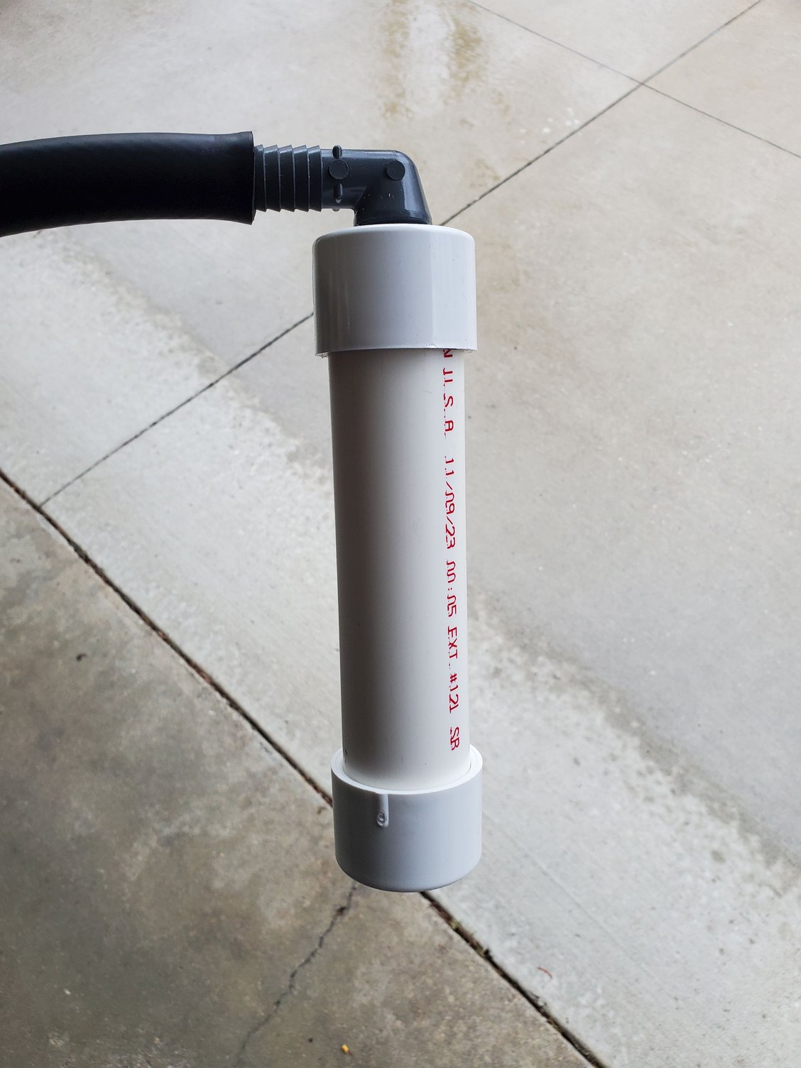

Originally Posted by jimzpsd
I made the catch can, used pvc tubing and painted it black. The ccv hose will connect to the can at the elbow, vent holes are drilled in the top cap. Not sure where I will mount it yet but most likely under the cab, keeping it simple. Next will be to install a brass drain valve and a mounting bracket. If I need to make it larger,.... I can. Currently the capacity is about 20 oz.
My DIY system is working great since the install, after 500 miles of use I was able to drain out some liquid from the can. But where my 90 degree elbow mounts to the can I'm going to replace it with a T fitting, and from there tap into the exhaust.

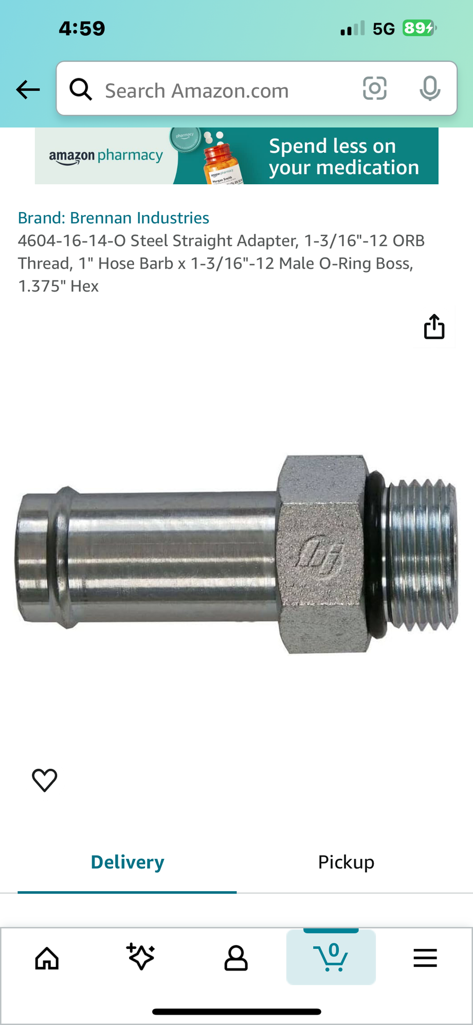

The threads for the in/out are 1 3/16"-12 SAE
wondering if this will work….same threads but it says orb…thinking that’s just an oring .
Old Apr 21, 2024 | 06:55 PM
  #57
Overkill2's Avatar
Overkill2
Joined: Mar 2017
Posts: 31,880
Likes: 9,175
From: Western NY
I'm thinking you're good bud...
Old Apr 21, 2024 | 07:18 PM
  #58
speakerfritz's Avatar
speakerfritz
Joined: Jul 2013
Posts: 14,266
Likes: 2,187
So I ordered two fittings
now to try to find a fuel and oil resistant hose.
