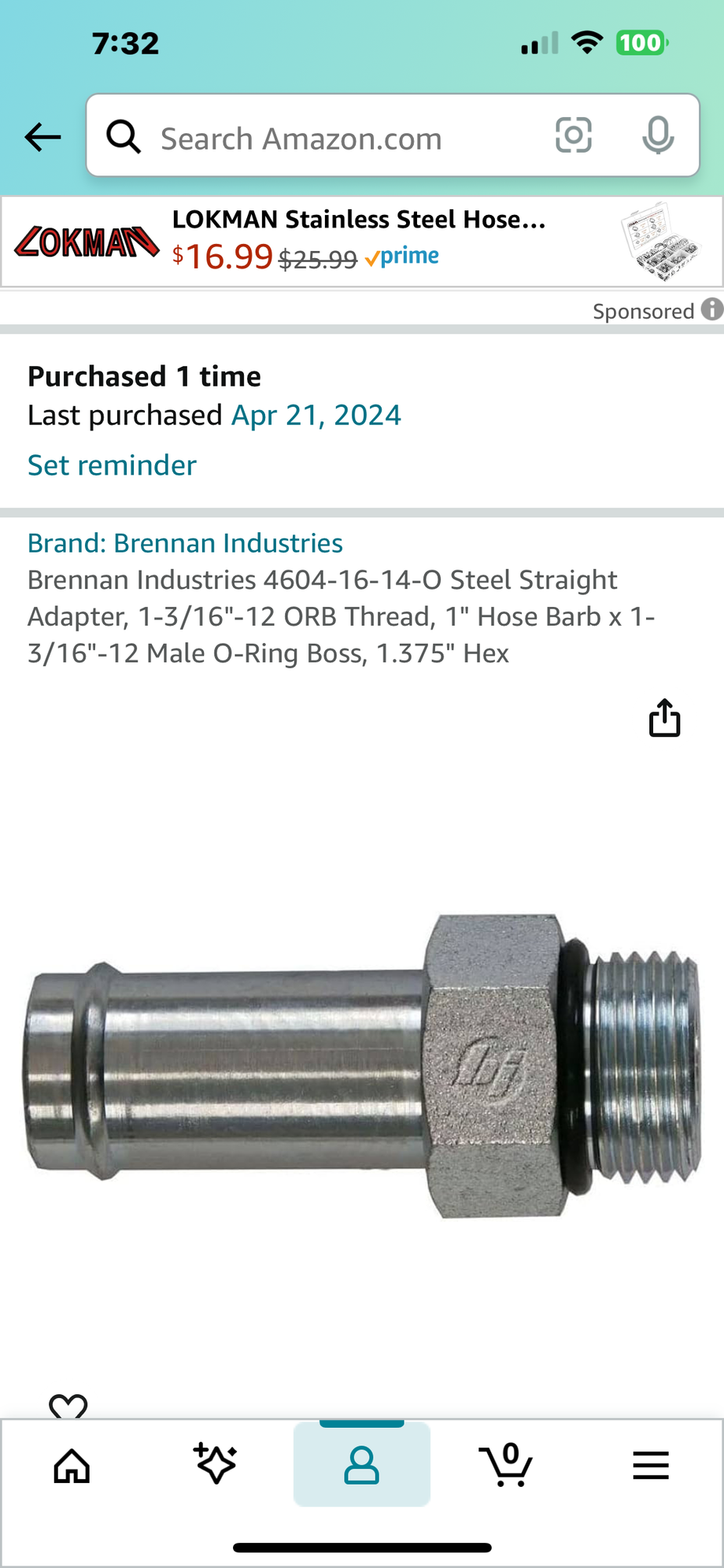

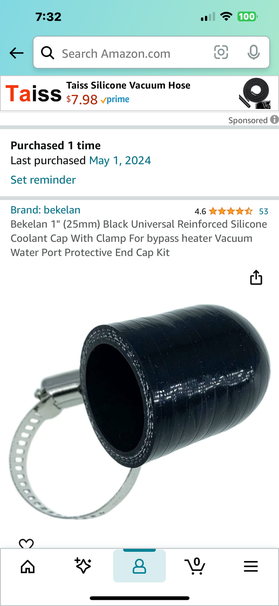

I’m still in Florida but here is the status of the favor ccv filter install.
1. I have the mount bracket , it will be an amsoil mount that goes on the side of the frame wheel the two transfer case skid plate bolts are.
2. the filter has arrived
3. the fittings have arrived
4. I ordered the blocking caps for my intake where the ccv hose mounts.
5. I picked up 20ft of 1” hose at a Napa store. Don’t know if I want to send the filter out back to my intake or run it to a hose to the rear bumper. Pros are the fumes are filtered and I would have a catch can and it will keep hot fumes from going into my turbo charger. Cons…none that I can think of.
i might walk this idea back if I can route the filter out thru a frame mounted cooler so that hot gases don’t go into my intake. The cooler might be phase 2.

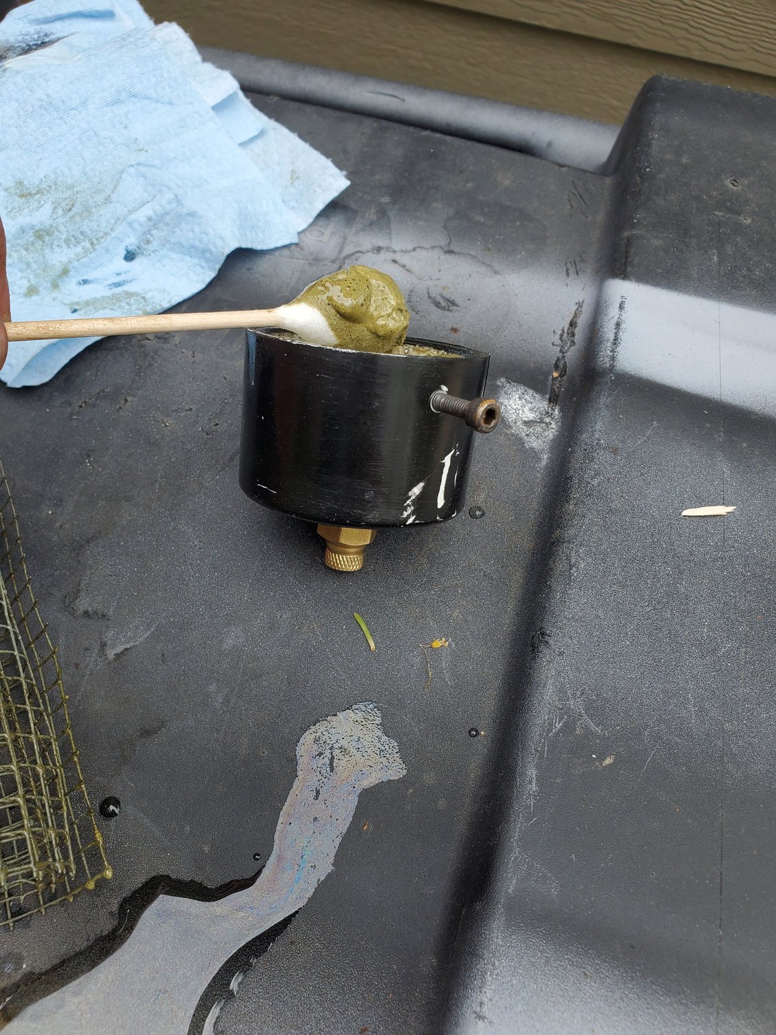

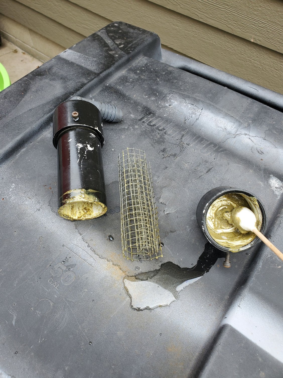

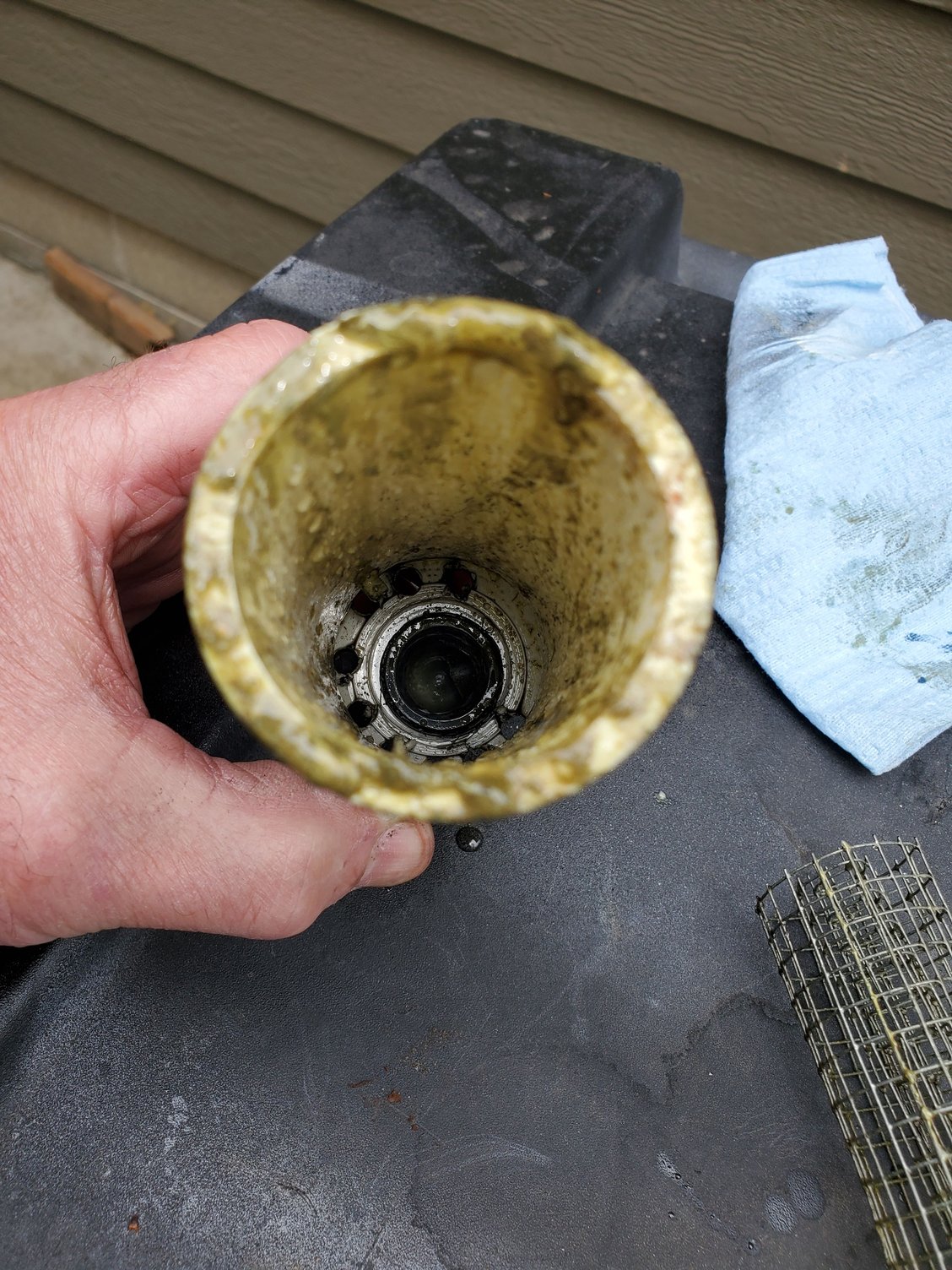

I had time today to open and clean my cdiy catch can. I can see how this gunk can clog a filter. Glad to see it being taken away from the engine.
Yep that's EXACTLY how mine looks...
Before the water was dumped out...
After...
So kudos to you Jim and your functioning catch can my man...
