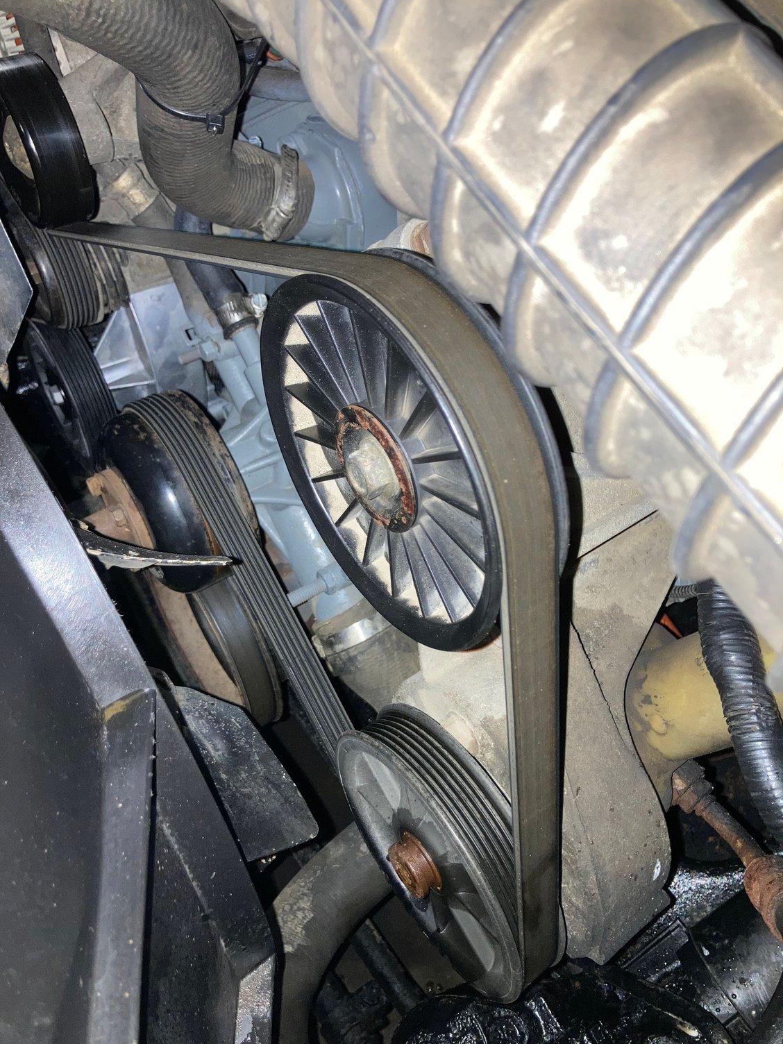

It's like a verbal warzone here! I don't know what happened and I didn't read everything before writing this so I apologize if this is out of place/unnecessary.
WannabuyaFord, I've been looking at the serpentine belt routing diagram, and here's my two cents on the issue.
After the belt routes around the alternator and rides on the tensioner, yours goes straight to the crankshaft and not to the smog (which is deleted at the moment).
The amount of force the tensioner needs to keep tension on the belt when the you skip the smog pump is greater than what the stock tensioner was designed to handle. With the belt wrapping around the tensioner and around the smog pump it is less stress/force on the tensioner.
Which makes the tensioner more effective with the smog pump/dummy pulley in place.
When I tried to help you earlier when you started this thread I did not account for the change in tensioner location, on my 1990 truck the tensioner is located between the alternator and A/C so when I deleted the Smog system, All i needed to do was run a shorter belt since the tensioner was not affected, or at least not affected as much.
Since you're missing that smog pulley, it has drastically changed the angles the tensioner was designed to work with, of course there's gonna be some belt issues.
Get that smog-pump-dummy-pulley if you haven't yet, and the OEM belt length. I am absolutely convinced this will be the proper fix.
We're here to help because sometimes it sucks to own a FORD!
Let us know how it goes, and good luck!
-Marshall

Mine is a 95 f250. And was optioned with ac but I already deleted it years ago with a bracket and replacement pulley, belt length didn't change then. Recently I pulled the motor out for some repairs and one of the things I did was delete the air pump and attempt to shortbelt it. The common method I had found to do this was to also eliminate the top idler. I tried three belt lengths before finding one that 'sort of' worked. Being unsatisfied with how it was being tensioned and the start up alternator squeel it developed, I decided to go back to factory routing by using the mustang air pump elimination bracket. Knowing that I needed to swap out the pulley on that bracket with one the same diameter as the air pump pulley, which I did. It all worked out perfectly. I'll try to grab a couple of pics and add them to this thread.

I find posting pics a bit difficult but will try to get a couple up still, working quite a bit. My routing that I will be taking pics of isn't/shouldn't be helpful to anyone. Its the factory routing for a 95 f250 5.8w. Instead of a ac compressor there is a ac delete pulley, instead of a air pump there is a mustang air pump delete pulley where the pulley has been changed to the same size as the original f250 5.8w air pump pulley which is the same size as the ac delete pulley. Factory belt length, factory routing. I did not re-use my air pump as a idler pulley as its nearly 30 years old and felt rough to turn. Both of the delete brackets I used bolt in place of the original components they are deleting. It's as simple as that.
I removed everything to do with the air pump system except the electrical solenoids. All air tubing and vacuum lines. My 95 f250 5.8w had the air system connected to the exhaust manifolds not the heads so I plugged the manifold entry points, didn't have to look at the back of the heads at all. I didn't follow any specific how to. I researched it and came up with a plan and executed it.

I’ve looked back a bit in this thread. And my pic of my belt/deletes is way crappier then the one that Auroragirl already posted ages ago in this thread. Exact same delete brackets and pulleys. Factory belt length and routing, tensioner works exactly the same as factory.
