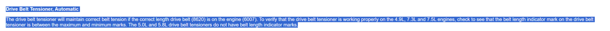

Also this: On models with an automatic tensioner, belt stretch is determined by inspecting the wear indicator marks on the tensioner assembly. If the indicator mark is beyond the MAX mark, the belt is worn and must be replaced.

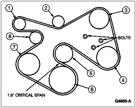

you appear to be missing your secondary air injection pullley, which is making putting tension on your belt more difficult. Can you confirm if you have it still?

And maybe I'm just stupd but I don't see marks on the tensioner?
I don't. Sorry, I wasn't clear. That's what I was referring to when I said that I don't have emissions. Maybe I used the wrong term? I don't actually know what an air pump is, I thought it was for emissions. I also don't see a place to attach a "dummy" pulley, but I will look again when it's warmer out.
