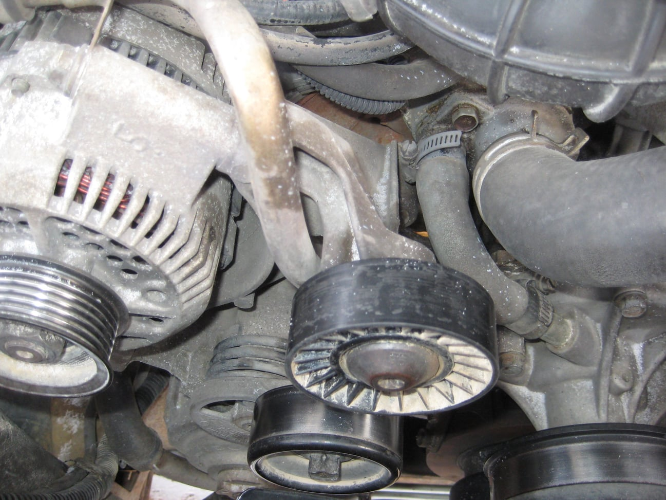

I’d disagree, the belt is not the problem, and getting a shorter belt isn’t the solution either. Your belt is falling off the pulleys either cause those idlers are causing it to slip, or the tensioner is no longer strong enough to keep tension on the belt.
Could be but did you see the photo? The old belt is longer. To me that suggests that it is stretched out and needs to be replaced.
It's not "a shorter belt" - well it is but it's the same model.
I suppose it could be the tensioner. The idler and dummy and PS pulleys are all new.
Anyway like I said unless it gets really cold again there's no way to look at it when it falls off because it won't fall off again. I still need to be able to replace the belt!

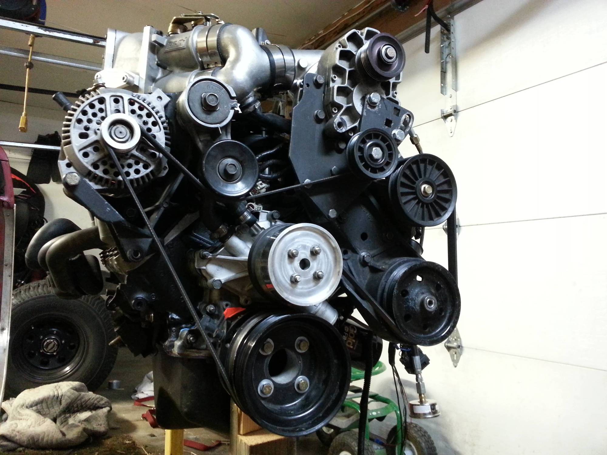

now, if you want to NOT use this, I seem to recall maybe it was @rla2005 pr @Hit Man X who had deleted that pulley and found a new belt and srouted it the same way as apparently some 302 mustangs came factory?

Old Jan 19, 2024 | 06:42 AM
rla2005's Avatar
rla2005
Posts: 20,786
Likes: 1,751
From: Kentucky
I was able to remove the smog pump and not use an idler in place of it on my old 1992 F350 w/5.8L engine. It used the same tensioner and routing as the top photo that AuroraGirl posted. The tensioner and belt routing the OP has is not as friendly since one of the belt idler pulleys is above the tensioner. There is less wrap which can causes issues.
Old Jan 19, 2024 | 07:09 AM
AuroraGirl's Avatar
AuroraGirl
Joined: Jun 2021
Posts: 5,221
Likes: 805
I thought I saw something different between the photos! Is this tensioner an extra or is it a different one? one could swap to make it like the picture?
