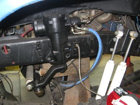

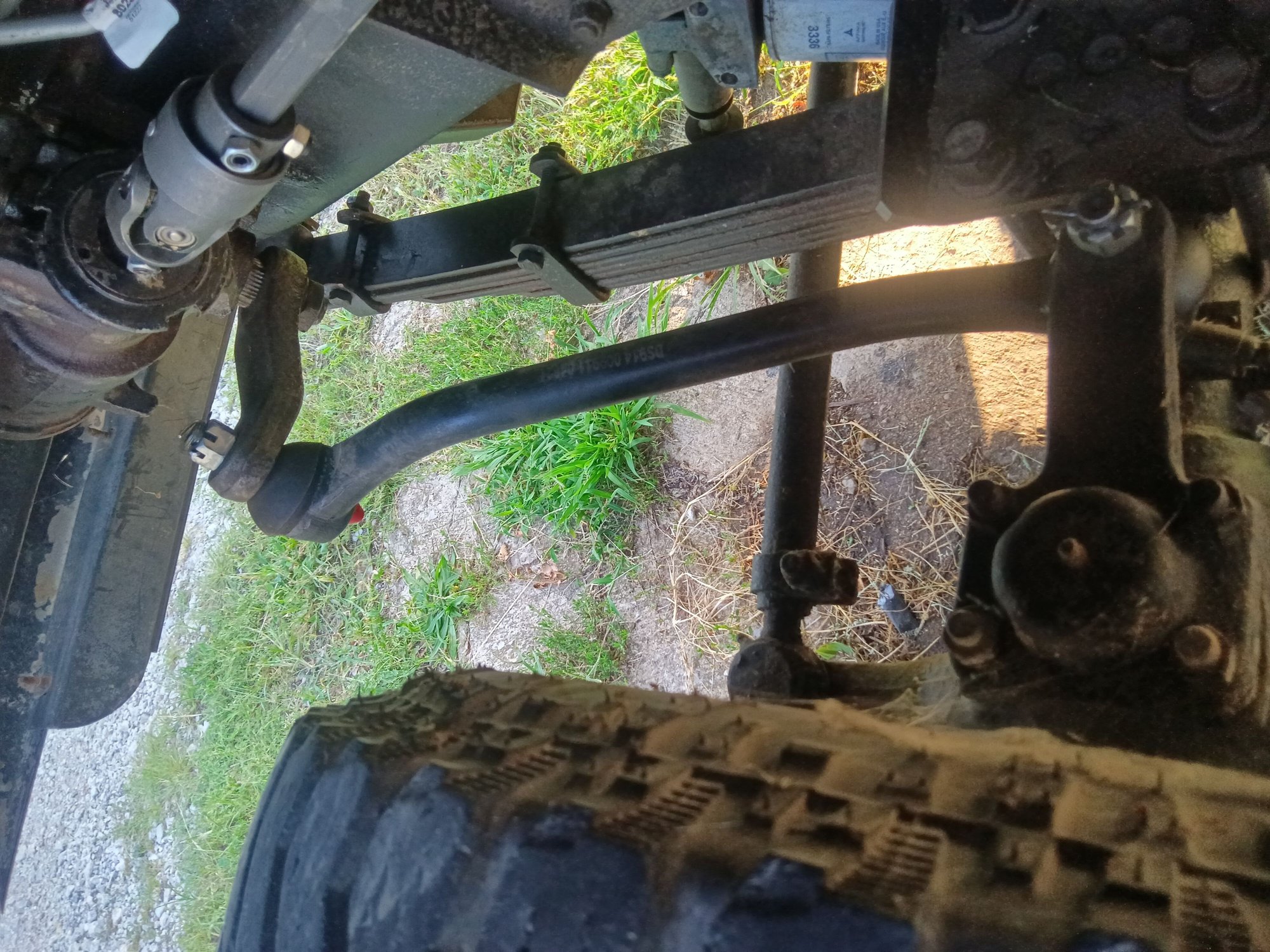

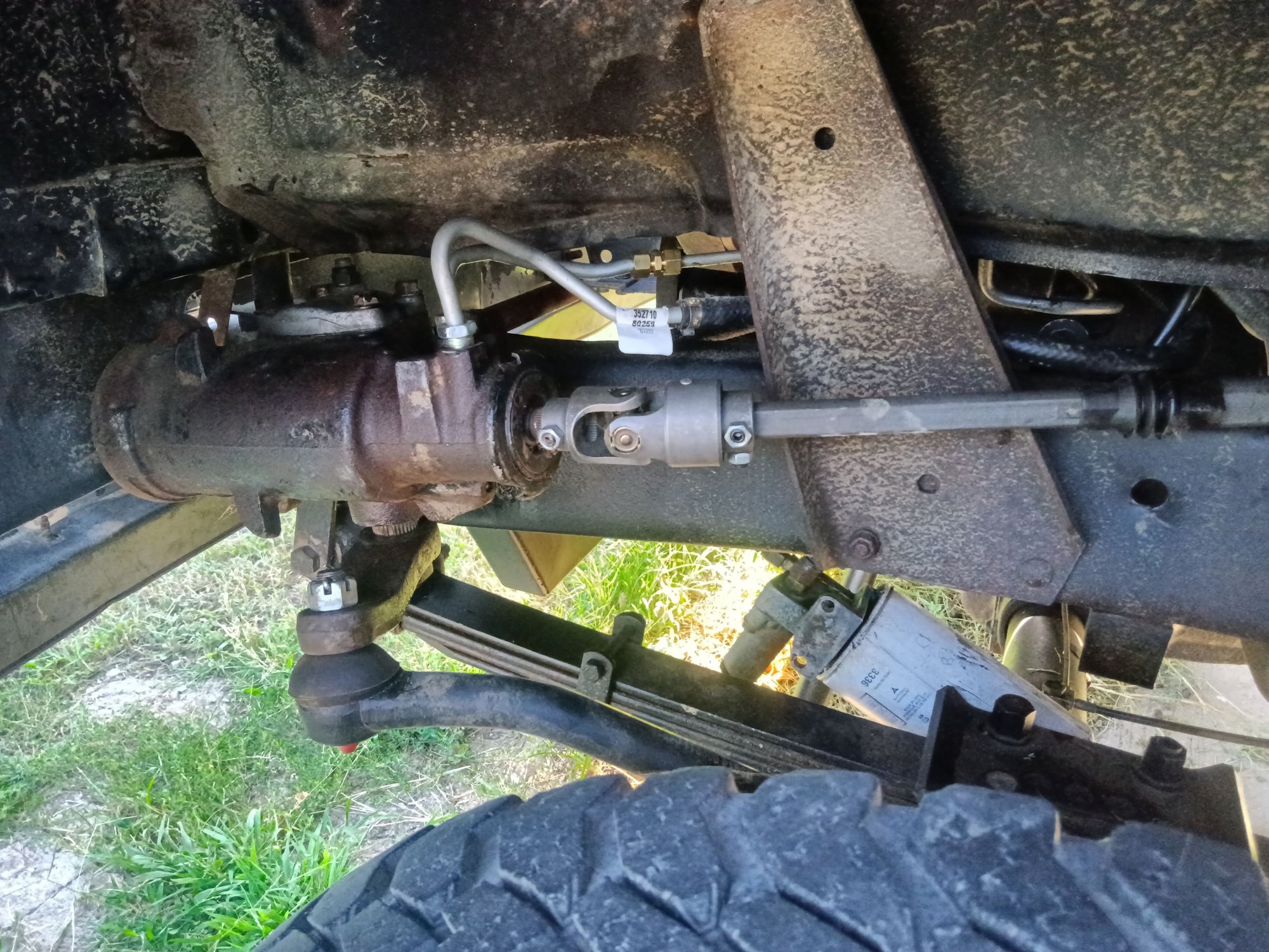

I've seen two options...
1: A typical 70's and up Ford manual or power steering box mounted in front of the axel and set up for cross steer....
2: Gm or Dodge box mounted far forward on the frame and set up just the opposite of your original box... Or mount the box inside the frame and do cross steering.
I have done #2
Box outside of frame rail, connected to stock collum.
Push pull drag link to a high steer arm...
