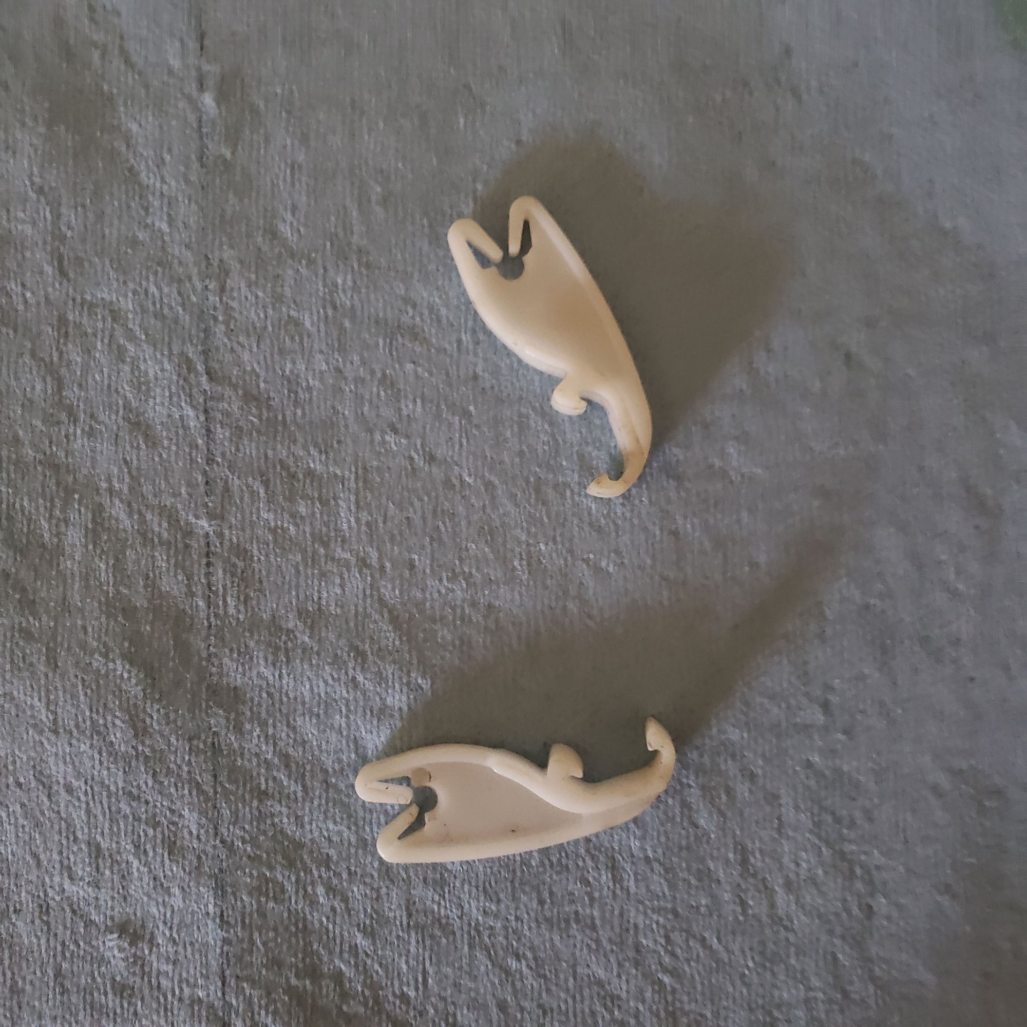

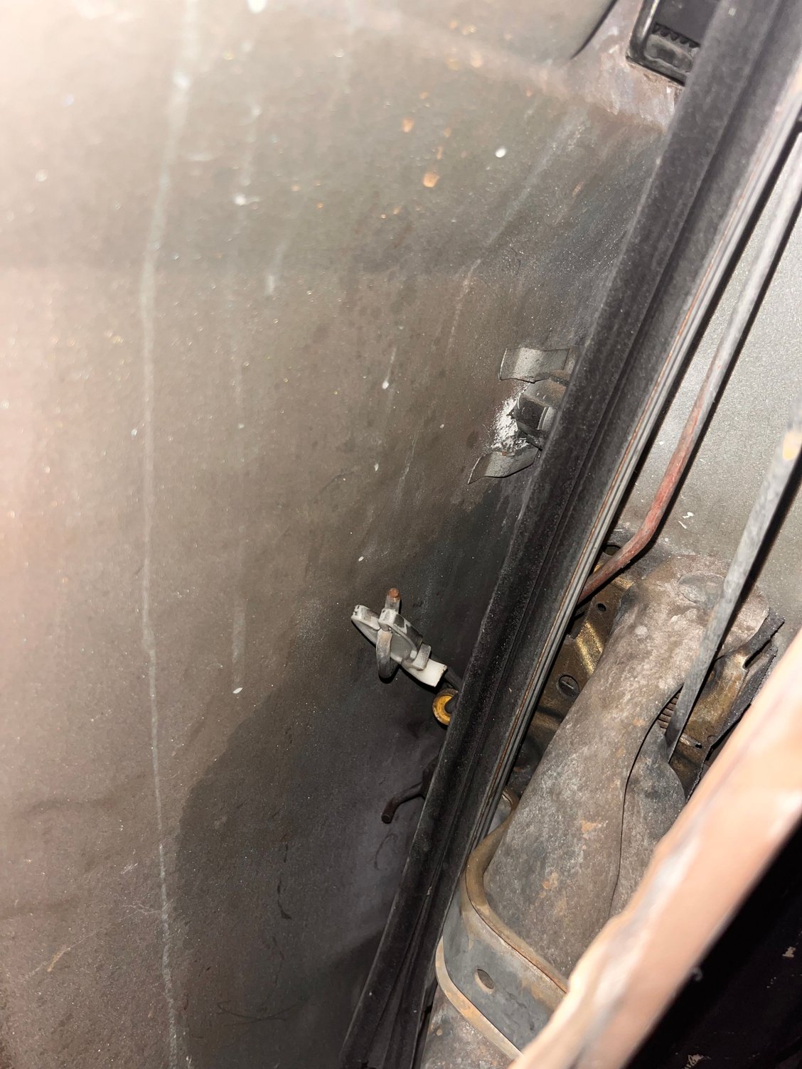

Where is the rod supposed to be connected to at the top

That white clip is supposed to be attached to the lock cylinder.

Bummer
The tab is broken on the white clip (you will not be able to reattach it to the lock cylinder)
I have a few, they are cheap if you can find them

There should be tabs on both sides of the lock rod retainer clips

The new white clips
They come with a lockset on the new lock cylinders
You can replace the cylinder without taking the panel off on most of them
You can also fish out the rod that AAA breaks on some of the others like yours
Good luck
