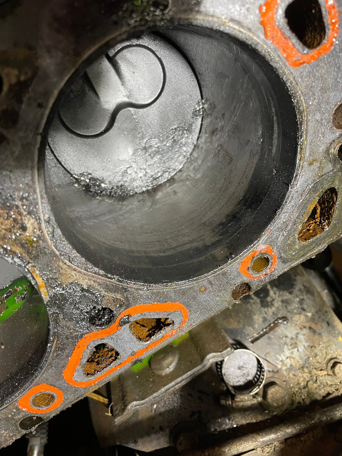

Update: I did a compression test and that cylinder read 150 psi and the others looked normal. The injector and replacement glow plug were covered in a significant amount of oil, and the blowby blew the cap off the oil fill tube when I set it on top.
I pulled the head off and finally got a look at the piston…
I’ve only done minor mechanical work up until this point so I’m probably in over my head, so please pardon my ignorance

Since you've already disassembled the engine that far you MAW rotate it around until the piston is at BDC. This will let you see if the cylinder or just the top of the piston is damaged.
The sure way to tell would be to disassemble the short block and use a dial bore gauge to measure the cylinders to ensure they're concentric.

while that piston top is damaged, i have seen much worse and the engine still ran fine with good compression.
as said, there is either cylinder wall damage, or that piston has broken rings on it. .

you got the head off, now you can replace a piston if the wall is ok
