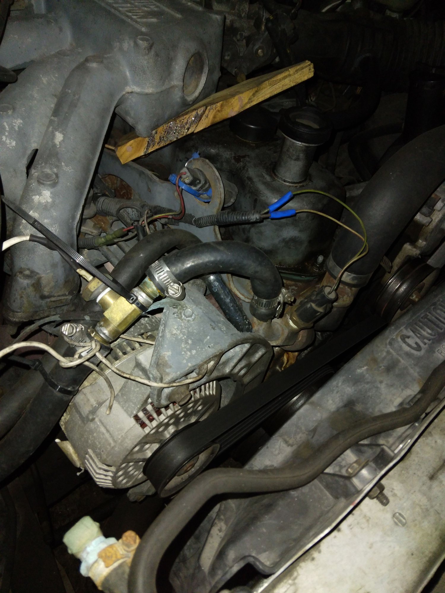

I use the heater hose , get some pipe fittings that fit the hoses and sensor.
The factory EFI temp sensor on the I6 engines are hard piped just to right of my additional sensor. I am using the same sensor for the ECU and programmed a Arduino to show engine temp on a LED display.
