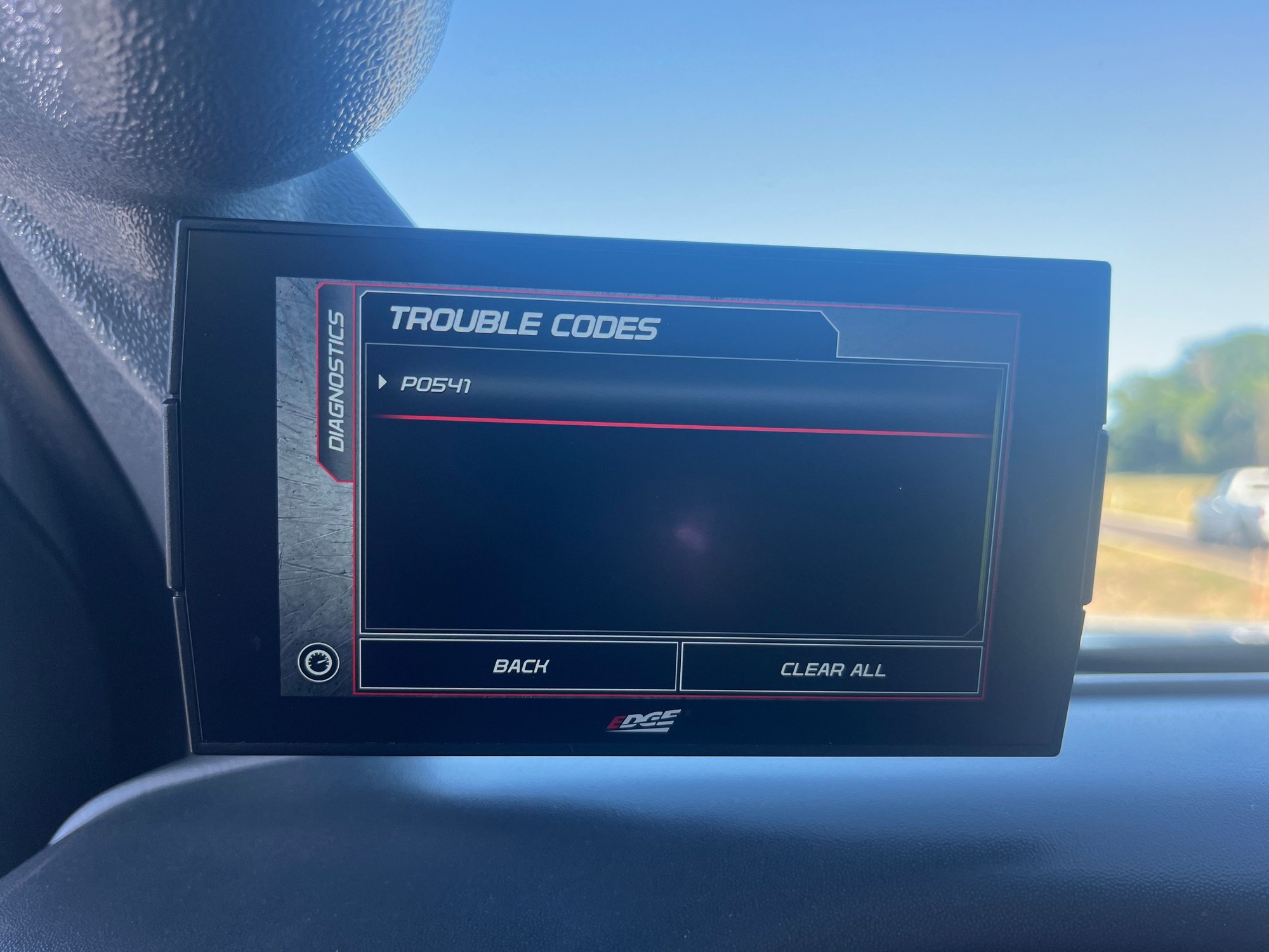

no codes on my CTS3 and no check engine light…

The P0541 code is the AIH Delete. It’s always there.

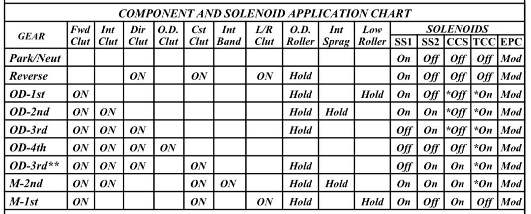

So it does have reverse? That should rule out TC. TC turns Input Shaft. Everything goes through there.
Grabbed this from somewhere years ago.
Wish I had a better understanding of how the mechanical side connected (as in what part/spline has physical connection to another for power transfer).

It isn't the converter, the transfer case, the solenoids, or a diode. None of them can allow reverse to work but not forward. The trans has had an internal failure and needs to come out and be rebuilt or replaced.
Running codes is fun, but in this case, it would be a waste of time. Something mechanical broke inside the transmission.
