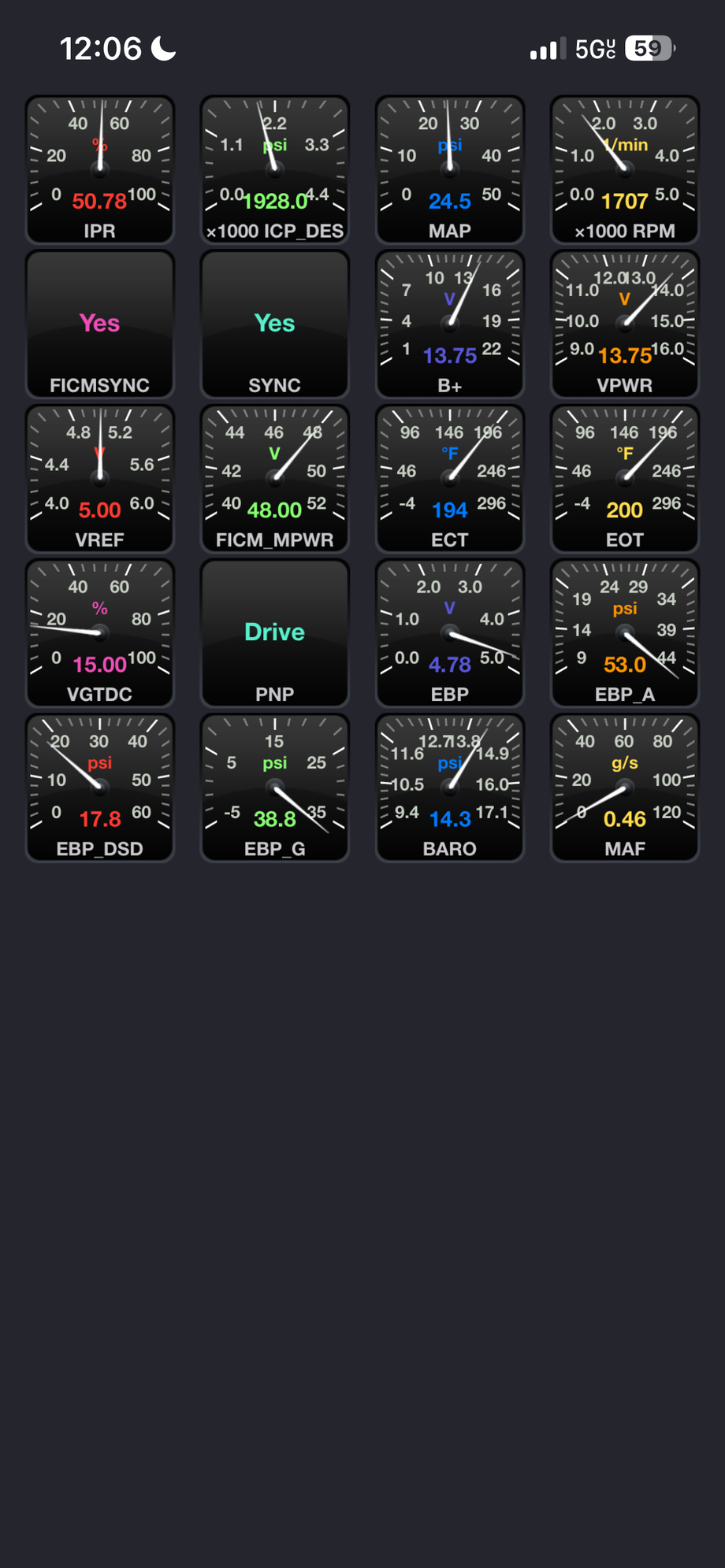

that helped a little but ebp is still reading at
Engine off. Ebp 14.1 map 14.4 baro 14.3
idle ebp 18-19 map 15.2 baro 14.3 maf .13
Still chugging some. It's better but still not there. I just rebuilt this turbo. It was running fine before I put it in here.
getting p478 code for ebp, 299 under boost at 50-55 mph

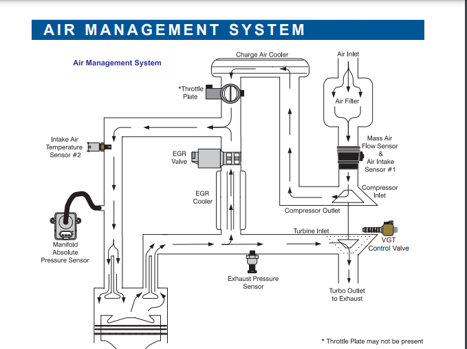

Air system:

My point in posting the diagram is that if the Charge Air Cooler (intercooler) is plugged, it should not raise the EBP reading. A clogged cat would.
While not directly causing high EBP's, a failed closed EGR valve could cause EBP pressure to be higher than the target.
Also, it takes a few drive cycles to relearn turbo control and operation after problems are resolved.

I get it. Actual high ebp can be caused by 2 things. A turbo issue where the wheel is slowing exhaust movement or something down the exhaust trace.
the sum is at key on engine off, nothing seems out of whack. At idle, ebp 18-19 and map 15ish seems normal as well. It's when I mash on the pedal that ebp rolls to 50+ bc the reading only goes to 53 and map is half that, say 27ish.
Seems I have a cause and effect. Which is causing the other? my suspicion is if the reading is bad at ebp, the map would still show more boost at wot? If the air flow is there for real, the map should read more at wot bc the air is actually flowing. Can the vanes slow the map down that much at wot?
seems like there is a logical answer to my issue based on readings at wot relative to the others. Having two turbos running perfect then stop and restart 45 mins later and all the sudden no warning to have it run like crap seems odd. Something mechanical failed. Something electrical failed.
don't know egr - it can be deleted and closed off so don't know I think that can make ebp this high. Closed, air should follow the normal path out the exhaust. Going to drop the down pipe and just see what happens. 2nd, I'll bench test all 3 of my vgt solenoids. Third, got new ebp sensor in this am, but I don't believe the sensor is the issue at all. Think the reading is actually high due to the barking and noises - it's the down line exhaust, the turbo or something restricting airflow at high end.
