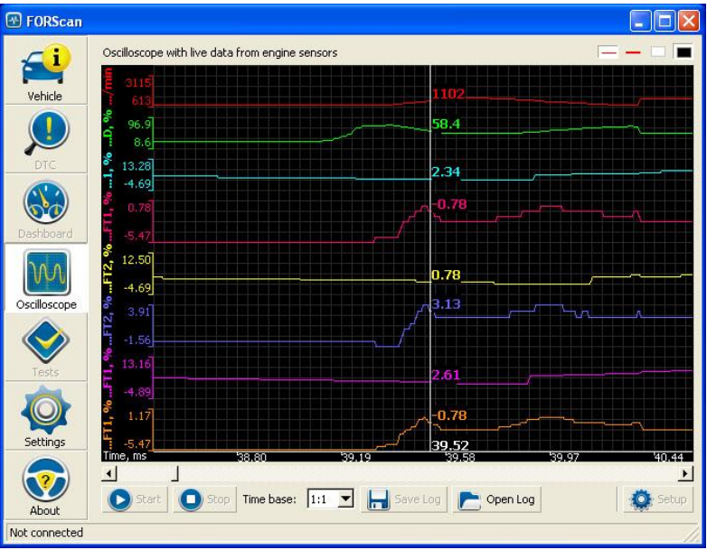

If you are on PC, did you "save" the data logs with the save button at the bottom of the image below near the middle?
If you were using a PC and saved the data logs, look for files with the extension .fsl at this location in the directory.
C:\Users\yourusername here\Documents\FORScan

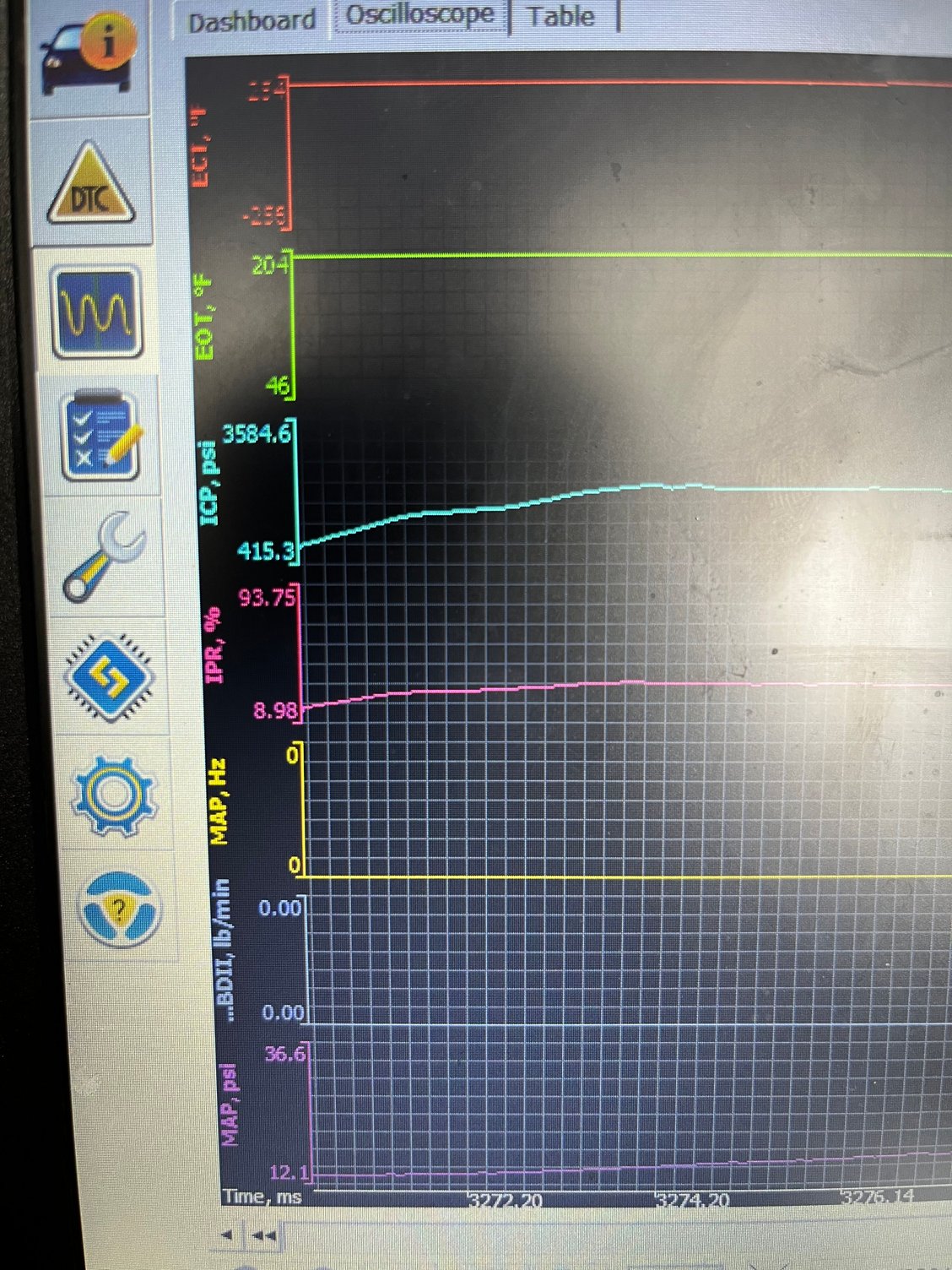

I don’t know how helpful this will be but I went for a nice drive today. Computer died before I could save anything lol but this is what I got.
MAP says I maxed out at 36.6psi (12psi at idle) which is not accurate…
Everything read smooth with no spikes or anything weird. Though two of them read zero the whole time maybe I just selected the wrong ones..
Curious if the ICP and IPR look good?

MAP reading includes atmospheric pressure. So it looks like it was pushing around the max reading possible by the sensor and about 24psi of boost. Does that sound more like it?
Thanks nailed it! 24psi it about as much as she’ll build. I did not account for atmospheric pressure.

Andrew, these are old trucks and based on the image above, everything looks to be within normal operating parameters. Of course, that is a mere snip of the overall trip.
