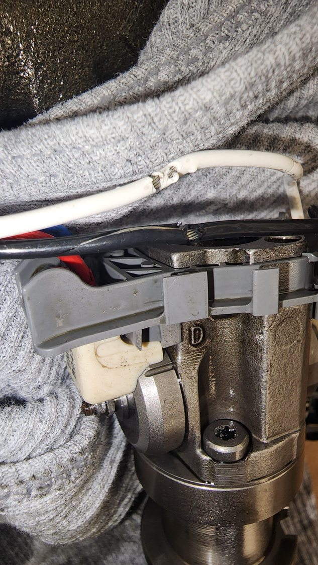

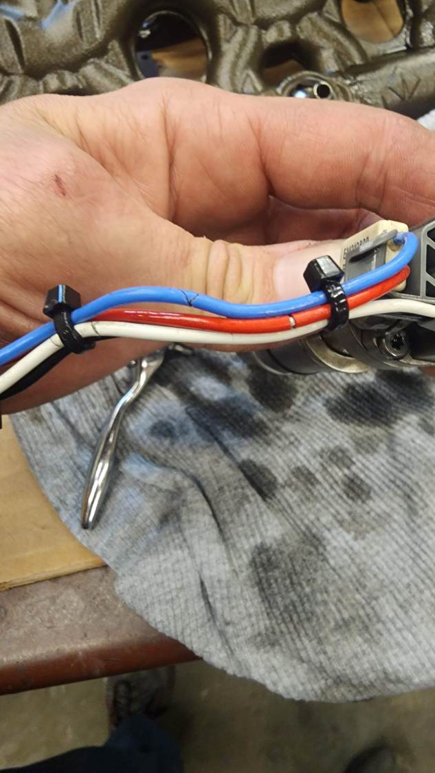

If you have p0262, p0271, p0277, p0280 or any of the other injector codes and recently had your injectors replaced, find out if they are Pure Power Technologies injectors.
The attached pics are my 5000 mile injectors. After 2 FICM's and a injector harness I ran out solutions and decided to look at the new injectors. I would have never guessed what I found. The wires insulation was cracking and I could easily strip the wires with my fingers.
Unfortunately, the shop that installed them got an EPA fine and went out of business. I called and emailed Pure Power Technologies and got crickets.
So because of poor quality injectors that I already paid for I'm out 2 FICM's, Injector wire harness and 8 new injectors.

The shop was Baillie Diesel in Nixa MO. They had a decent reputation. The injectors toasted the first 2 FICM's. I oscoped the output during buzz test to confirm what was going on with the second FICM. I never expected my brand new injectors had a problem but I did ohm check them and they were all good. Sometimes all the injectors would actuate on buzz test and sometimes not. Apparently on starting, one would short out intermittently.
There where 2 different coil packs on the set of injectors. 5 had the cheap insulation with brighter color and 3 were good wires with a duller color. All where PP remanufactured.

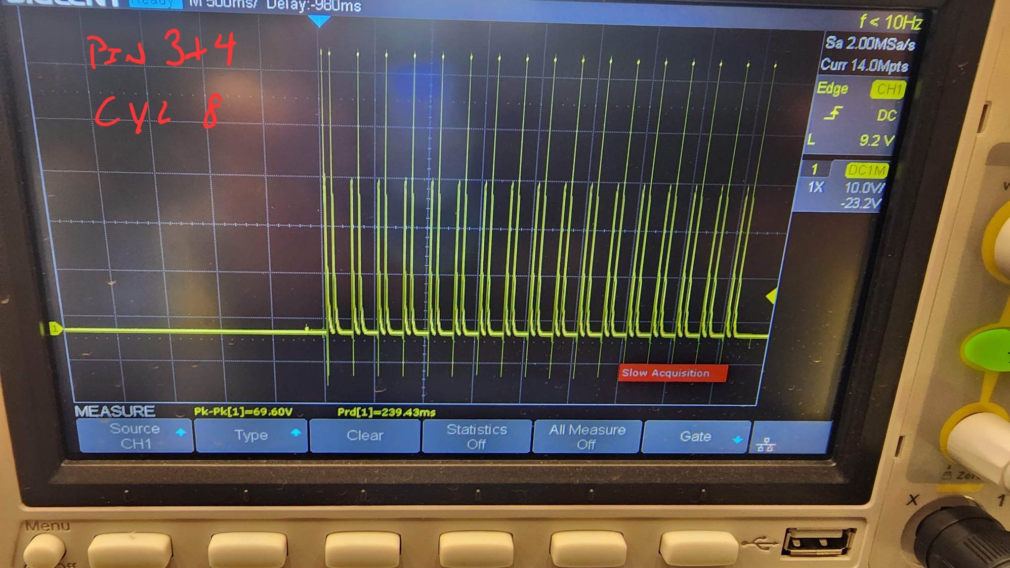

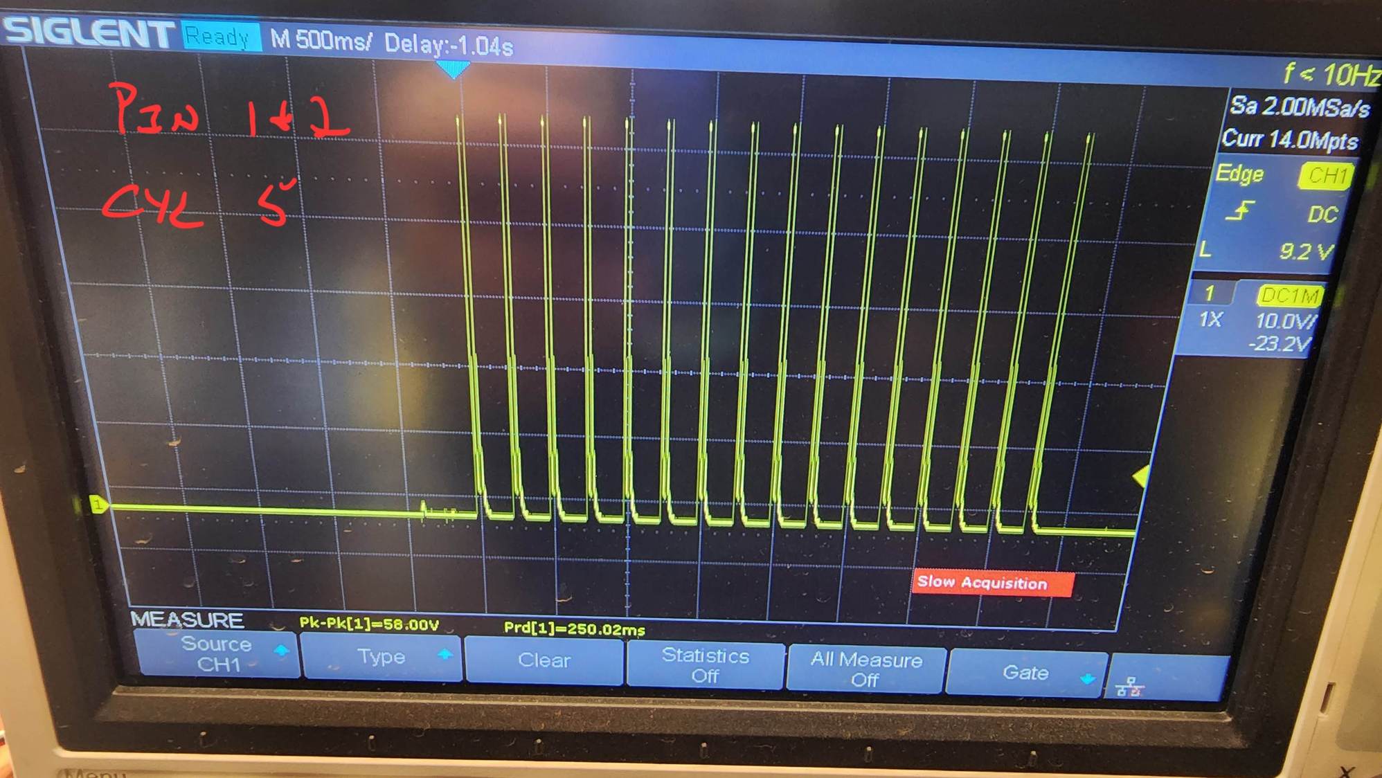

I replied to most of your post on powerstroke.org. As far as the toasted FICM. My original FICM wouldnt even start the truck. Got a replacement from circuit medics and truck started fine. Then noticed it still didn't sound right. Cyl 8 was dead. So I oscoped the buzz test on all the injector connectors while unplugged, since I didn't want to poke holes in my wires. Attached pics show what I found. All the other cyl's looked like 5. While cly 8 was still outputting something I would bet if I connected it to the injector it would have been just about flat lined as I've seen MOSFET's that can still look like they function but wont handle a load after being damaged. Circuit medics agreed with me and sent another FICM overnight. Since I had my doubts about circuit medics sending me a bad FICM and I was unable to find anything that told me I had actually found the problem, I tore into valve covers to look at the injectors. Bingo. Found the problem. With the new injectors and second FICM the truck actually runs better then it did coming from the last shop.
