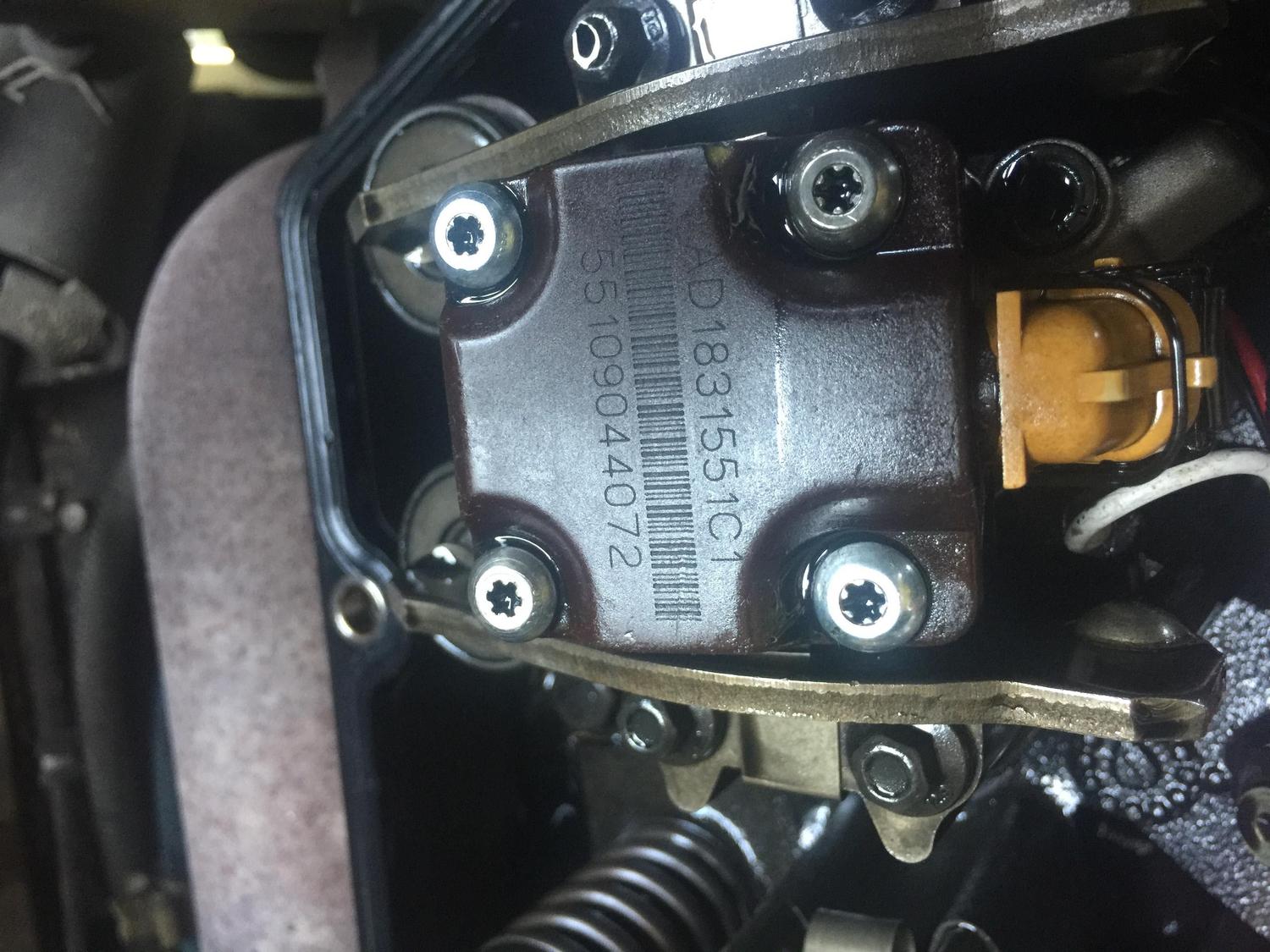

Hey guys, I recently purchased an E99 7.3 and was told it had aftermarket injectors. I pulled the valve cover as I need to identify what they are to get a custom tune written. Unfortunately the top covers of the injectors only have a Reman symbol and some numbers. Does anyone know how I would be able to determine what injectors are in the truck? (what cc) thanks

I'm not sure how the others mark them, but my P.I.S. injectors have engraving on the side of the hold down brackets.

If you can post a picture it would go far on this one.

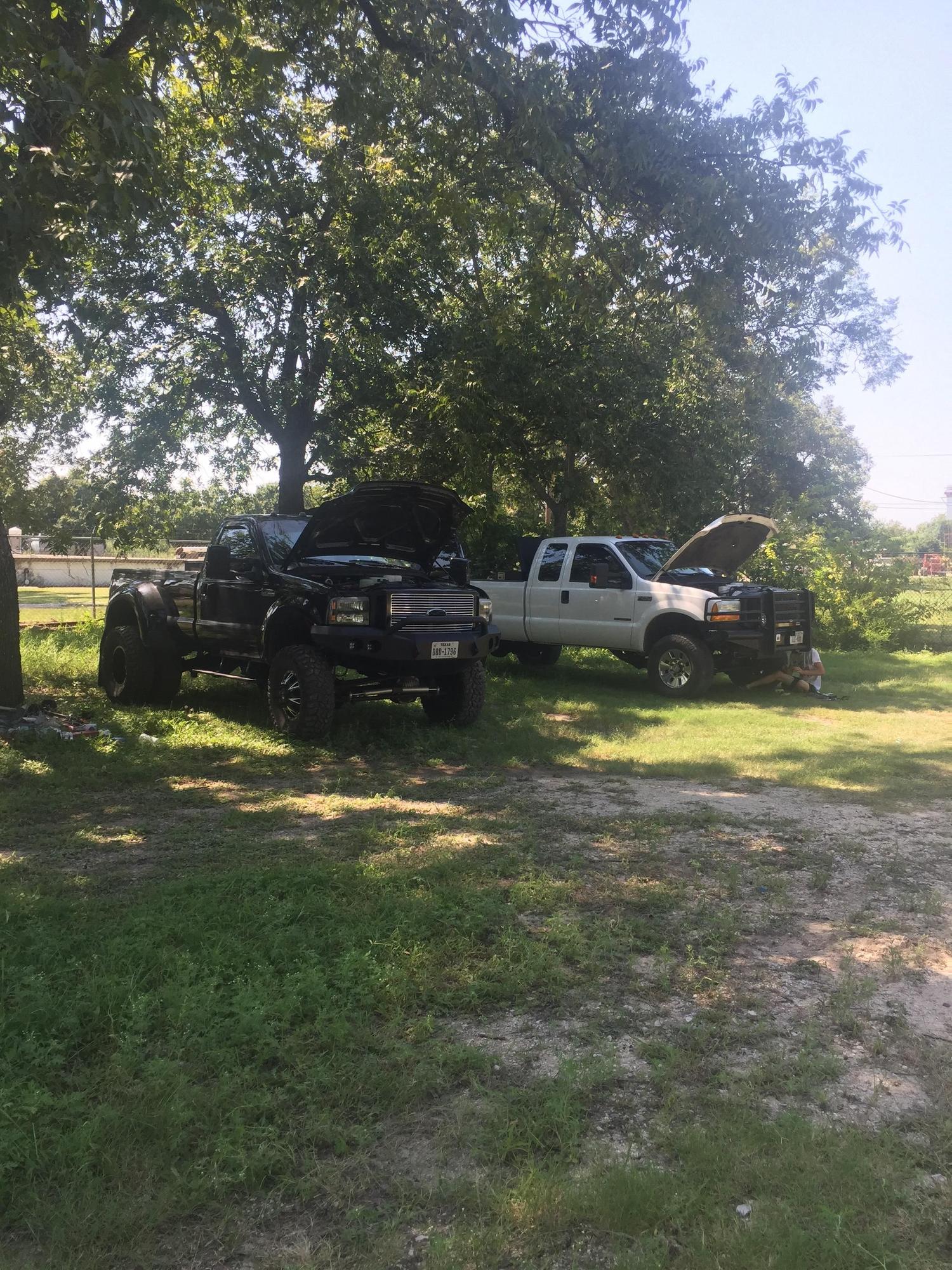

And here is where she is resting (the black one)

Most likely just stock L99-'03 AD code split shots. At least that's what's on the solenoids.
And a mismatched set at that. Looks like 2 OEM originals, and 2 different re-mans/replacements.
I say rip em all out, dump the split shots, and get a set of real injectors. You'll never get much performance out of those. There just isn't much reserve capacity left in the stock injectors, beyond what the factory tuning already uses. They are only 120cc.

Is that an oem '05-'07 Harley grille on the black one ( or an accurate aftermarket reproduction)? Can you please post some more pics showing the grille and headlights better? I'd like to get a better look at the grille, actually installed on a truck,to decide if that's the one I want.

thanks for the reply carguy3j, the person i bought it from claimed it had 140 or 150 injectors in it. It has GTP38R, lift pump, cam, s&b intake. Is there anyway they could be Remand but built? The truck will smoke quite a bit until the turbo lights when getting on it.

I'll post more pics tomorrow of the grille

Sorry. I mis-spoke.
Stock E99 injectors are AB code, and are 120cc split shots.
L99-'03 are AD code 140cc split shots.
So, the previous owner was likely correct about them being 140cc, but that is not a performance injector. Its just a stock L99-'03, and its still a split shot.
You want single shots. They start at 160cc, for new Alliant AC codes, found in certain International T444e engines. The next step up is an aftermarket Stage 1 or Stage 2. Do yourself a favor and skip the Stage 1. You might as well get larger then stock nozzles in the beginning, rather then figuring out later that should have bought them initially. Ask me how I know. Bigger injectors on stock nozzles lead to high pressure oil issues, etc... I would consider 180/80 or 180/100 as a good solid entry level performance injector. With the right tuning, those injectors should make 400hp
The truck MAY be smoking because it has the "wrong" injectors in it, at least for the programming in your e99 PCM. Or there may be something else wrong.

I second that it looks like a hodge-podge of 140CC AD's from 99.5 on up. If I could afford it I'd trade them all in for a full set but there are probably a lot of trucks running fine out there with a mix and match.

As for the injectors, they look like stock AD and not performance injectors. This is not to say that they are not "aftermarket", but definitely not a step up. Of course, they may be AD's with modified nozzles, but that is uncommon.

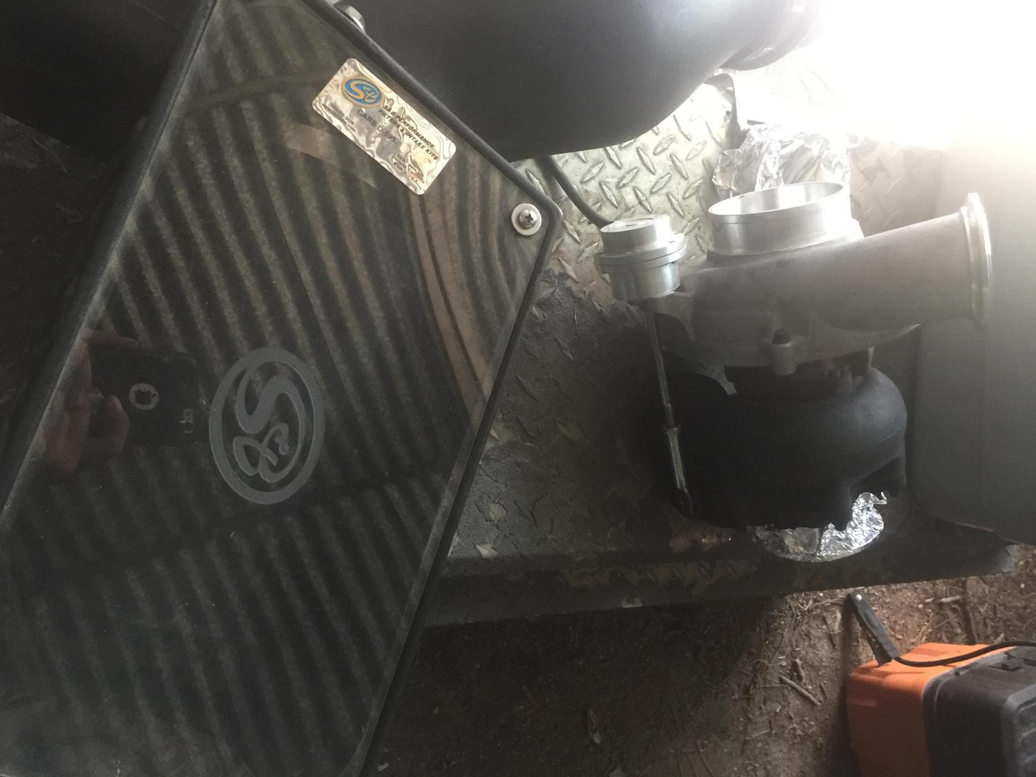

Sous, after reading your reply I looked up the KC38R and that looks like the turbo that’s in my truck! I thought it was the GTP38R but wasn’t sure. Il post a pic of my turbo shortly but it looks just like the pics of the KC38R!! Turbo identification was going to be the next thread of mine but looks like that will be answered here!

Turbo Pics
Turbo Pics
Turbo Pics

Theres no way of telling what injectors those are, why you ask? If they are reman they could easily use any type of solenoid like AA, AD etc they are all the same solenoid the only way of telling is taking the injector apart. Nice truck by the way I like the stance.

Unfortunately thats not a GTP38r theres no Garret cast in the comoressor housing.
