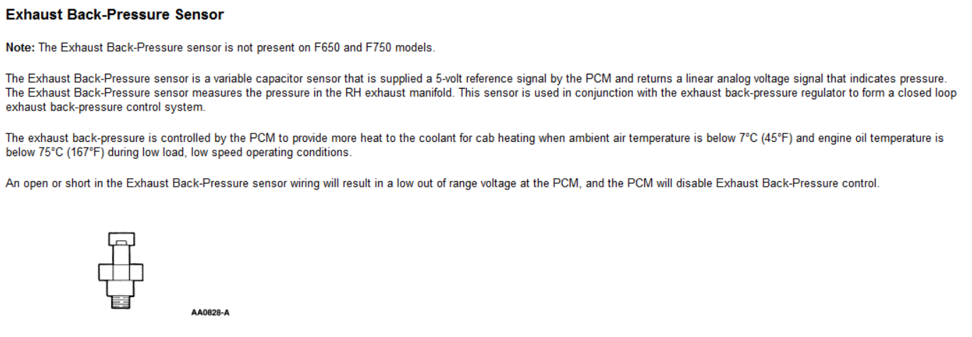

In addition to what Leonard posted above, please see the information below regarding the EBPS which I took directly from the PC/ED volume of the Ford Service Manual.

Both pictures linked look to me like the EBP sensor is only used for operating the EBPV and not for fueling? I’m probably missing something though

It talks about the "primary function" to measure exhaust pressure for the pcm to control the epr when needed. I couldn't find anything else other than setting codes such as a possible over boost.
