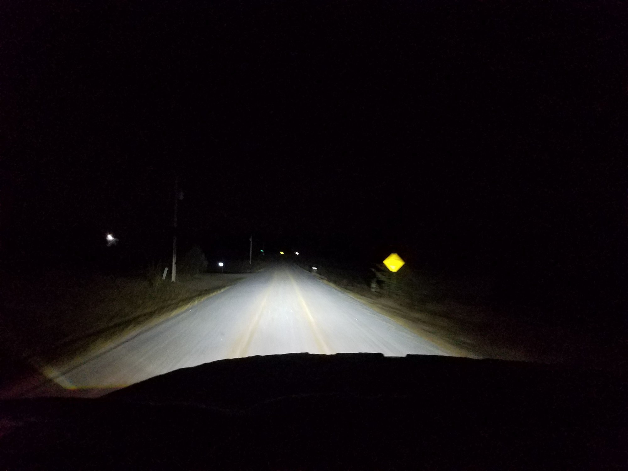

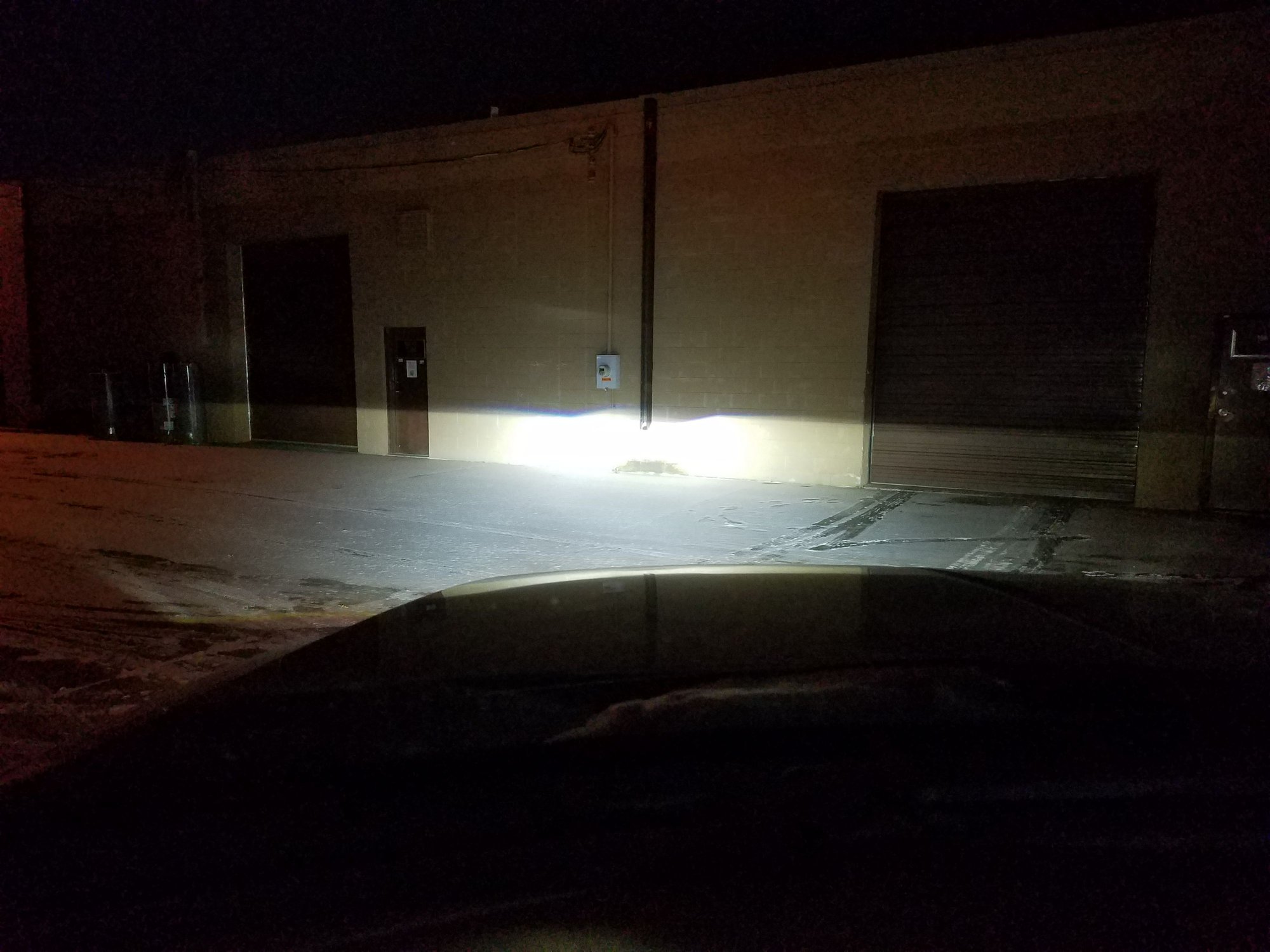

Do you have any images of the headlight pattern at night? I am considering my upgrade options and am weighing between the sealed beam conversion and a nice HID retrofit.
I did a Morimoto Bi-LED retrofit.
Cut-off at maybe 50 feet.
Low beam, slight up hill grade.

Thank you for the pics! Almost seems like a toss-up between the two (sealed beam JW Speaker and quality HID's) to me. Similar price points and the performance looks great from either.

I can tell you that they a bright. So bright that I made sure that I have them aimed properly.
The short version is that I used a laser level to determine the slope of the driveway (at the 4 tire location) made shims to get the truck level. then followed proper aiming guidelines. I'll get flashed now and again, but it mostly happens when I'm going uphill and an oncoming vehicle is cresting the top...or vice-versa.
All that said, I don't think they are any brighter than any new truck that sports LED's.
