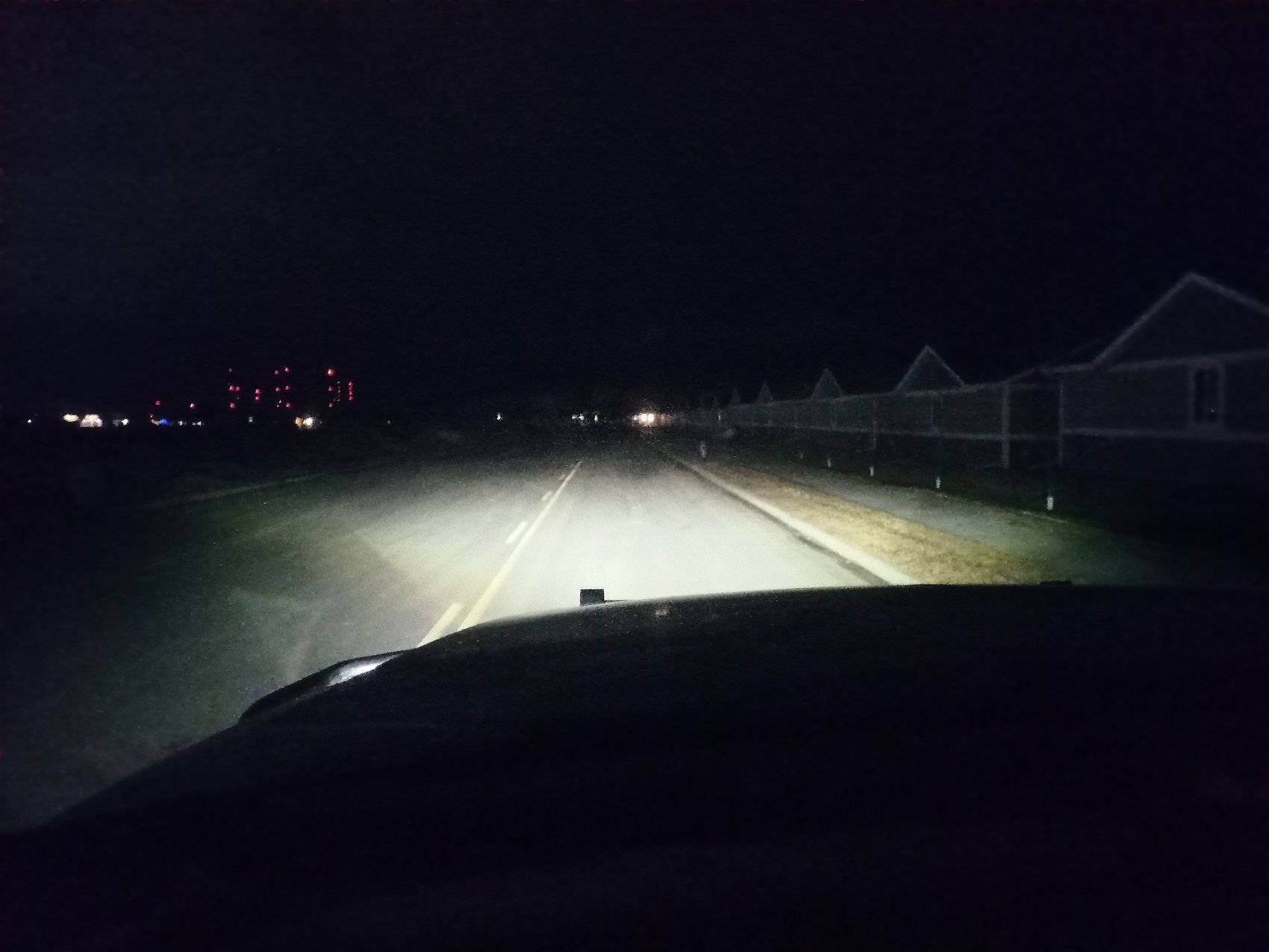

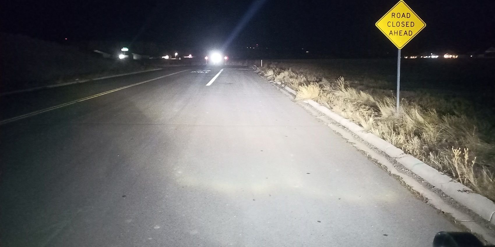

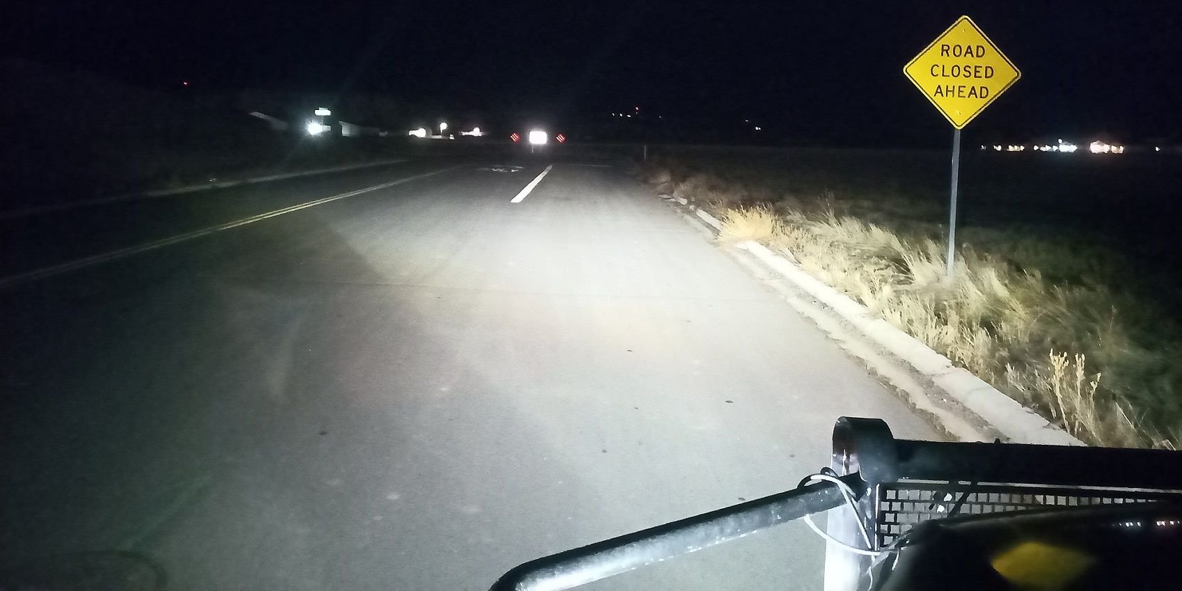

I almost don't want to post these as my pics don't do them justice at all. I'm not photo inclined and my phone has been washed in skydrol a few times. I couldn't even get pics of my new Hpop right in front of me a few days ago. The glare in the pics is from the phone.
So take that into consideration when viewing.
Lowbeam
Highbeam
Tried getting out for these to get past windshield glare, turns out its the phone camera.
lowbeam again
Highbeam again
2 Things I can see, some more adjustment is needed and I should consider getting a proper camera.

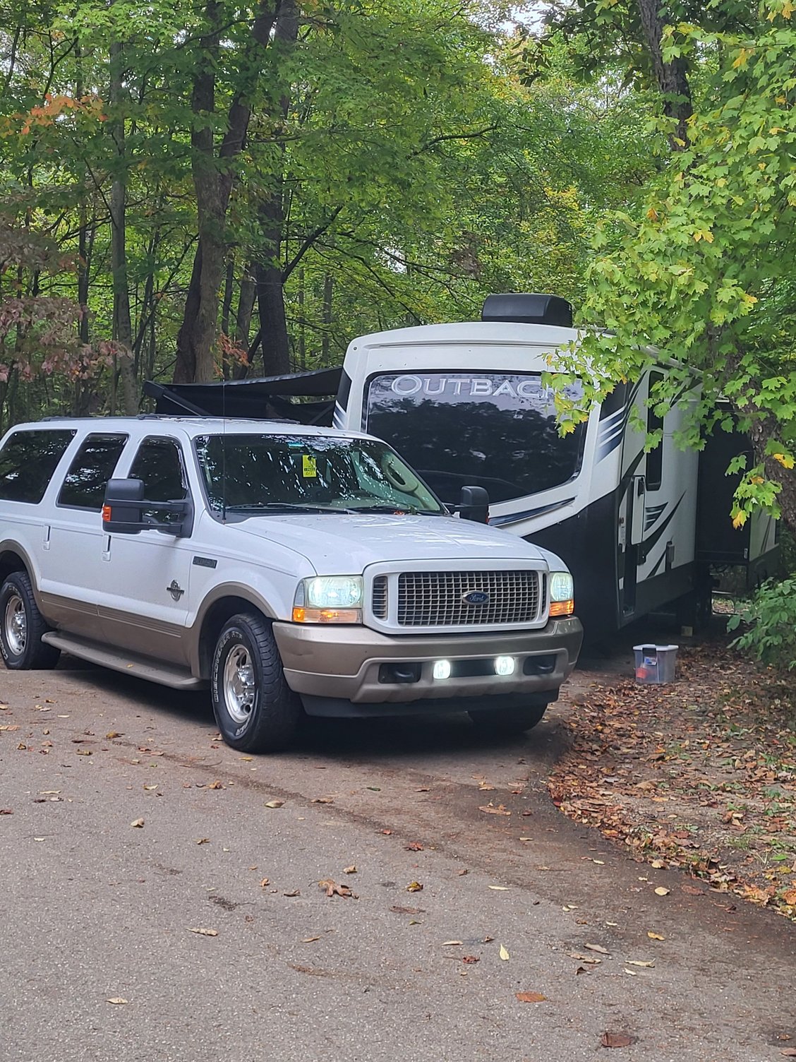

I just used stock housings with Beamtech LEDs off Amazon that are fanless and let me tell you, they are awesome! They have been in since October 2017 and havent had one issue. Have the matching 5000k LED fog bulbs to complete the look. I did all exterior LEDs (had to replace the flasher for LEDs) on the whole thing including running boards. Now onto the interior bulbs!

Driving down the highway low beam... picture doesn't do them justice. Can see over 1/4 down road on high beams.

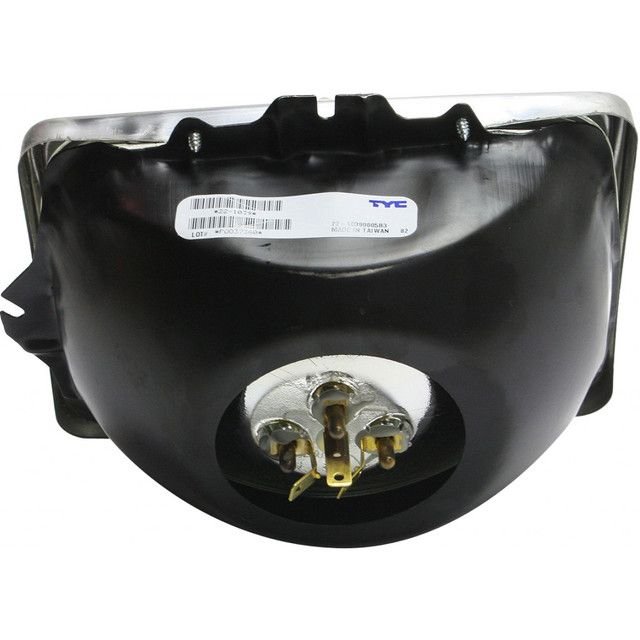

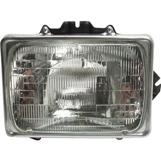

Yep, 8910.
9004 or 9007 to H4 wiring harness adapters. plug & play but one of the adapters I used had the hi/low reversed (thanks amazon). It was a simple matter of swapping the pins around in the plug.
A hard part to source was the metal housing, part 4 in the image at the link. That has a right and left and clips onto the adjusters. I just felt the ford price was a bit steep.
https://parts.lakelandford.com/a/533...ME99035.html#2
I ended up just getting sealed beam bulb assemblies from a box store, both bulbs came with housing and hardware for about the same as one from ford and swapping the LEDs in.

The JWspeaker lights we're talking about are leds being swapped into the old-style housings. Among the parts needed are the metal bezels that retain them and the bowls that go behind the bulbs and attach the light to the adjuster screws.
For some odd reason, Ford will at times charge more for just one of these than it costs for both complete bulb assemblies. It was cheaper at the time I did mine to just walk in and buy a pair of halogen assemblies and swap the parts over.
In any case, this isn't the cheap option as it is a full conversion from stock to sealed beams. It doesn't have to be expensive, but it can get there pretty quickly as there are quite a few parts being replaced.
Overall brightness isn't so much a concern as the beam pattern and cutoff. Getting light where it needs to be at an angle that isn't blinding other drivers is worth far more.
What I am unable to show in pictures is the beam pattern gives good coverage of the road ahead, and illumination of objects out in front without needing to be aimed so high & wide they glare oncoming traffic.
The bulbs I have chosen do that for me well enough that I almost forget I have high beams because I so rarely use high. I gotta say though the heating elements are my favorite feature.
