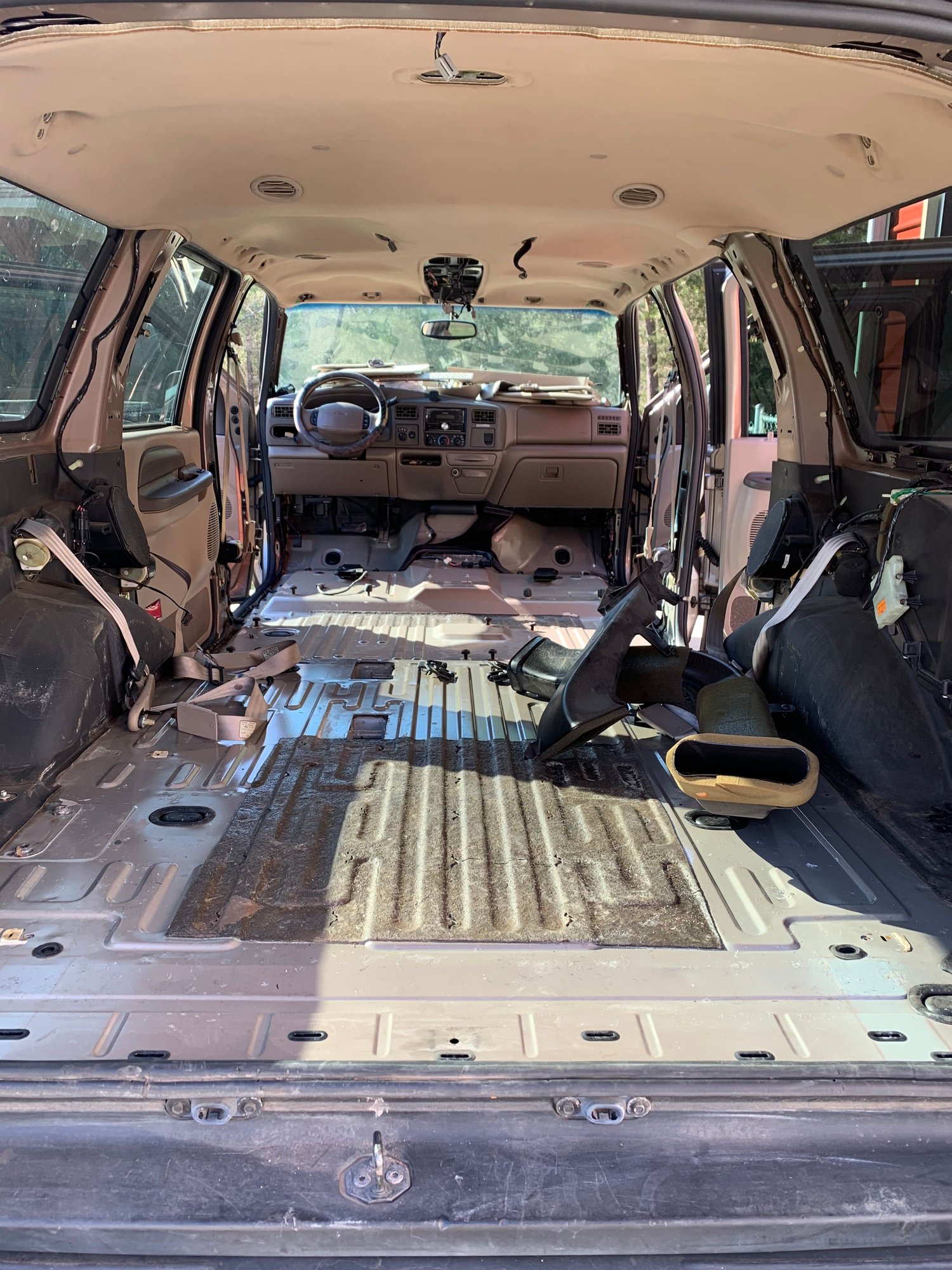

Here are 2 pics of the V10 I stripped to clean everything, the 3rd row speakers are visible.

I believe that they are 6x8 speakers, the same size as in the doors. I replaced my door speakers with that size but I did not replace my third row, however looking at the photo posted I would say that was the size, BUT that is just an educated guess.

Subscribing! Post up more pics if you can 01_EX, that tear-down looks pretty thorough.

I just posted those pics for him to get an idea of the speakers. I no longer have that V-10, I bought it from the dealer as an abandoned vehicle needing a transmission, I bought a Ford reman tranny, installed in my driveway, made some other repairs, cleaned the interior,made some interior improvements, and decided I no longer needed it. Look for my current thread on my 7.3.

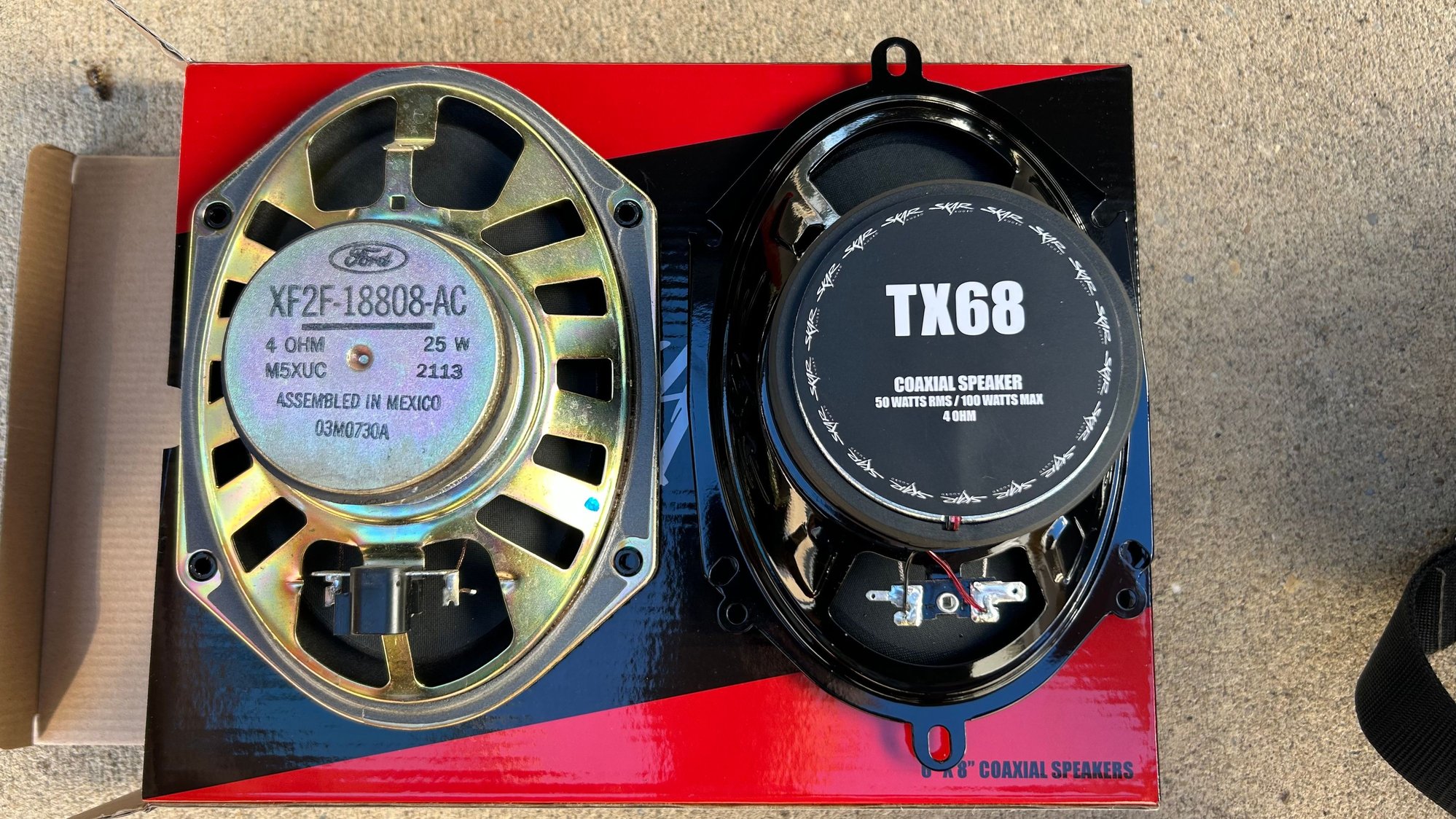

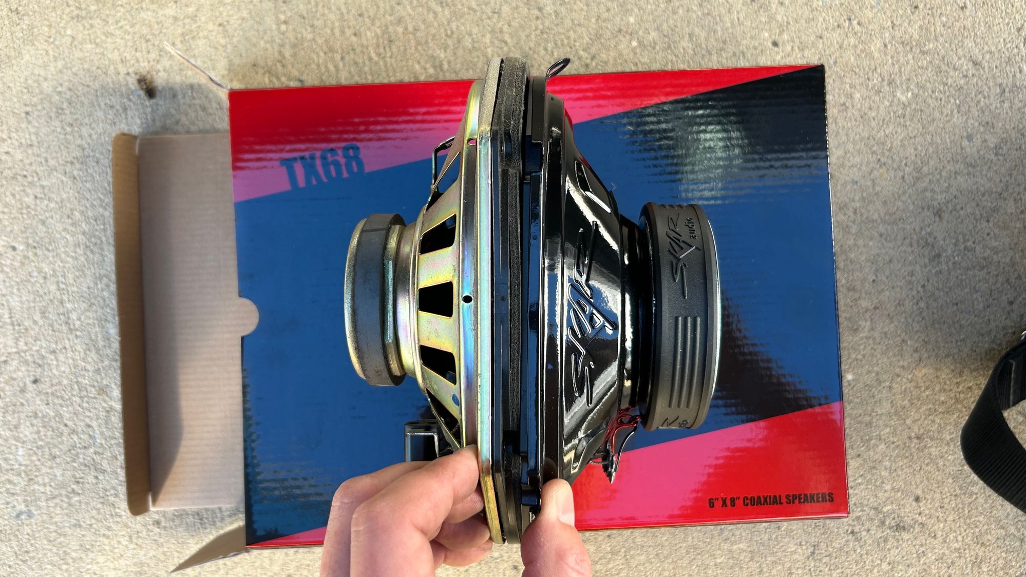

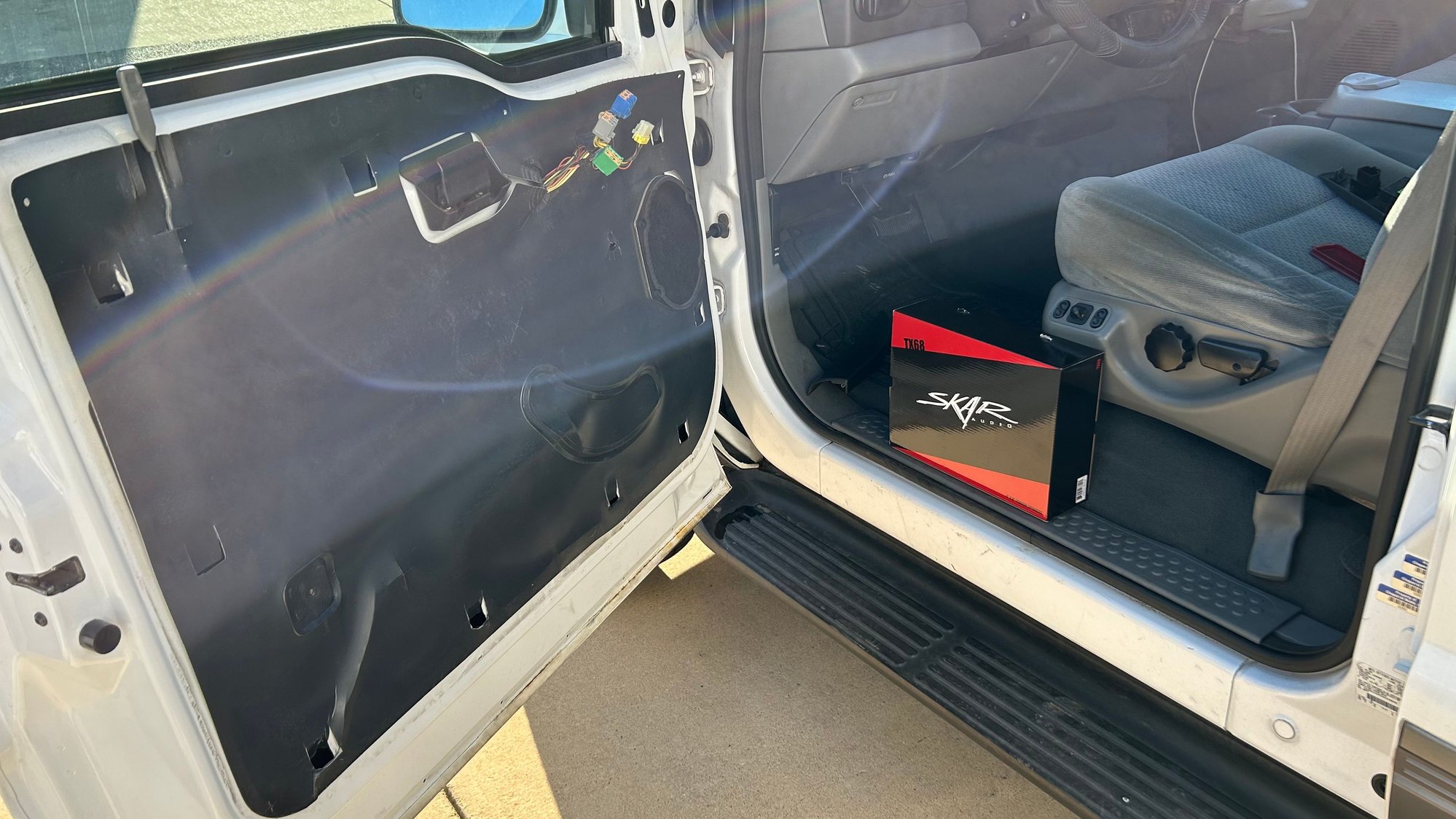

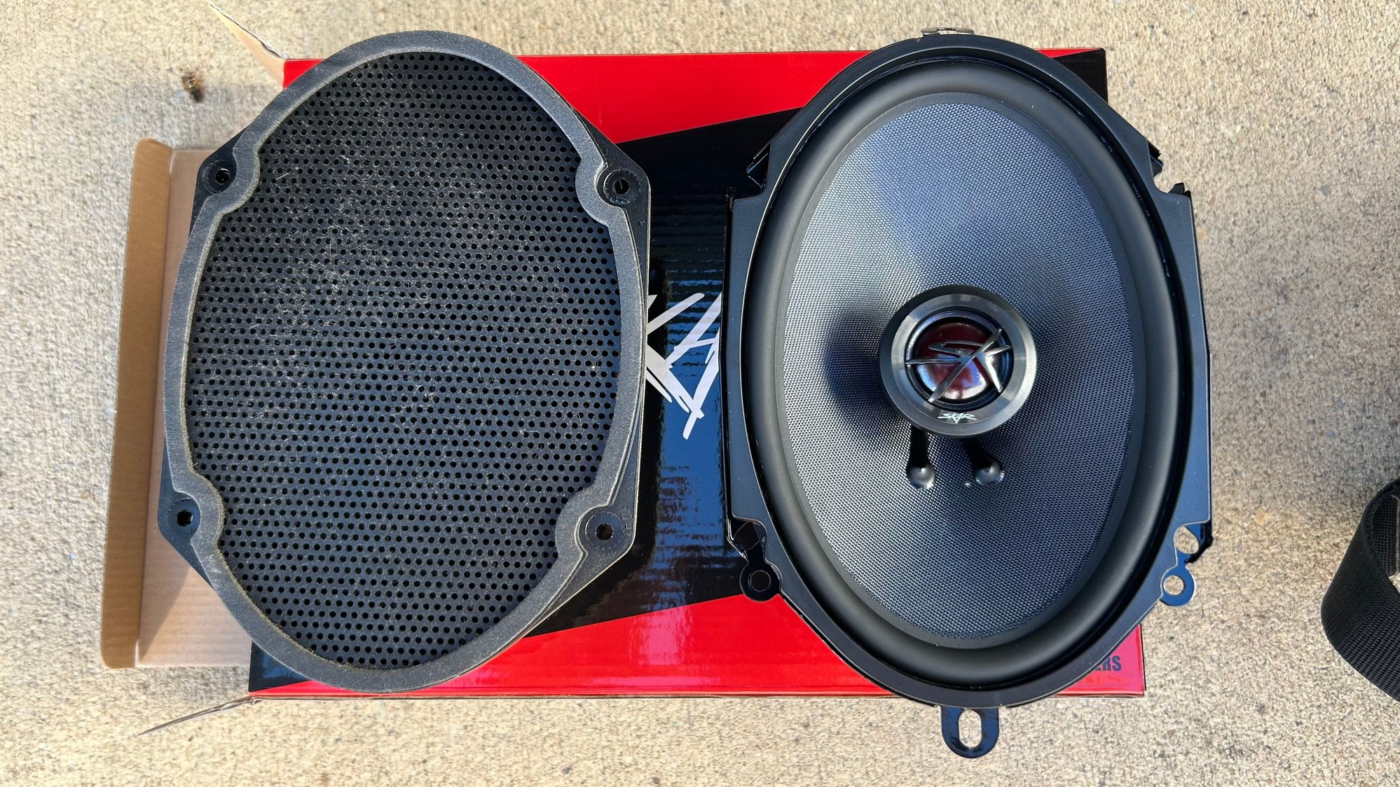

I just replaced all 6 speakers and they are all 6x8's. I have heard of people fitting 6x9's, but I wanted a direct replacement. Skar TX68's sound amazing compared to stock.
To answer OP's question, of course 8" subs will fit....with enough dedication and fabrication. Oh, and the money thing.
