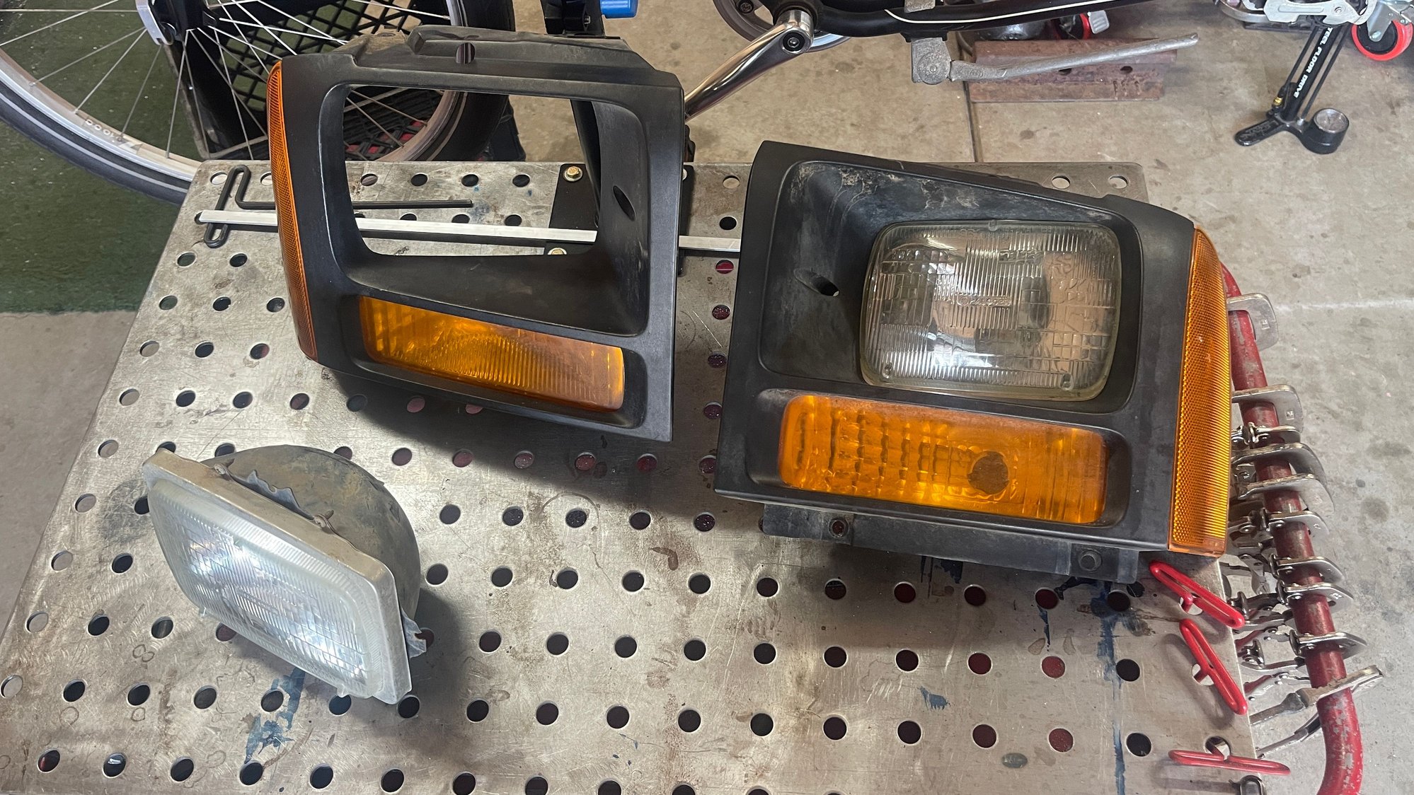

i am in the process of doing the 5x7 swap using the hardware off a 06 f250 xlt.
You can use 99-04 f250 but if you look close the 05-06-07 use a one piece cover.
the 99-04 uses a separate blinker and side marker.

99-04 2 piece trim

Doh…. Pic didn’t load.
2005-06-07 style

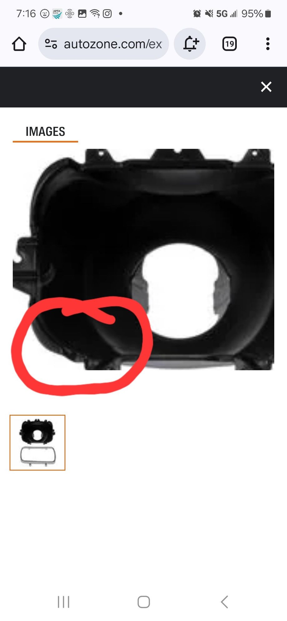

I am doing this same conversion. I got the parts from a friend who works at a ford dealership. They do not have a diagram how the parts go. Do you have a picture of where the spring goes and the direction of the anti-rattle clips? The adjusters are self explanatory. I just can not figure out where the tension spring goes. There is no spring tab like there is on most headlight buckets.
Thanks in advance.

I didn't take pics when I did this mod but if memory serves me correct, there's a lip on the oem buckets (circled in red on these Dorman units) the spring hooks onto and then over the the designated squared hole in the header panel.
