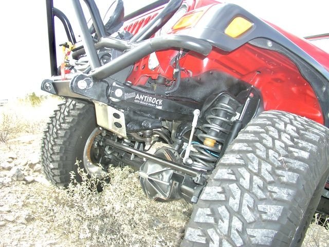

Not really…50 years of off reading around the world. There is a better solution. :Currie Anti-Rock!
YES for years we disconnected that swaybar…finally a better solution!
