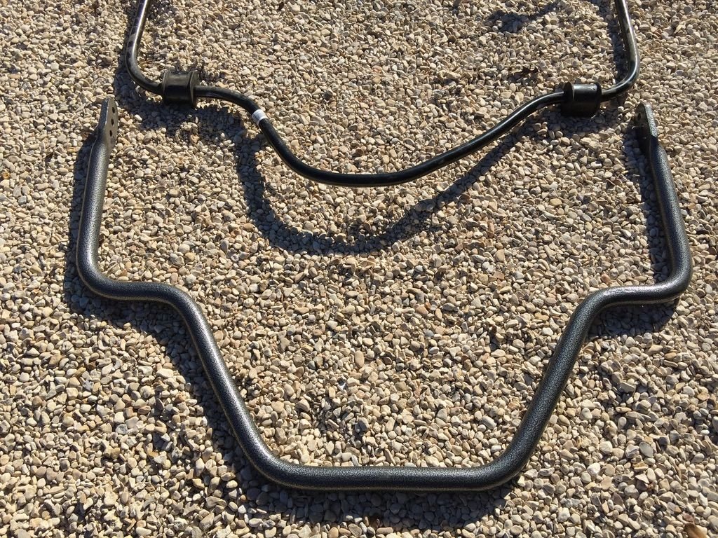

Prob a toss up at that point. By its self your camper even loaded is going to below 3000 lbs but add in your car trailer and you might want to take the BIG Wig, but for certain you need more than OEM.
That said the bigger the diameter of the sway bar the harsher the ride...which is the prime reason why American cars run smaller swaybars. I personally detest the soft spongy ride of US cars which is why I beef up the suspension with larger F/R swaybars. So a lot is riding on your driving habits and how soft you want that ride. The Big Wig is an adjustable swaybar so you have some flex.
OEM Vs Hellwig Big Wig
