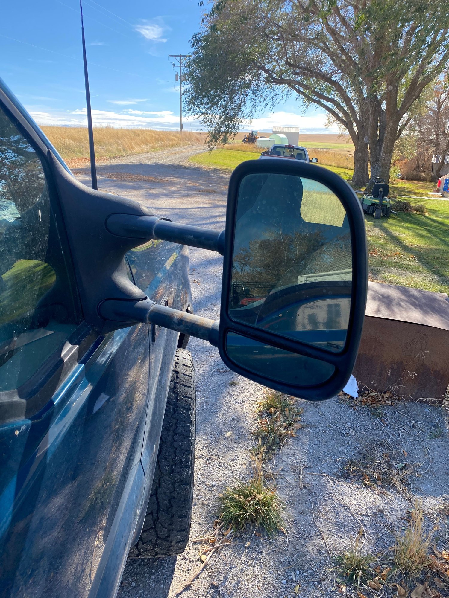

Just blew it my passenger mirror I can try to get a junkyard replacement or a pair of the box style on Amazon. Cold it be possible to make my own 12v system with relays, mirror switch and convert to the power rotor style ? My truck is a xl vs tracking down the wire harness etc.

@Shovelheadrob has some really nice power-everything mirrors that he wired up himself.

I put 17+ style mirrors on mine. There power hear market lights puddle lights the whole nine yards. My truck was also a xl and I added power doors and the mirrors at the same time. It wouldn't be hard to add power mirrors. Doesn't require any relays. Just some wire and a fuse pretty much.

I put 2008+ mirrors on my truck, but if I could do it over again I would definitely go with 2017+ mirrors like Tpayne621 and many others have. I still might swap out the 2008, but I'm stubborn at times.
@ESwift has some full power mirrors too.

Thank You for the replies. Somehow the mirror is still attached lol. Found a junkyard one to swap in just have to go get it. This will let me take my time and choose a set that I’ll be hopefully happy with long term instead of rushing around.
