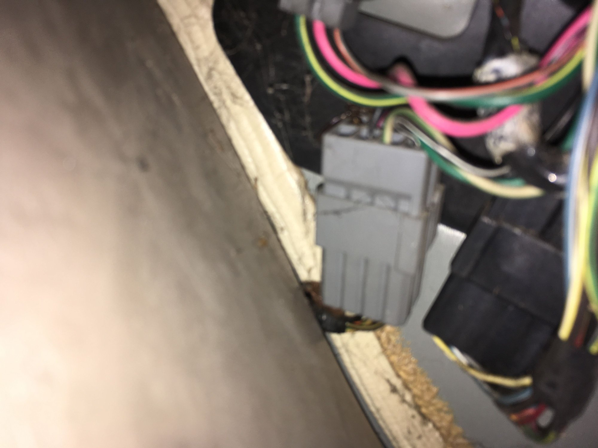

There is no rhyme or reason to what wiring Ford put in these trucks. GENERALLY, there is no ‘extra’ wires that allow things like RKE and overhead console. But, I have seen exceptions.
The harness that that goes to overhead console plugs in on passenger side kick panel and goes up that a-pillar and across the top of windshield to the console. I have a 2000 here with overhead console, I’ll try to get a pic of the pigtail in kick panel later.

I think it’s one of these (2). My best recollection is the grey one... It will go from here up to the console. There is an unused grey connector similar to this on this truck with overhead console and lie-o-meter.
On edit: the wire bundle goes up passenger side a-pillar.

Thanks SkySkiJason, Next opportunity I get, I'll open up the kickpanel and see what's hiding in there.

Just opened up the passenger side kick panel yesterday afternoon. There are several plugs there, but only one black plug that is not in use. No wires running up the a-pillar. I guess if/when I get my hands on a console, I'll just have to make sure I get the wiring harness that goes to the kick panel as well.
