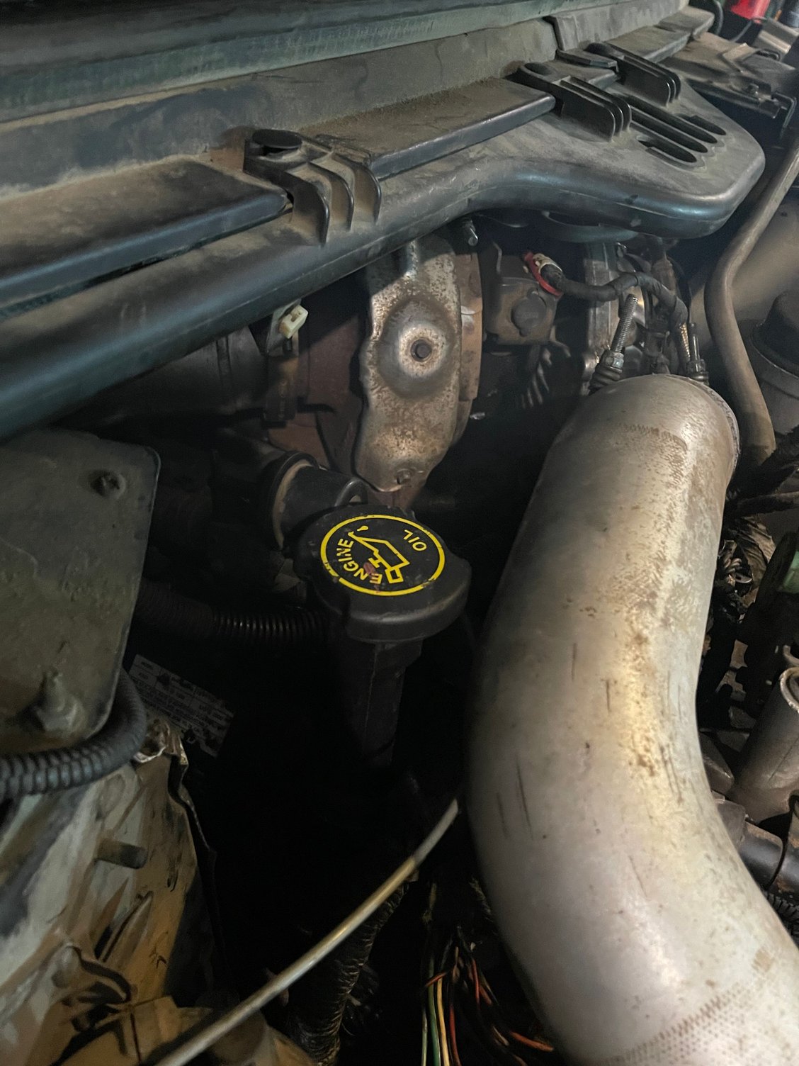

Originally Posted by bismic
Back to basics - lets see a picture of your oil filter cap.
There she is!
So I got home and tried to start it, 5-6seconds and it stumbled to life. Gave me a P0284 code, then turned it off to see if it would start again, it’s did after 7-8 seconds of cranking.
Here is a video of it running when it’s been running for 10min or so after being cold. I cleared the codes before I restarted the second time and got a P0266 #2 contribution code.
Im beginning to think there is a little gremlin in there..
File Type: mov

Wasn't a pic of the oil filter, but it did show the EDGE of the FILTER in the background. Looks OEM I guess.
Next , IMO you need to see how many seconds it takes to fill the oil filter housing when cranking. First with the filter housing drain valve closed (depressed), and next with it left open.
FordTechMakuloco shows the filter housing drain valve at about 4:10 in the video below:
Pull the FICM relay when doing this test, or crank with the starter solenoid jumpered. You can see the process on using the starter solenoid jumpered to the passenger battery terminal at the 40 second mark in the video below:
This of course assumes that you still see no base oil pressure on the dash gauge.
