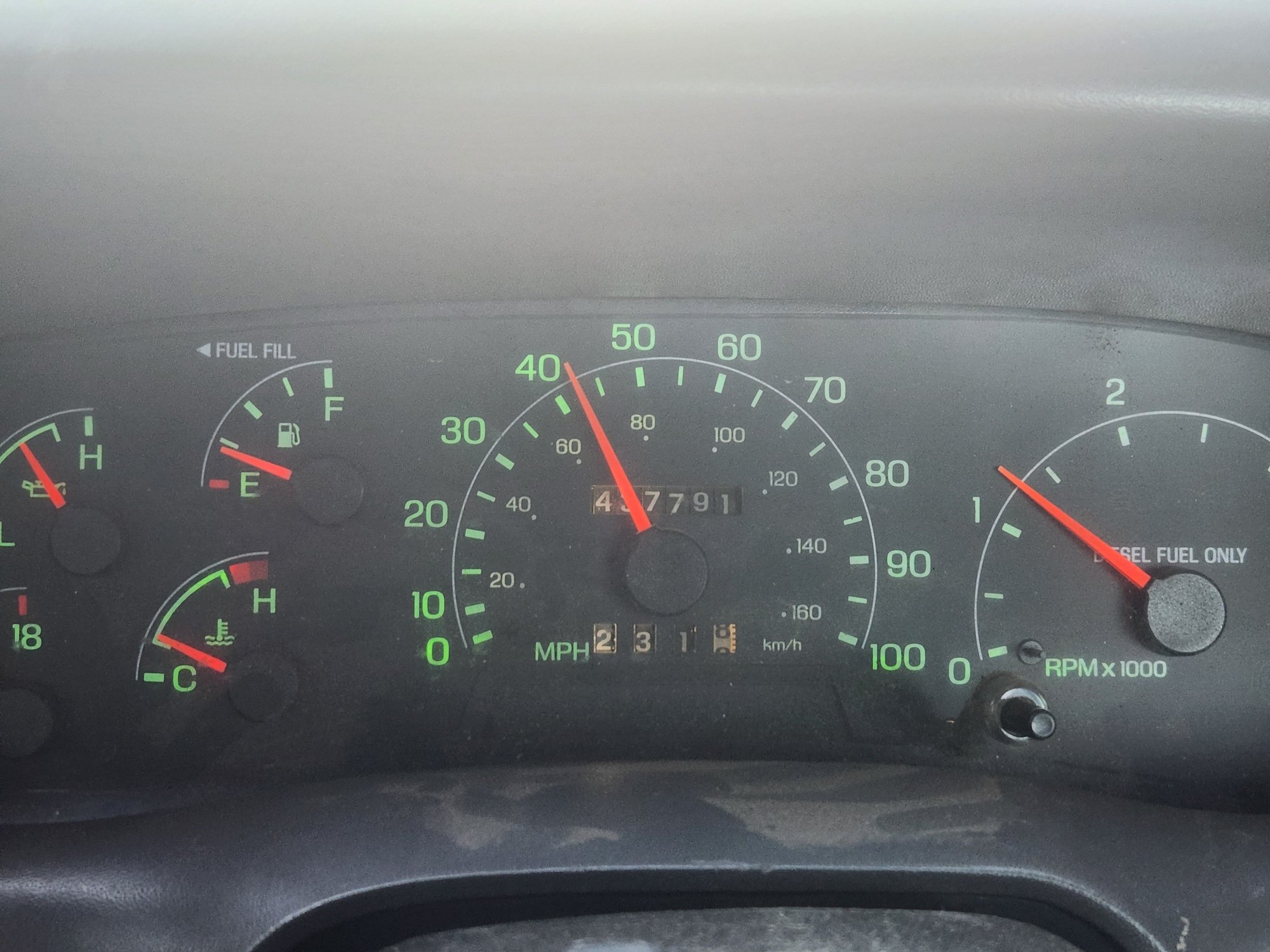

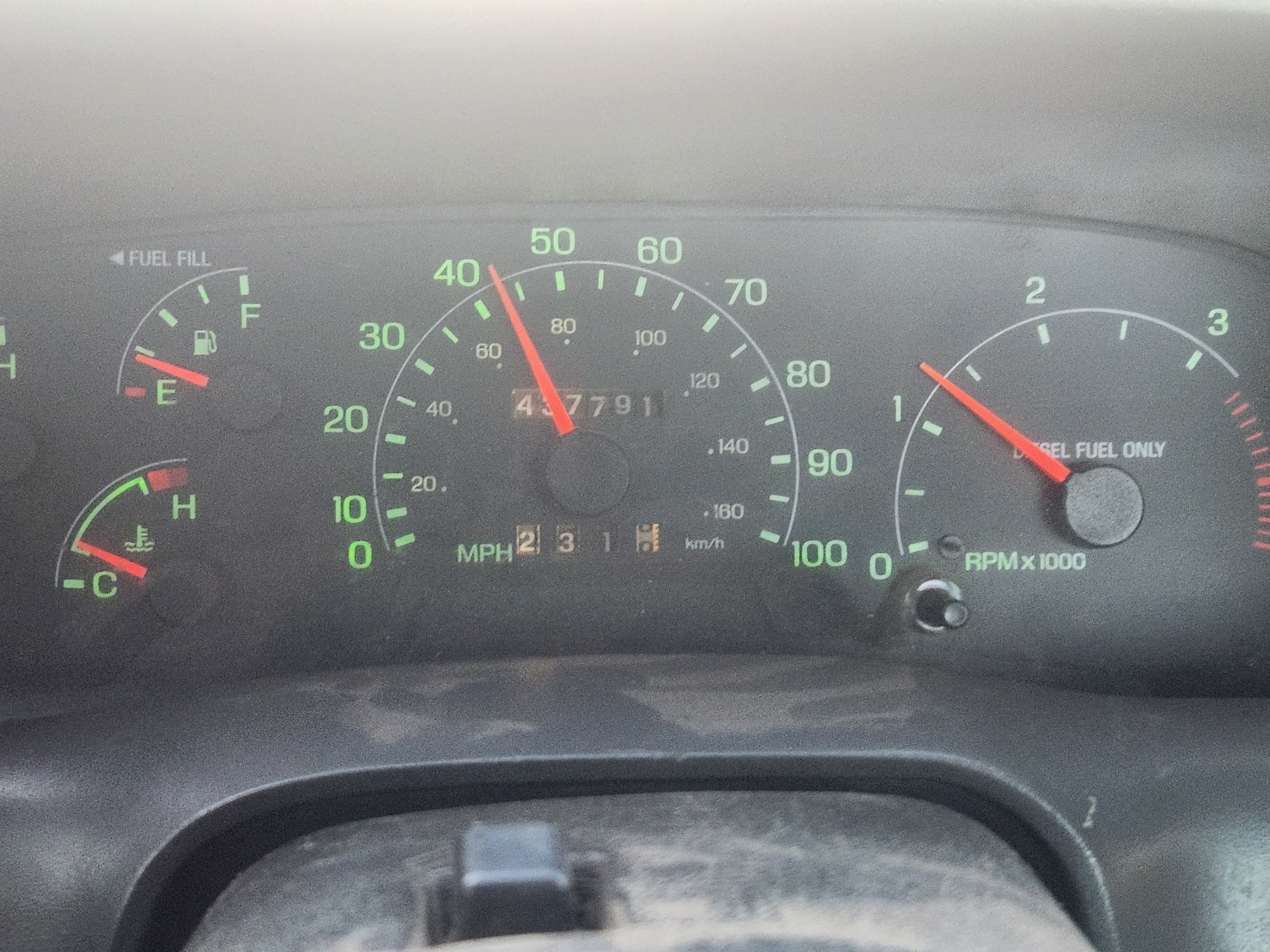

And also, I usually shift into OD at 45. Which puts me just shy of 1500 rpm. It's hard to take pictures while driving with all this traffic but I took a couple. All of these pictures are in 6th gear.

Tristan, that is way too low to be shifting into 6th gear. When towing, I shift into 6th gear at 65 MPH. When unloaded I shift in to 6th gear 55 - 60 MPH. If I need to accelerate at a slow pace, I will leave the truck in 6th gear. If I need to accelerate at a quick pace, I shift into 5th gear and roll on.
I get no smoke at 1500 RPM and getting on the fuel, even while towing. I also know for a fact I have no boost leaks (boots, etc) and no exhaust drive pressure (up pipes, etc) leaks. So, all of the performance the fuel and throttle pedal are demanding is there as it should be. It is still a 266,000 mile and 22 year old truck though, so I treat it as such and it treats us well. Even in WY at 9,000 feet elevation towing our 5th wheel.
While towing I like to shift ~2800 RPM, but will sometimes kiss or go slightly above 3000 RPM if I am on an incline onramp or something similar.

Try shifting at 2500 to 2700 RPM. Especially if you’re gonna go into overdrive. I think you should also see if you can digitally check your RPM via obd2 port reader what I found is that the dash generally shows 75 to 100 RPM more than it actually is happening, do to the discrepancies in attempts to read a very vague cluster gauge
Your previous method of driving and shifting is definitely way too low in the RPMs at least in my opinion you can hear it in the truck it doesn’t like it

You also need to take into account your larger tire diameter

Even unloaded and normal driving I should be shifting at 2500 rpm and up?
ok, I checked my RPM via forscan. It varies depending on what RPM I'm at but it's generally off between 65 and 80 RPM.
Does this also mean I can't be cruising at 55 in 6th? 55 is the speed that most of the roads around my area are and I sit at around 1600 RPM when cruising at 55 in 6th.
I had no idea I was shifting too early for unloaded driving.
The truck does seem a lot more responsive this way and the smoke is almost negligible. If I stomp it it's still Puffs a little bit even at the higher RPMs but it's mostly Gray instead of thick black.
So I need to be shifting at 2500 most of the time?
