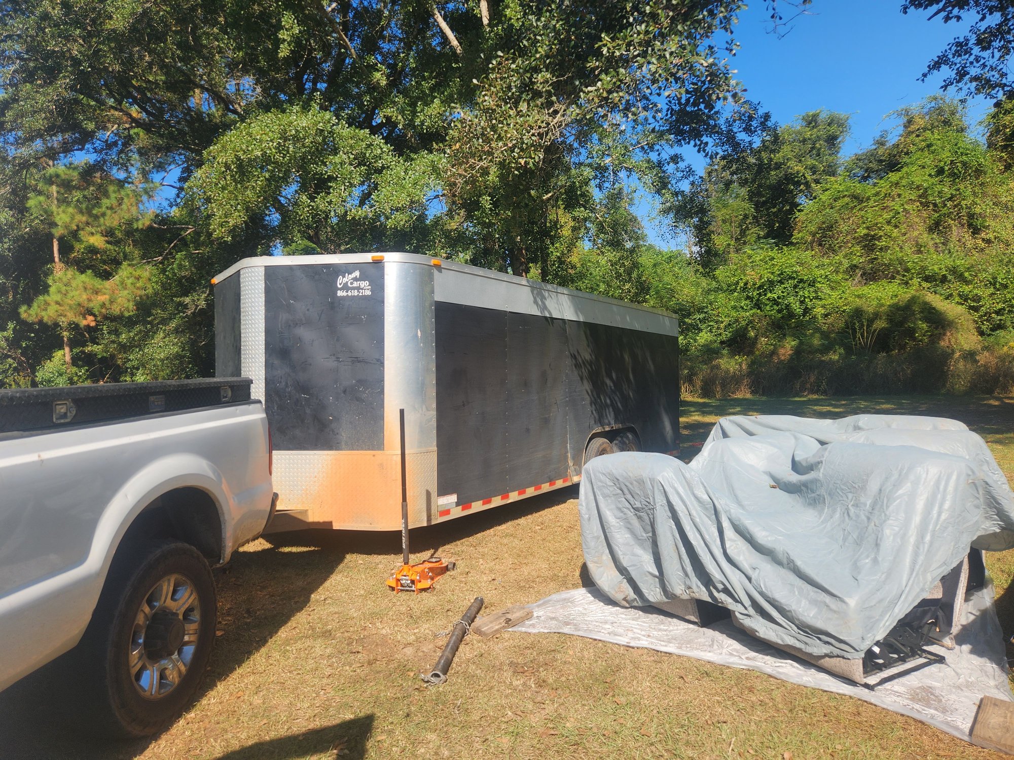

I finally bought my new to me 26 ft enclosed trailer. It is 22 enclosed 4 ft tongue so 26 ft total. I've already been working on it a good bit, I got all the trailer brakes working and fixed all of the lights that were rewired by a ding dong, and I mean that respectively cuz I happen to know the ding dong, what else is funny as he said the trailer rides too low. Well, while servicing all of the brakes, turns out the equalizers in between the leaf springs are broken in half and the leaf springs are riding on the frame! And they're not physically broken, they've just been worn by the bolt clean through. I'll post pictures later when I get off work, but for now here's a quick shot I took before hopping in my truck.
