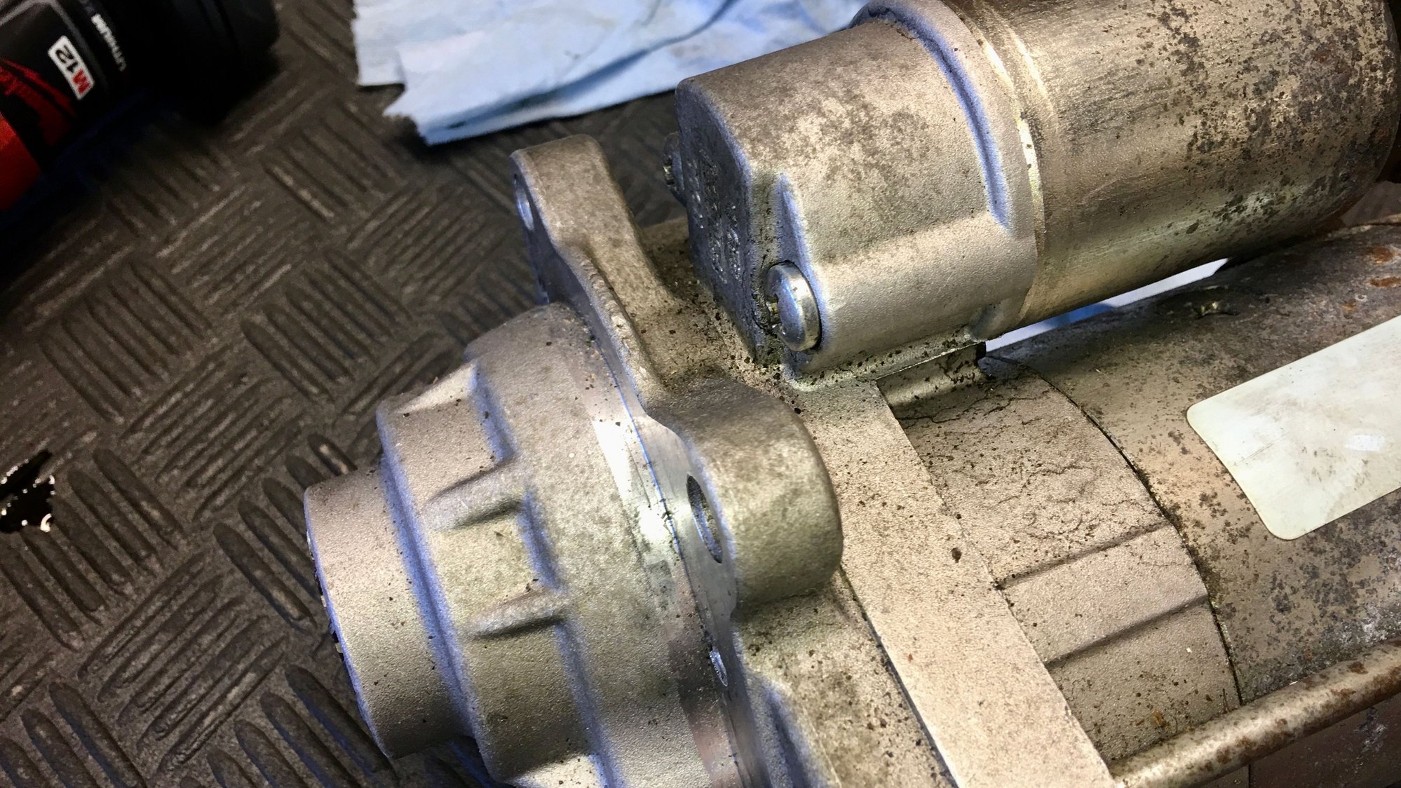

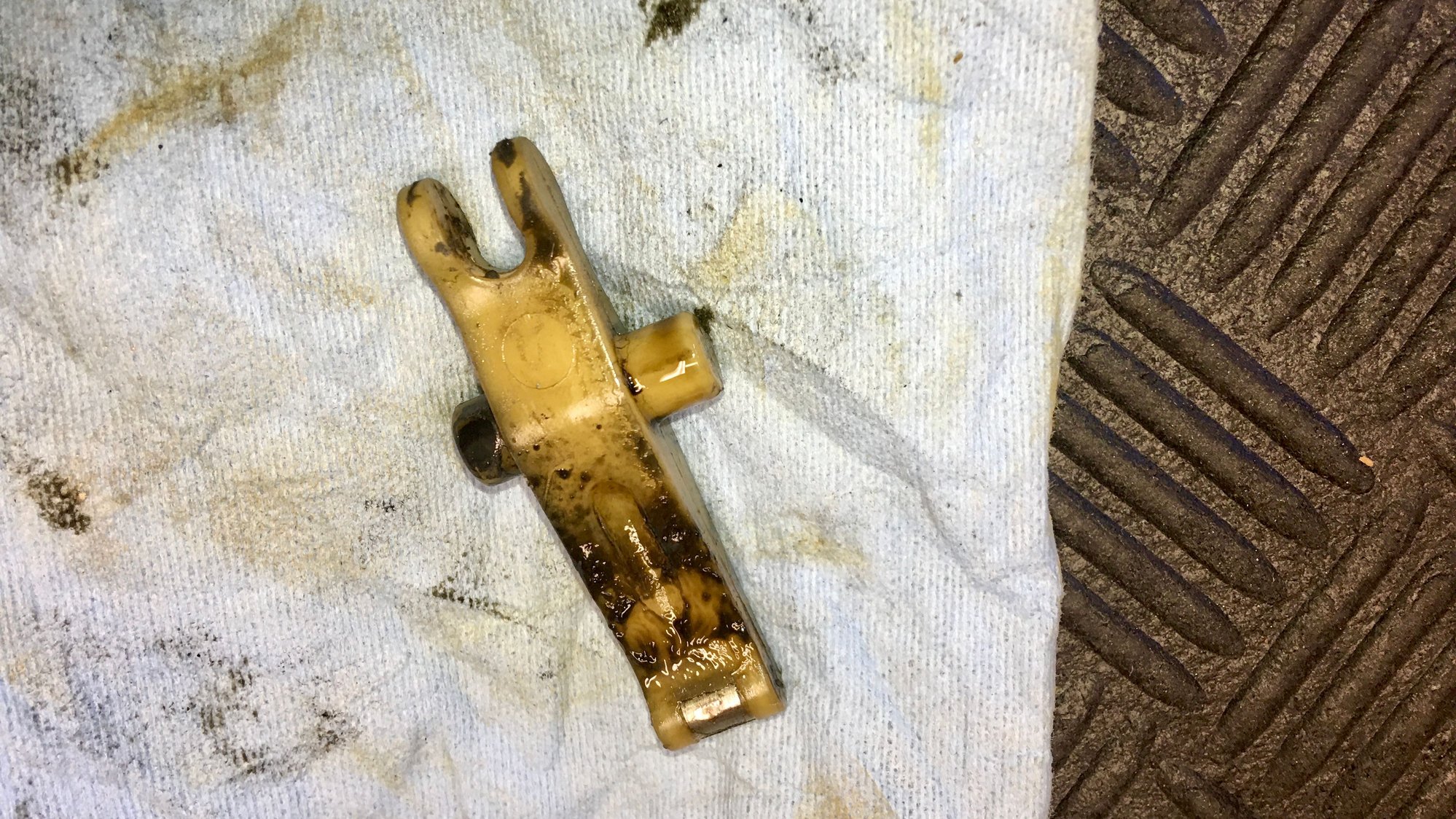

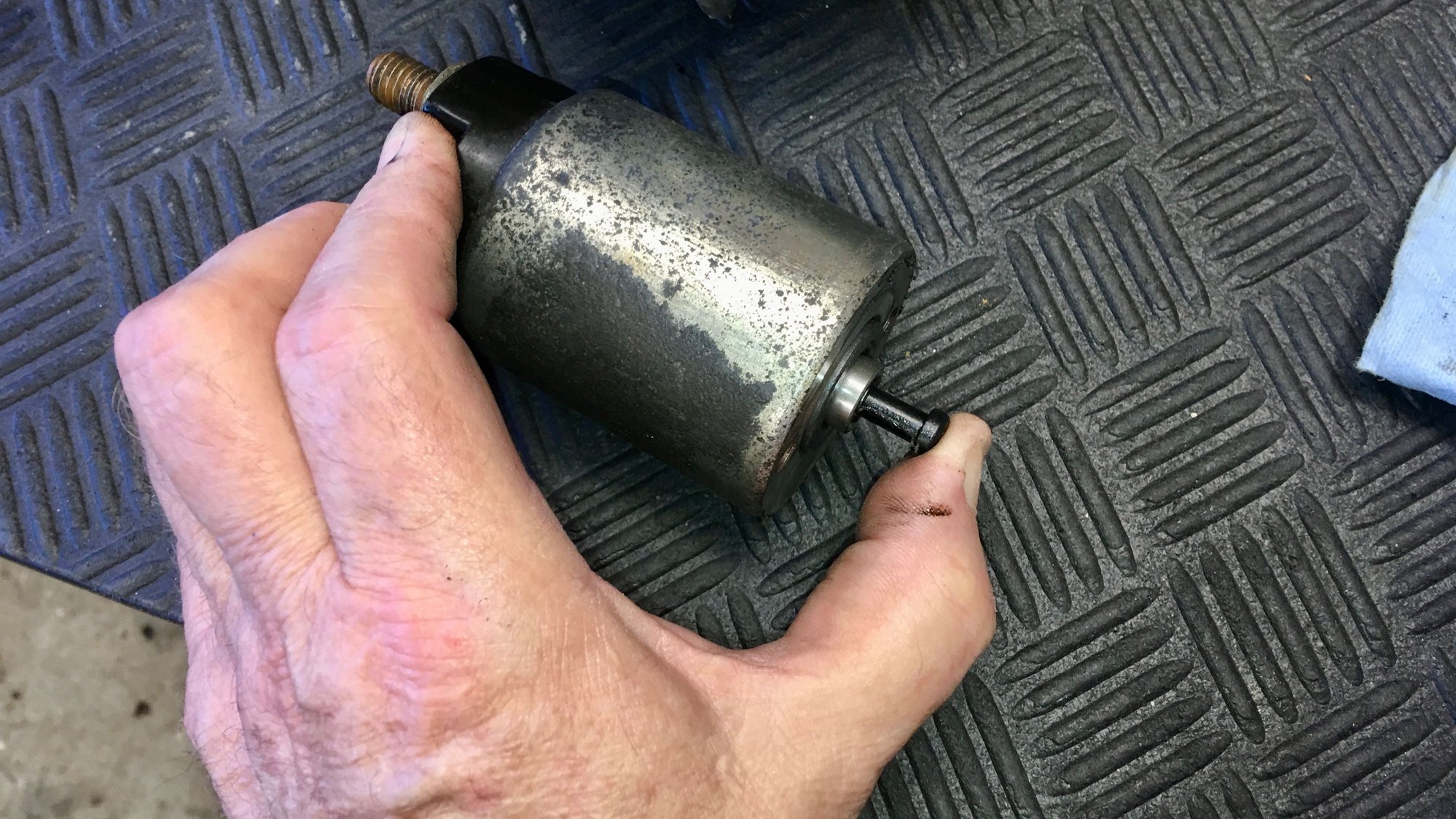

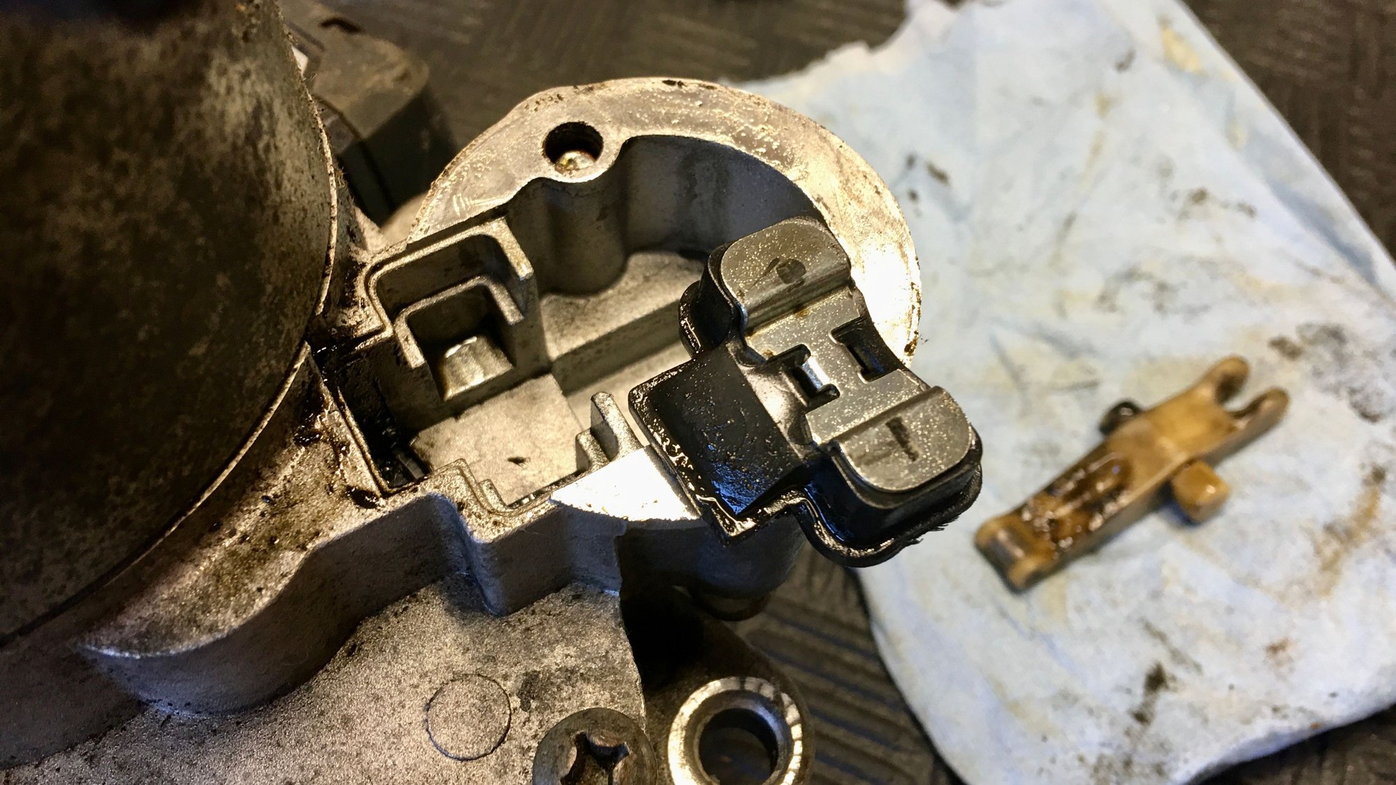

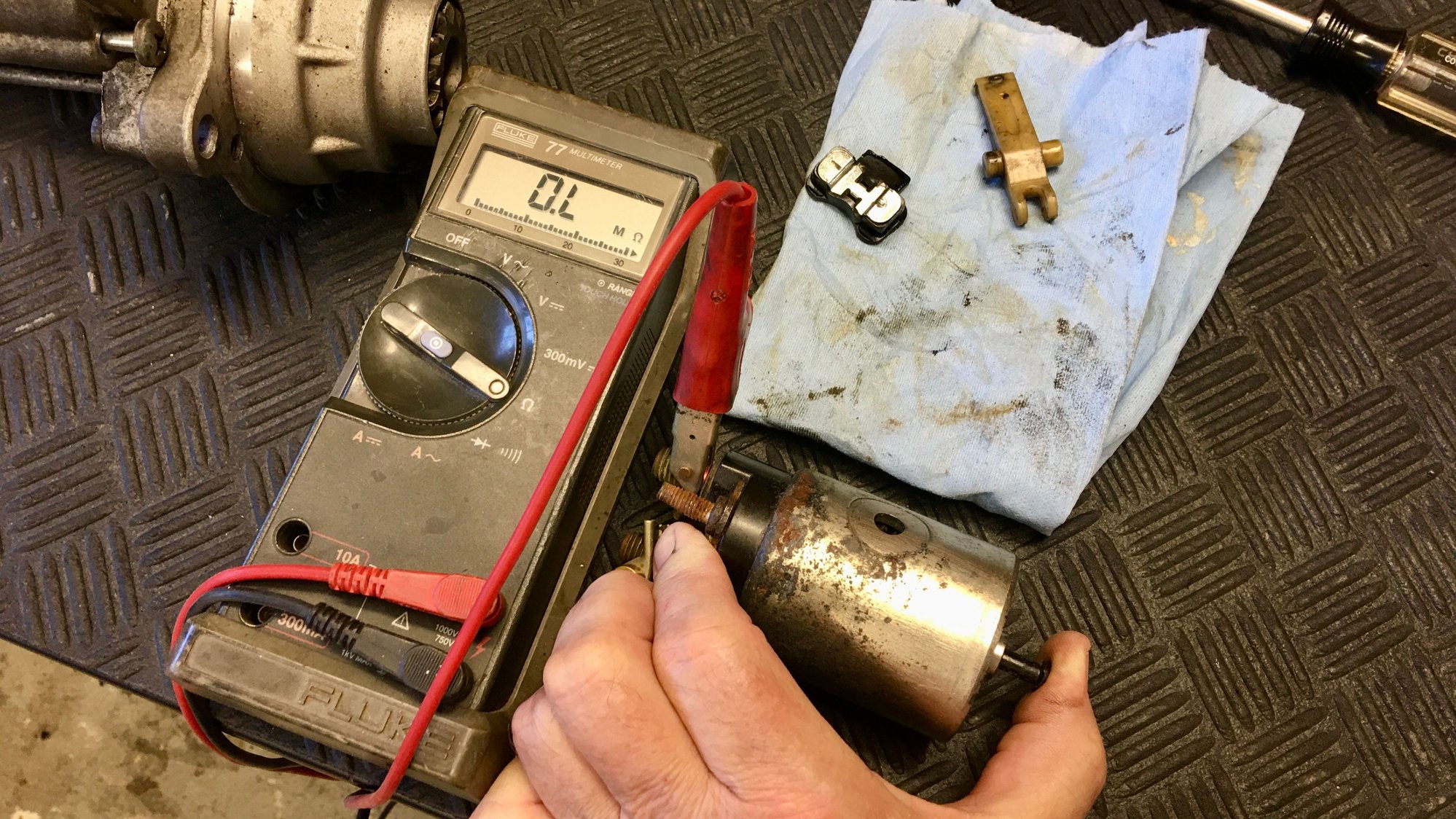

If it's spinning, the contact in the solenoid has to moving all the way.
I partially took my reman 6.4 starter apart.
The piston that pushes the gears forward.
The lever that pushes the piston forward. Nylon with a steel insert to push against the piston.
Fitment onto the solenoid.
There only is continuity to the starter motor when the solenoid is fully pulled in. So if the starter motor is running, the solenoid has to be moving freely.
So if the starter spins, the solenoid has to be fully engaged.
The rubber plug and metal insert is the pressure side of the levers pivot shaft.
Replacing the lever requires you to hold the flywheel engagement gear in the extended position.
While the plug is a loose fit, it is held in place by the solenoid.
For the lever to have excessive clearance, the screws for the solenoid would have to be backed out.
So maybe the solenoid is loose, or the pivot parts are worn.
Another possibility is an issue with the windings, but that would be the starter motor does not run when the gear is extended and engaged when hot, not enough HP. Hartwig hasn't stated if the starter "stalls" when hot, but has said it spins.

I had a 6.4 starter fail and when I took it apart, the white plastic pawl in Jack's picture was broken. I was fortunate that it happened in my shop, I now carry a spare starter and alternator in the camper when I travel.

So it sounds as though the gear is not being thrown forward. Maybe. With my solenoid I only got continuity when it was fully retracted. I’ve had solenoids have the contactor engage the starter motor before fully retracted, backed up by a spring. However, I don’t know if mine has a weak spring and has to be fully engaged to work or this is normal for this design.
