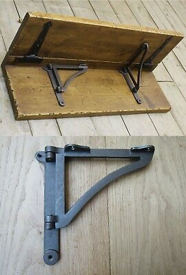

I wish to put a folding shelf on the passenger side forward barn door.
Hinging at the bottom is my best guess, about 18" X 18" or so.
I am hoping for suggestions on a set of struts to stop it at 90 degrees in the open position.
AND hold it rattle free in the closed, snugged up to the door mode of normal transport.
Any ideas?

There’s also spring loaded drop leaf supports -
And swing out brackets -
Might come down to which rattles less on long drives.

The swingout brackets look perfect.
I follow the "materials on hand" construction manual when possible.
I am sure I can make them, and make them work.
Plus the shelf can now be hinged on top.
Sweet.
Thanks for the help.

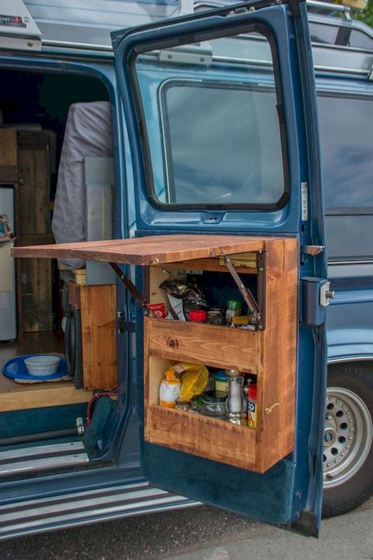

Ok, I see! I don't know why but i was thinking about a way to hold the side door open.
I agree the folding supports Tabijan posted look great. I have seen pics where some people make a similar folding support out of wood and use a hinge to hold the support to the door. Those metal ones would be much sturdier though.
I have seen some where you hinge the shelf to the door and use a small chain to keep it from folding past 90 degrees.
What are you using the shelf for?
I am thinking about a folding shelf but built into a small storage box mounted on the door. Perhaps to put my portable stove in when not in use.
That just upped the game! Nice door boxes. Got lots of scrap wood, lots of fasteners...

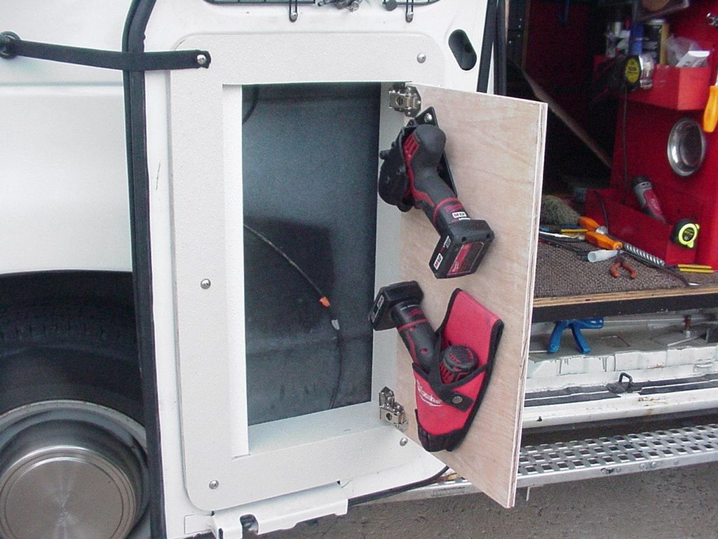

how are thoes attached to the door? just self tapping sheet metal screws, or is there a more reusable way to attach them?
Old Apr 3, 2022 | 05:10 AM
JWA's Avatar
JWA
Joined: Aug 2010
Posts: 21,253
Likes: 1,656
From: Reynoldsburg, Ohio
When I've done a similar addition I found and used as templates original Ford door panels that were attached with removable automotive clips. I'd replicate the OEM panels in plywood utilizing the matching holes in the panel and door shell. I'd then use Plus-Nuts in the door shell with 1/4"-20 truss head screws to hold the plywood panel to the door. That would look something like this:
This following image worked but was abandoned in a later design to gain more flexibility:
The design remains much the same in that each panel is held to the door shell with removable fasteners.
