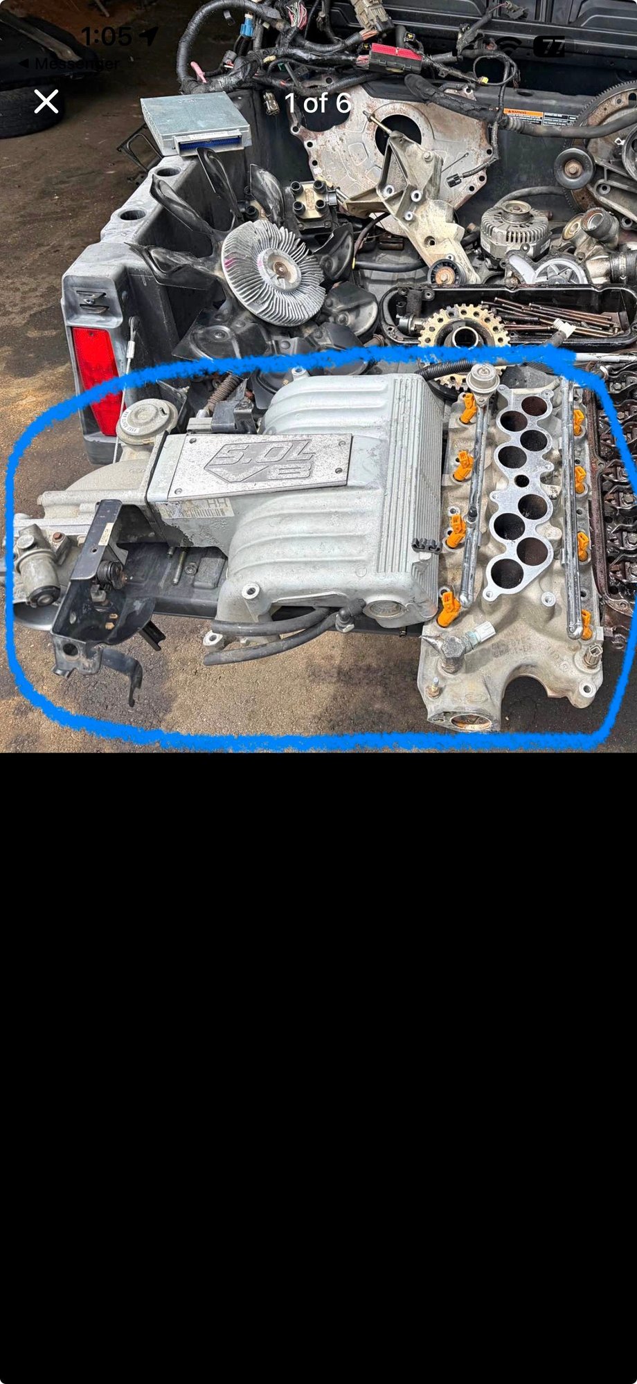

I am working on my 96 build. I have AFR 165 heads. I was porting my lower intake today to match the heads. Unfortunately the carbide bit slipped and put a health gouge in the mating surface of the intake. It is toast. I am looking around local for a lower and have found a few explorer upper and lower. I have tried everything including searching different forums for an efi 302 that has explorer/gt40 upper and lower intake to do some research. I know the stock truck intake produces the best low end torque but I have read the explorer provides better top end and still give decent low end torque. Here is what I am looking for. 1. For those who have made the swap, how did you route everything? I have ford performance valve covers. Will the explorer intake clear the taller covers? I have found a few that have the upper, lower, throttle body, and elbow. The air intake hose will have to be routed differently as well. Any advice? I am going to go to the JY on Tuesday to see if they have a stock lower. The photo is of one I found on marketplace but it is an explorer upper and lower

Heads alone won't be enough especially gt40. Gt40p would be better but you will run into header issues. I. picked up gt40 upper and lower intake. I can confirm they do NOT clear the valve covers. Not close. I will clean them up and resetl them. The seller through in the throttle body and ECU. I guess I will look for a stock lower and have it ported.
