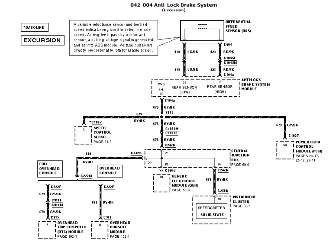

In addition to the advice offered above, I would offer the images and documents below which I found via a search. Are there any codes
Attached is the VSS (speedometer sensor on the differential) pinpoint test. You may not be able to accomplish each step, but they should give you an idea of what you are looking at/for.
The only diagrams I could find during my search were for a gasoline specified vehicle where the VSS is referred to as the DSS (differential speed sensor).

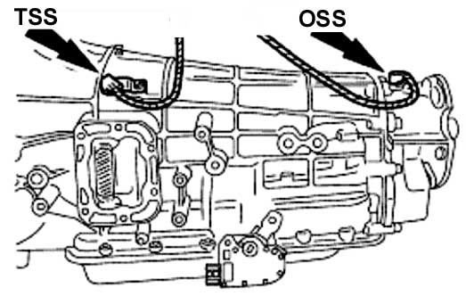

Although, some of the connectors and circuitry are identical across the gasoline and diesel trucks. So, the wire color code and junction/termination points may be the same as indicated in the diagrams above. As you can see, the DSS/VSS is tied directly into the ABS module, which you have a fault with in one way or another. In addition, there are speed sensors on the case of the 4R100 transmission that may be playing a part in your speedometer and odometer failures.
I hope the advice from the other FTE'rs and what I have written helps you out. If not, come back to us and we will take another swing at it.
