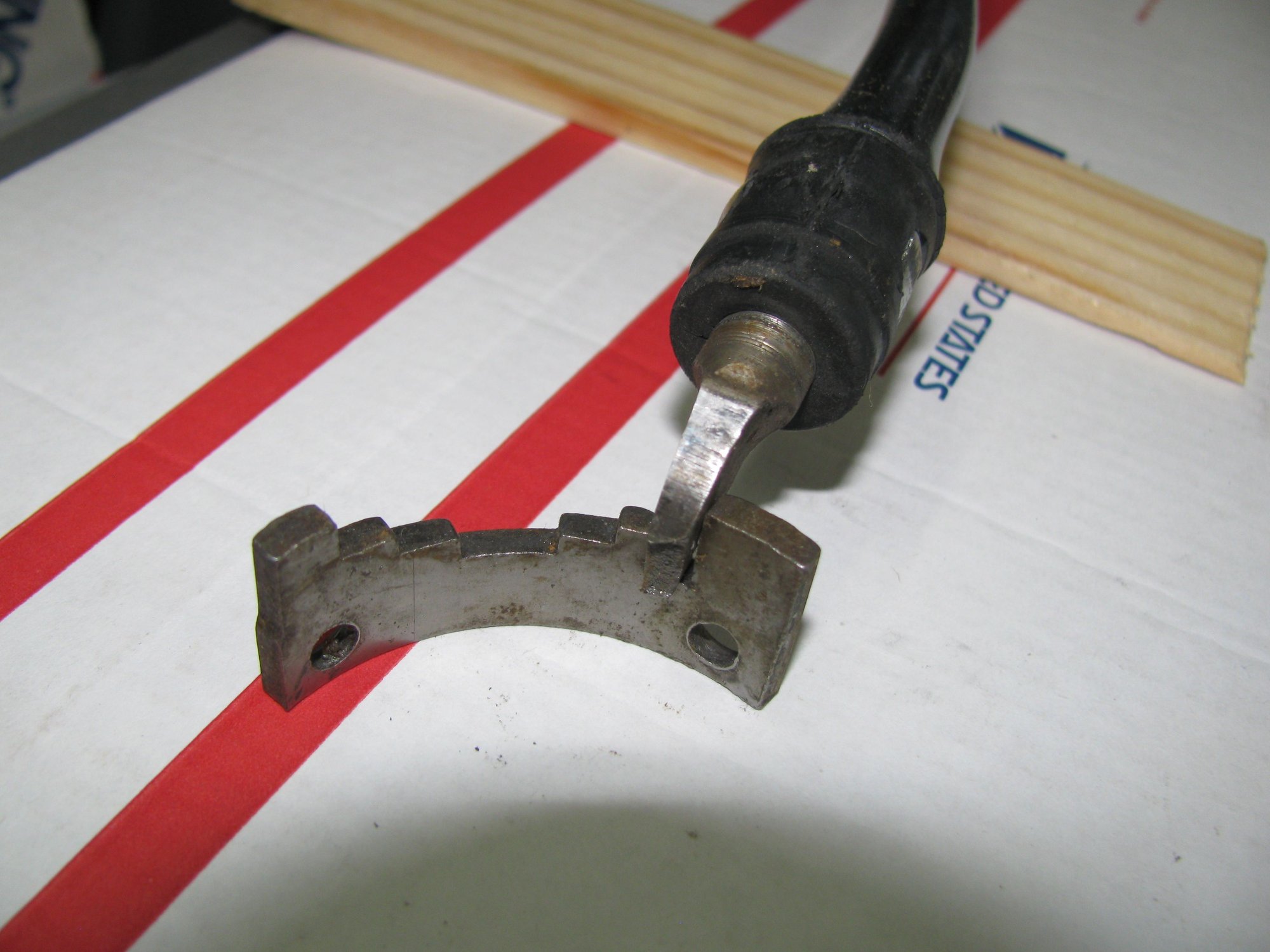

Ok so about 6:00 I’m working on the new Holley for the 66 f100 getting it dialed in truck runs great had the transmission in park I was Revving the engine and playing with the idle shifter fell out of park and went into reverse the truck proceeded to then mow down the 352 behind it sitting on a stand before crushing it against the tailgate and my shelf full of oil and parts followed by the truck dying so now the problem the shifter doesn’t lock into park if you tap it just slightly it falls right into reverse you don’t even have to pull it forward it will sit in park but any slight movement and she’s in reverse

Auto shifter
That is a no fun happening, glad you were not hurt.
Tell us what column and what transmission you have? Is it the original column and MX trans or something else that has been swapped in?
Here is a link to a thread with the parts page for a 65-72 auto column. Automatic Trans Steering Column - Ford Truck Enthusiasts Forums (ford-trucks.com)
These pics are 73-79 type but they all work the same. The spring in the column holds the shift lever in those detents. The part with the detents is different between one for a car and one for a truck in fact most of the ones I've seen for a truck had truck stamped into them.
Hopefully you just have a linkage adjustment problem because I suspect most of the repair parts are very hard to find.

These old trucks are notorious for that. Hopefully damage kept to a minimum.
Dealt with same issue myself. Shift detent plate worn or often the rubber bushing on the shift arm can be worn or just degraded. https://www.ford-trucks.com/forums/1...l#post17758143

it’s a 66 f100 factory automatic column with cruise o magic transmission

Go to the link AZSCAWPION put up. That will help you figure it out.
