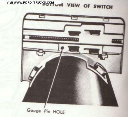

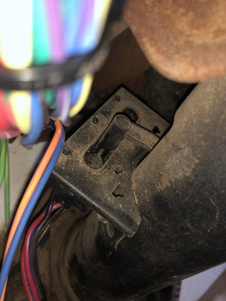

X2 on the 75 neutral safety switch is on the steering column under the dash. If you have to wiggle the shift lever then it starts, then sure sounds like the NSS needs adjusted. Be careful the 2 screws that hold the switch on the column tube are very short and can strip the holes VERY easily. I might have even seen a large hose clamp put on the switch (around the column and the L like tab of the switch mount bracket and hdwr) after adjustment to keep the short bolts tight and to help hold the switch in place.
X22 the dash instrument panel red BRAKE light is suppose to come on during initial start up to proof test the light. Just like stated above. And should go out about 8 sec like the seat belt warning light and buzzer (if you have that).
