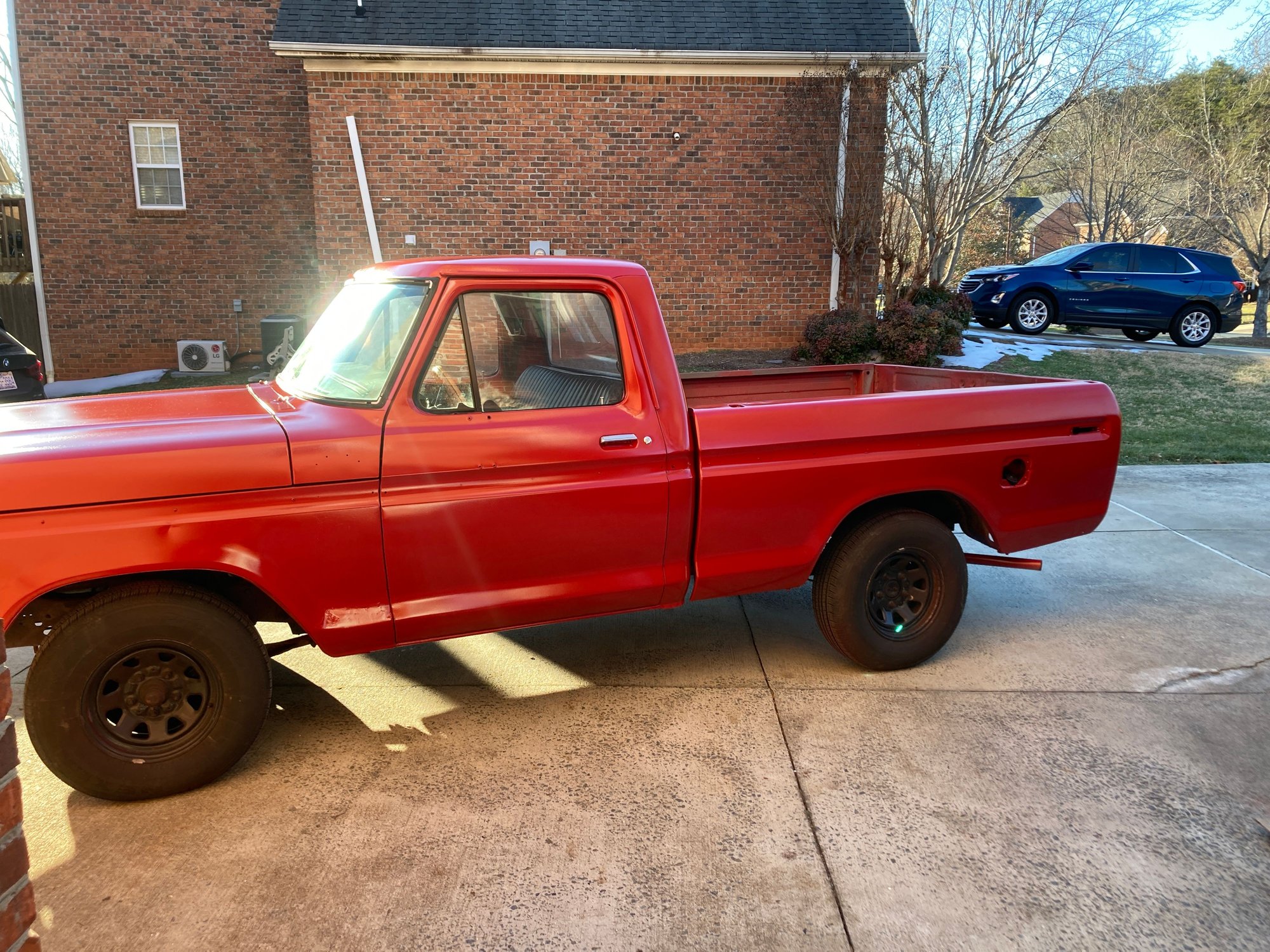

Here is the truck. Definitely orange peely, and I will start wet sanding on Sunday.

if its rustolium you might need to wait longer than that to let the paint get good and dry before wet sanding. gonna be a nice first car plus doing the work on it yourself you will appreciate it more
