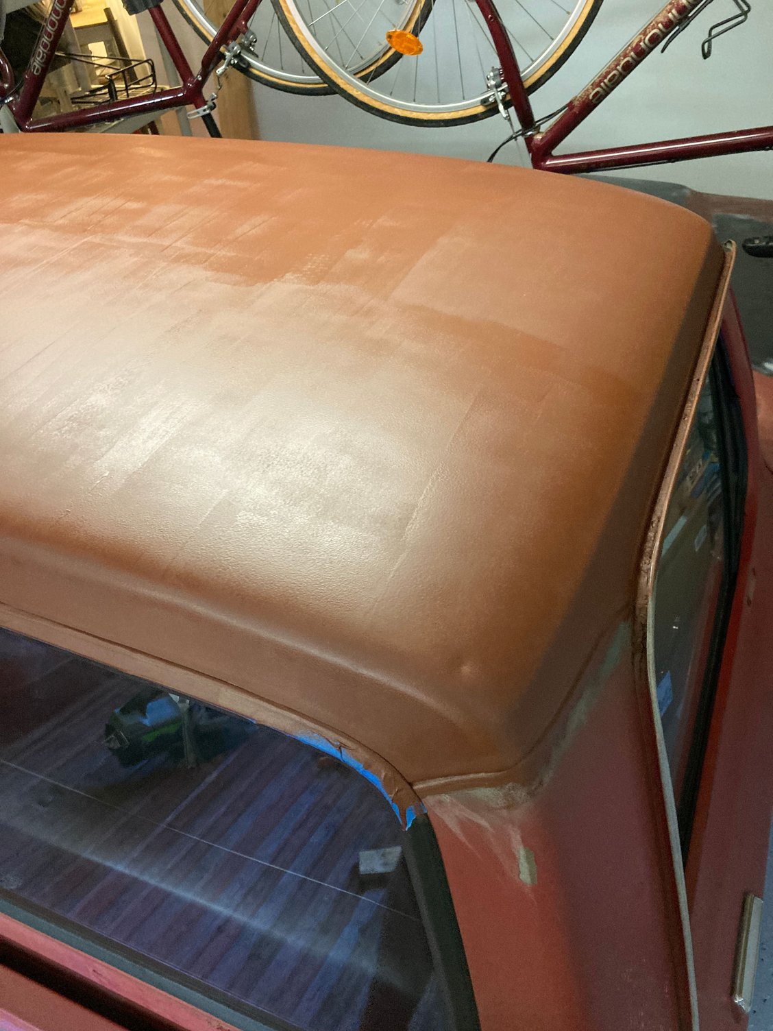

Progress update!
Originally I had wanted to fully coat primer the truck with the rattlecan Rustoleum Self Etching primer. However, the spray pattern on the cans is not very good, and its hard to get an even and thick coat. I had tried my best on the roof, but there were still thin spots where rust “leaked” through.
My new plan is to do a full coverage, but very thin, coat of the self etching so that I can still have the chemical bond to the metal. Then on top of it, do 2-3 coats of the brown Rustoleum Rusty Metal Primer. I will be rolling it on as well.
Earlier today I had sanded the S.E. primer with 400, wiped and cleaned it down, and then layed the first coat of brown primer. I bought a gallon of it, but for the first coat on the roof, it took 1/2 pint. To that 1/2 pint I added 1 capful of mineral spirits (the “capful” is the one that goes to the gallon sized mineral spirits. maybe 1.25 tbsp?). However, it didnt seem to flatten out as much. Maybe cause I wasnt painting in the shade? Anyway I moved the truck into the garage. Next coat I will try 2 capfulls.
As for the rest of the truck it is still the same. Still the upper portions of the bed are stripped, and after I finish the roof, ill try and strip one side of it. The only other thing I did was I put some Rustoleum black spray paint on the inside of the door panel( where it “connects” to the door frame/seal) because there was some bad surface rust.
(taken 20 mins after it was put on). You can see the roller marks, likely technique and not thin enough, but it will likely be covered up by the next coat or taken off by sanding
As always, thanks to those that have helped me along the way! Ive got much more of this paint prep work to do on the truck. You can expect another update tomorrow, but other than that I will post randomly/intermittently when I get to working on it.

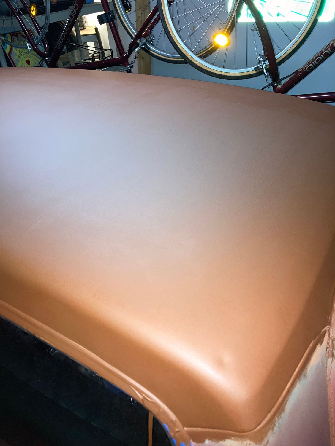

Update
The roof from the previous photo looked the same texture/imperfection wise 6 hours later. I then very lightly sanded/roughed the surface with 400, cleaned and put a second on. This time I used 3 capfuls of mineral spirits (i read on a thread that he used 4, so i skipped past trying 2 caps). It worked really well. I poured out 1/2 pint again, but the coat took only about 1/6 pint, due to the thinness of it. My technique was much better and smoother. It flattened out pretty well, but the only problem was a few runs on the vertical section above the rear window. Probably taking more time would help with it, but im still learning this process.
What Ive learned today is that;
You shouldnt have to push very hard at all on the roller for paint to come out. If it doesnt, then you need more paint on your roller. If you push hard you get the lines.
Always try to fix out the imperfections instead of assuming it will flatten out.
Finally, for the next panel I think I will do light coat of S.E., then two coats of 3 cap thinness of brown, then a thicker 1.5 cap brown top coat.
Looking better! You can still see the lines from the first coat, but this coat is starting to hide it. Minor orange peel from this coat, but I think most of the orange peel I am seeing is from the first coat. Will do the final coat tomorrow morning.

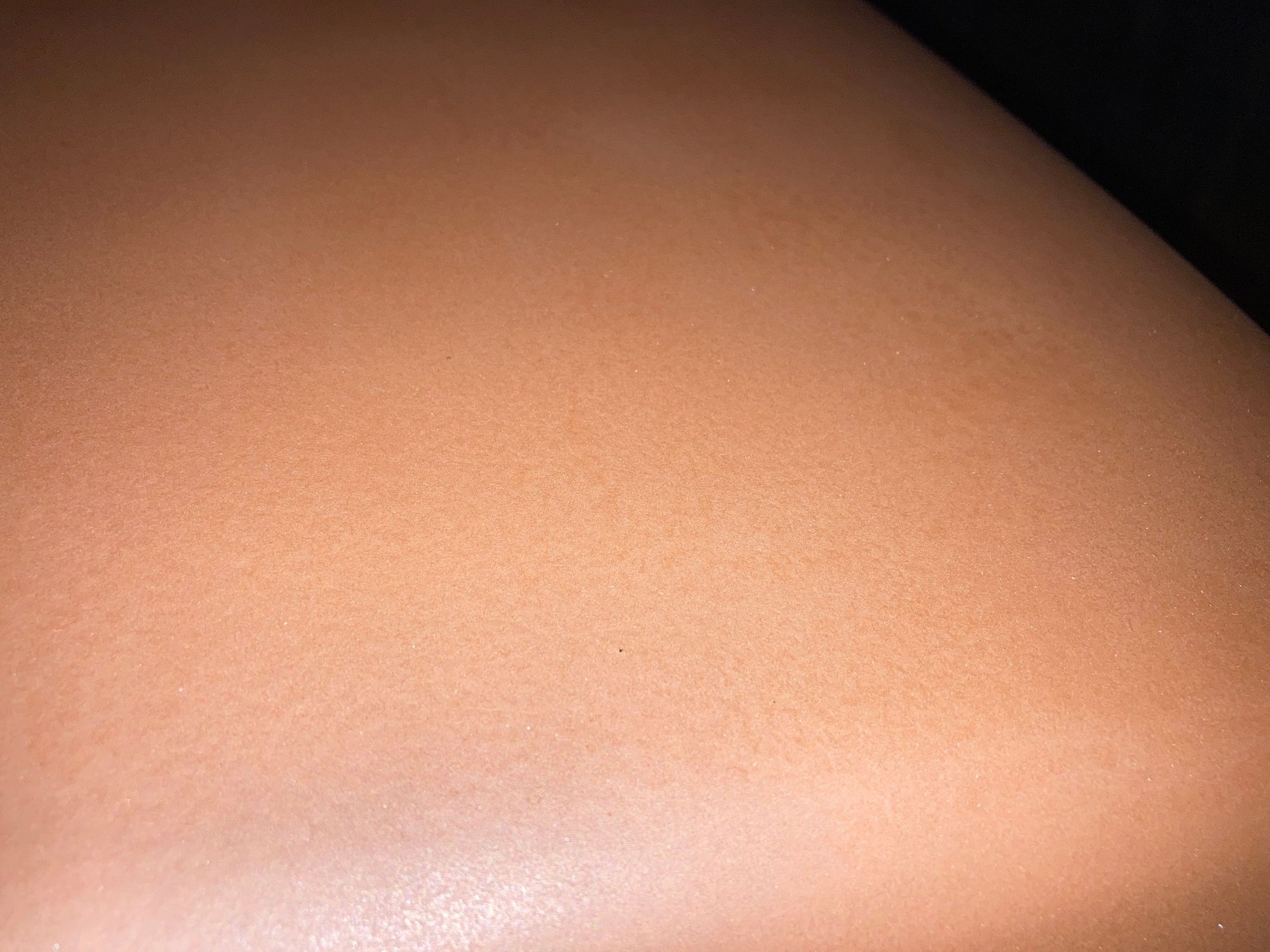

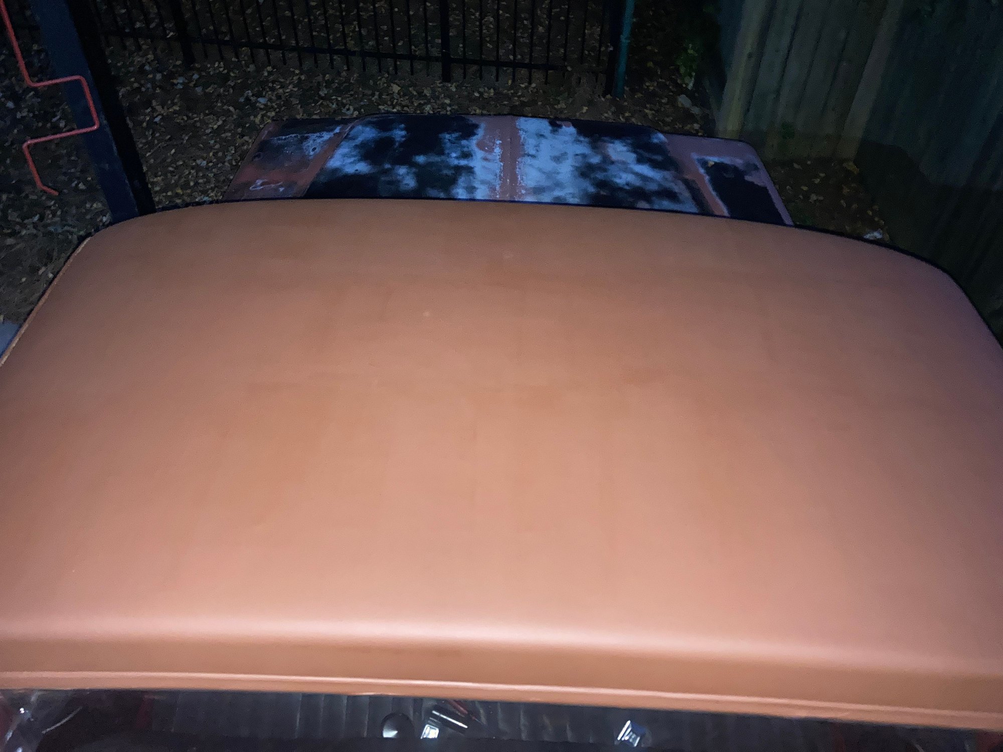

Third coat went on today, took only 1/4 pint. I used the 4 caps to 1/2 pint ratio and it worked well. Might use a teeny bit more when I get to the actual painting. I also stripped some today.
3rd coat fully dry

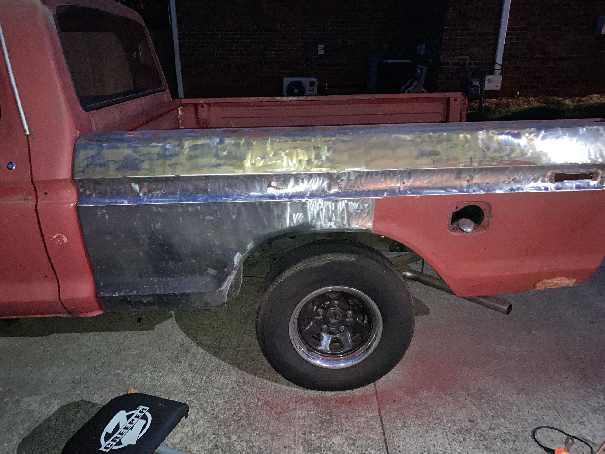

i stripped from the molding dent down tonight, this section took about 45 mins.
orange peel looks worse in person, but feels pretty flat. orange peel is definitely from the first coat

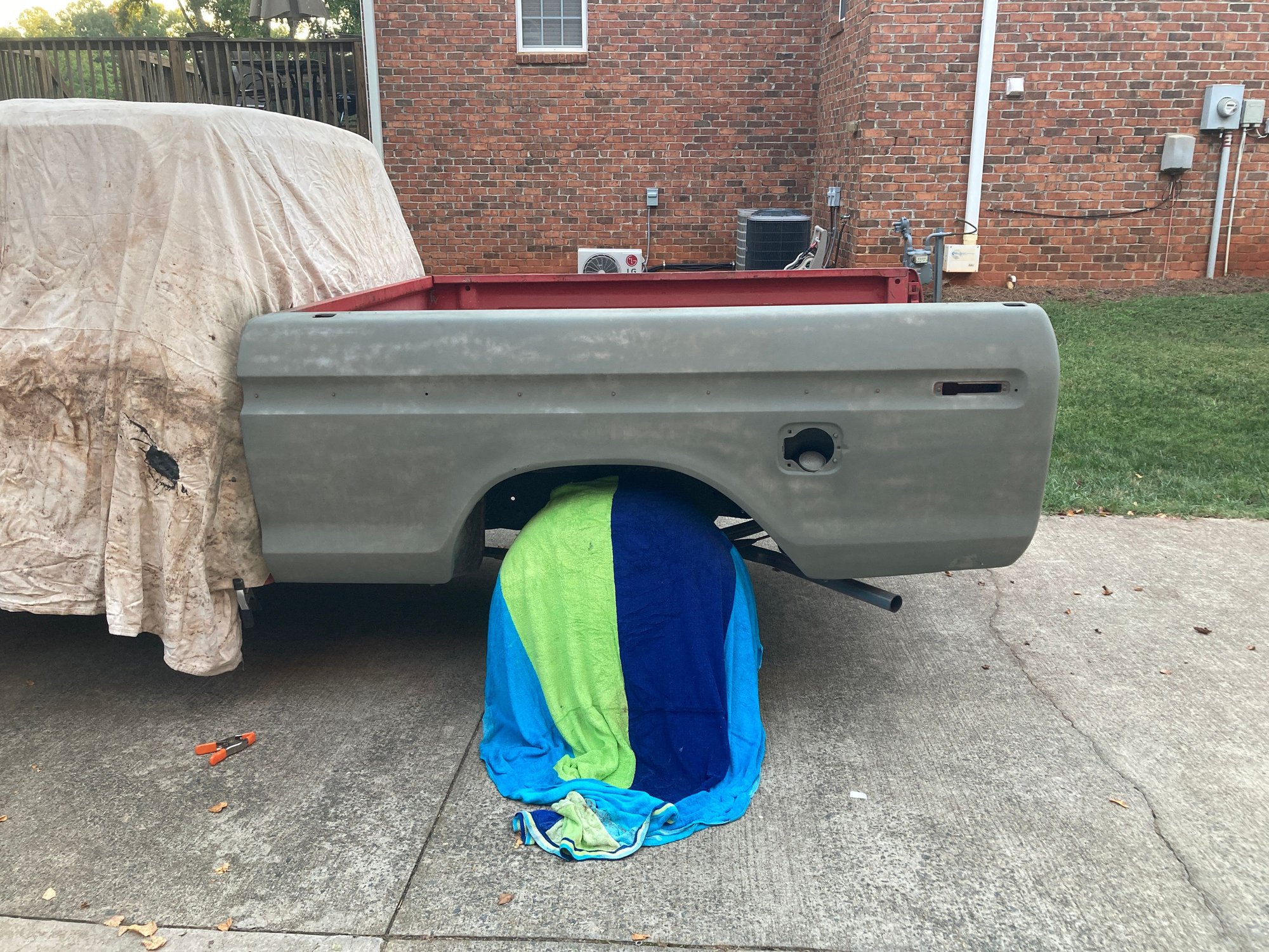

Light coat of SE went on
